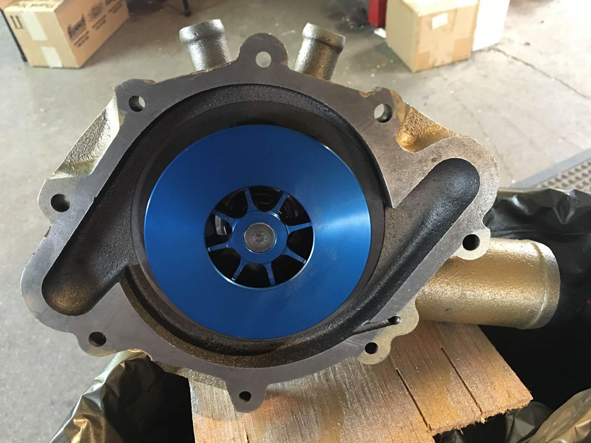

Old Sep 7, 2016 | 12:32 PM
  #54
distributorguy's Avatar
Joined: Jul 2016
Posts: 255
From: Minneapolis metro
Just to dispel myths about Flowkooler pumps, here's the new pump I just received (I painted it)

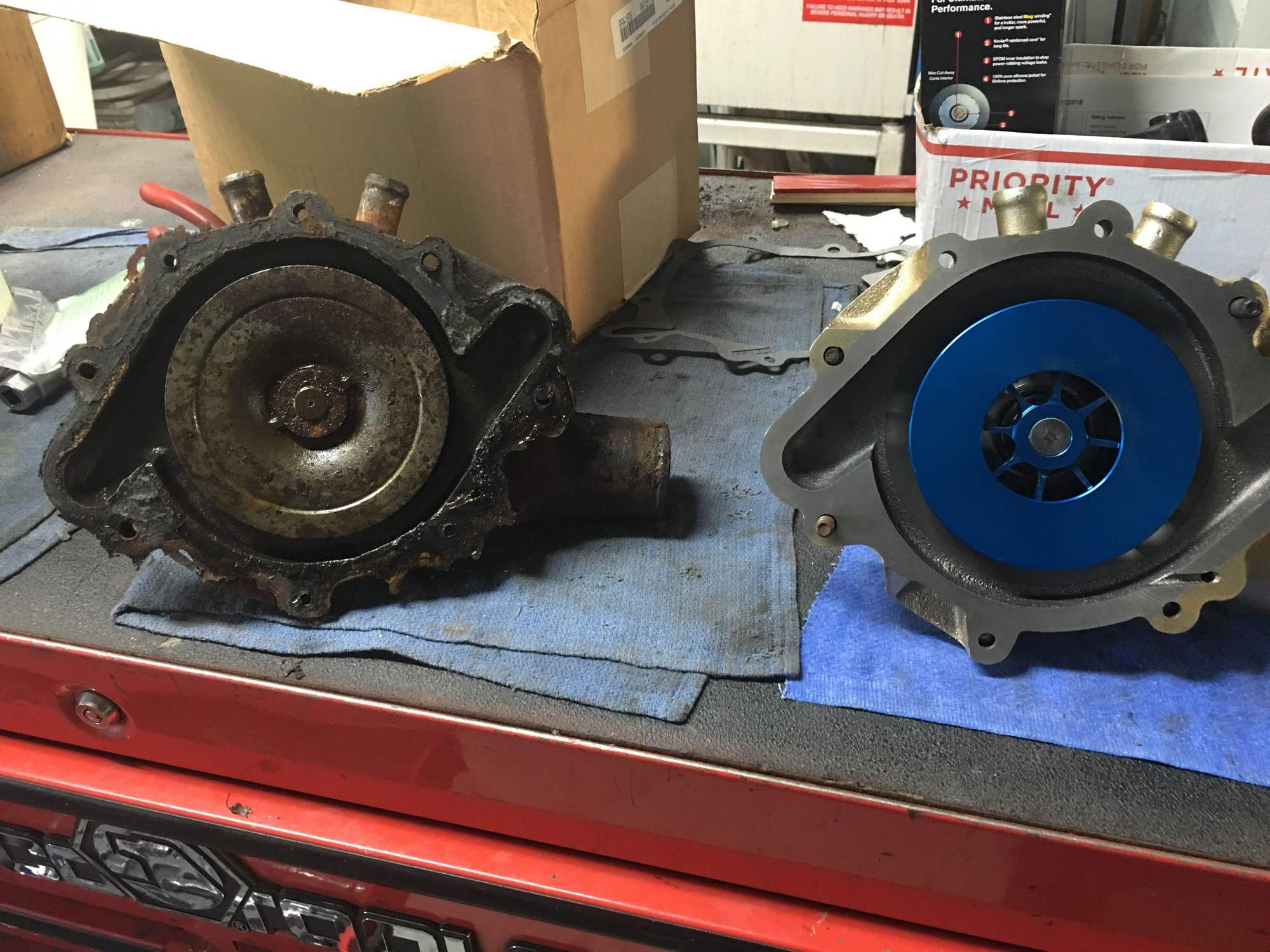

Old Sep 12, 2016 | 09:08 AM
  #55
Joined: Jul 2016
Posts: 255
Well, I'm not sure the new pump is better than the old one. It has a larger impeller, but likely not as efficient.
Due to a stat leak I ran out of time for a test drive last night, but I did install a new high flow 180 degree stat. It actually starts opening at 150. The 160 stat started opening at 160. I think the stat may have been a larger influence, despite being new.
It turns out my manifold wasn't milled properly and the larger OD stat actually contacted the side of the bore, not allowing it to sit flush in the stepped groove.
All this may be moot. I found out I have a "8" head on the driver's side, a "7" on the passenger side. Compression varies 14% bank to bank. I guess that explains the manifold leak I fixed, and possibly the heat. Who the hell would do such a thing???? I never even consider that stupid possibility. I have a line on a set of good "A" heads locally, and I have a Blockmaster in the shop to cut them down to spec. May as well pull the lump and go through it stem to stern, after I exhaust this cooling exercise.
Old Sep 12, 2016 | 03:16 PM
  #56
Joined: Jul 2016
Posts: 255
Maintained 175-182 at all times, until I got on the freeway. Back up to 195-210 depending on speed (65-80). Cools back down to stat temp when I get down to 55 mph. And at those speeds its still running rich at 13:1.
