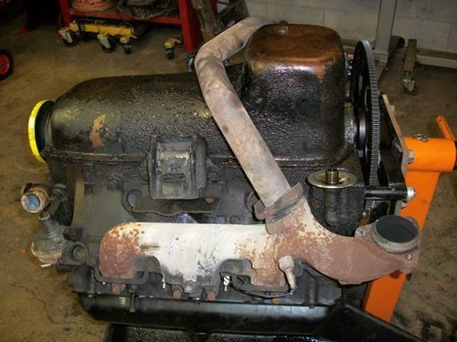

I am NOT sure about 65’s…
But later cars that had single exhaust had a cross over pipe like the one below.
its makes it harder to add dual exhaust.
You would have to find a block off plate for the manifold that has the 2 outlets.
Thorton sells manifolds that were meant to have dual exhaust.
OR you can get shorty headers which look easy to me.
Old Jul 9, 2024 | 06:49 PM
Posts: 15,432
There are options for that. The block off plates are available from the aftermarket. Or cut the crossover pipe near the flange, crimp it, and weld it closed. I’ve seen that many, many times over the years.
