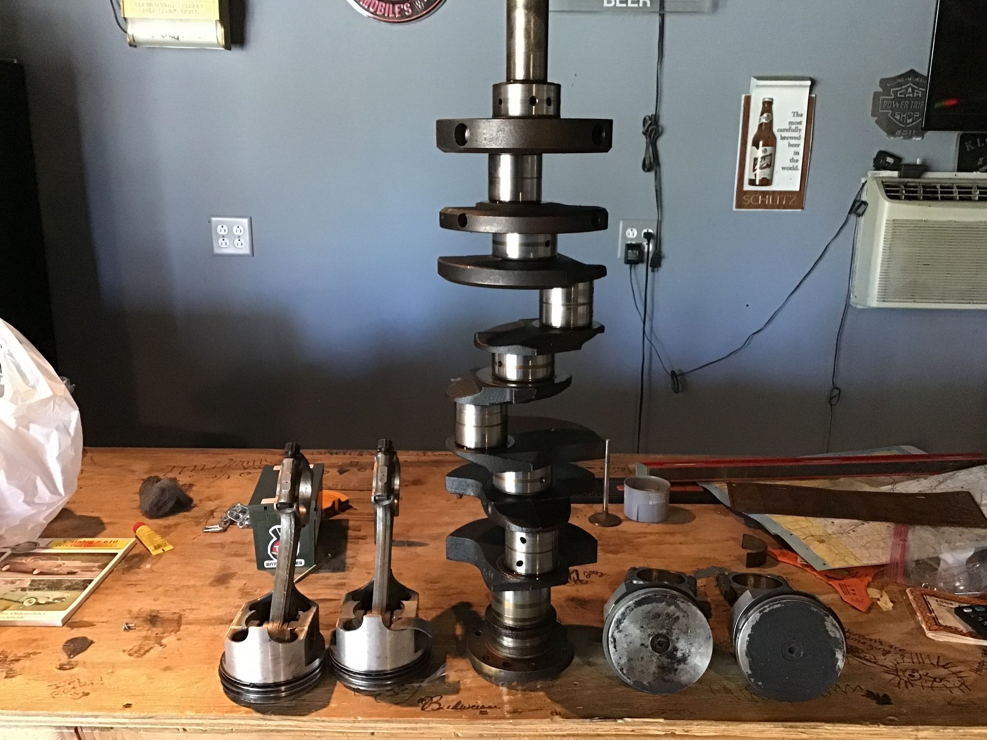

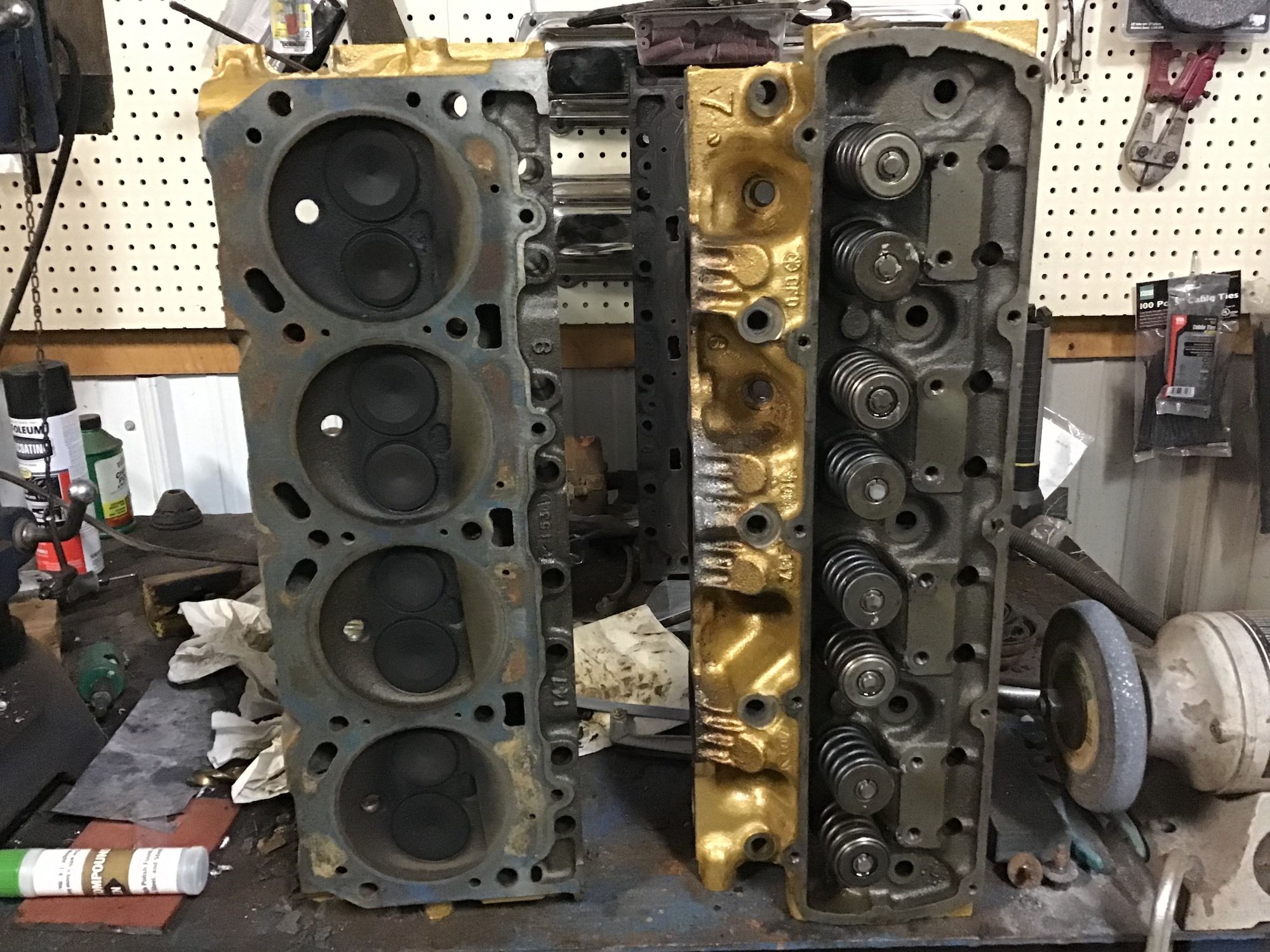

I have been collecting parts for a small block build for awhile now. I figured now is a good time to start a thread so i can ask questions along the way. The block is the original engine from my 72, it had a badly damaged cylinder so i had it sleeved and bored .030 over. I purchased a set of forged flat top TRW pistons from the classifieds along with roller tip rocker arms, timing chain and oil pump. Over the summer i picked up a running engine with a fresh set of heads from a local guy. I am dropping the crank off this week for a polish and to drill for the pilot bushing. The heads will be disassembled, home ported, and milled for screw in studs. I may also have them install bigger valves, i have not decided yet. As far as the cam goes i am undecided yet, I have a performer RPM intake and quick fuel 750 double pumper that will top it off. This engine will find its way into the 64 at some point in time.

If you are porting the heads, go with bigger valves.

Not sure how much hp you’re looking for but just put in 2.00/1.62’s and have the machine shop do a bowl cut. If you want to dress them from there then do so. Otherwise unless you’re an experienced head porter I’d leave them alone.

This will not be a max effort build, I’m saving the standard bore block for a build when the new heads come out. I’m just looking to clean up the bowls for better low lift flow. Once i figure out what the compression will be i can start looking at cams. This should be a fun engine with a 4 speed and 3:73 gears.

I assume the heads are early ones? If they are rebuilt, they are probably close to the 64cc number now. How much was removed from the deck to straighten it? You will be over 10 to 1 and may be around 10.5 to 1 if close to 0 deck. I would not go any smaller than that cam. I assume 93 octane is planned?

The @0.50 are 229/236. The heads are 1971 #7’s. Any recommendations on a good set of lifters?
