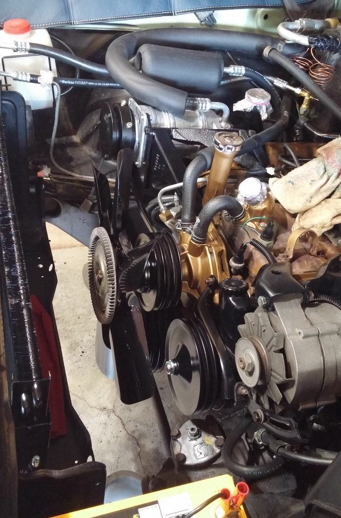

New Sanden-style compressor (Parts Place) and new lines from Classic Auto Air all installed. I've also replaced the old, beat up and non-original heater hose with a new molded hose from Fusick's. And while I had the valve cover off, I replaced the old grommet and the vent filter with new items (both from Fusick), and cleaned and repainted the steel connecting tube.
I've also installed the refurbished main pulley. No belts installed yet, though. I didn't need them yet, and they'd just be in my way. Before I installed the new heater hose, I did mask off and repaint the oil filler tube, which looks a whole lot better now. Somehow I managed to avoid any overspray onto the rest of the engine. Now I need to find a new 'QJ' decal for it somewhere.
The guys at Classic Auto Air were great to deal with, by the way, and the hoses themselves are first rate. Their hose set normally comes with a flat foam rubber sleeve on the muffler. I didn't care for that, so I also ordered an OEM style muffler sleeve with the hoses. They apparently read my mind, and installed the OEM-style sleeve onto the muffler before shipping, which saved me some (maybe a lot of) time and probably saved my neighbors from several new curse words they had never heard before.
The compressor came filled with PAG oil and labeled for R134a, but both The Parts Place and the manufacturer verified that it would be fine with R12 and mineral oil. I drained the oil from the compressor, refilled it with the same volume of Delco 575 refrigerant oil, drained it again, and then refilled it again. Actually I let it drain overnight each time to ensure that it was as empty as possible. The compressor originally had 5.5 oz. of oil in it, so that's what I put back in.
The compressor is made in China, but appeared to be manufactured with some care. The pulley rotated very smoothly and easily. Time will tell how it will hold up after the clutch is engaged. It does weigh about half of what the A6 weighs, and I have to say, it truly was a perfect-fit swap. Although all the bolts on it and supplied with it are metric, they fit the SAE holes in the Olds brackets without any issues. The only thing I had to go out and buy was a longer metric bolt for the clamp bar that holds the hoses onto the compressor.

So here it is, everything installed except for the belts and the new radiator. Before I set the condenser in place, I replaced the rubber spool condenser mounts, since the original ones were hard as stones.

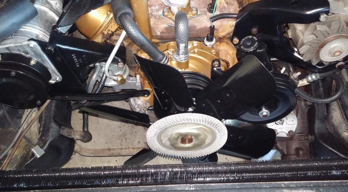

For some reason (probably my anxiousness to move along with this project), I didn't take any pictures of the new radiator... but it's a 4-row made by U.S. Radiator. The quality was very good, and it was very well-packaged for shipping and arrived with no damage at all. All of the dimensions I checked matched the old 2-row radiator (aside from the core thickness, of course) except for the height, which was about 1/2" taller.
I searched high and low for new radiator side and top seals before determining that they actually are just rubber cowl windlace, cut to appropriate lengths. The moment of truth was sliding the radiator into position with crossed fingers, and hoping that I'd attached those lower support brackets in the correct location. It was a very snug fit, and I had to lube the side seals to get the radiator to slide down into place.
As it turned out, my placement of those lower brackets could not have been any better. If I had placed them any more forward I'd have had clearance issues with the condenser. Any further back and the shroud would have required modification.
New rubber mounts and a new 4-row top plate from Fusick, and the radiator was in.

My old fan shroud was not in great shape and one of the bosses at the top (where the top plate fastens) was broken, so I ordered a new shroud from GM Parts Direct. I don't know if it's a genuine GM part or a reproduction, but the new one is a dead ringer for the old one. I did need to add shims between it and the top plate as the factory Assembly manual details. I bought a shroud installation kit (Fusick, I think) which came with new clinch nuts, shims, and bolts, all nice stuff.
I used 3M trim adhesive to install the bottom seal to the radiator before it was slid into place, and the same seal and adhesive on the top before installing the new top plate. That could not have been any easier or neater.
With the new cooling system all installed, I filled it with water, checked for leaks, and finding none, I decided it was time to fire the engine and see if it even still ran. The last time it ran was almost 11 months ago, after all...
