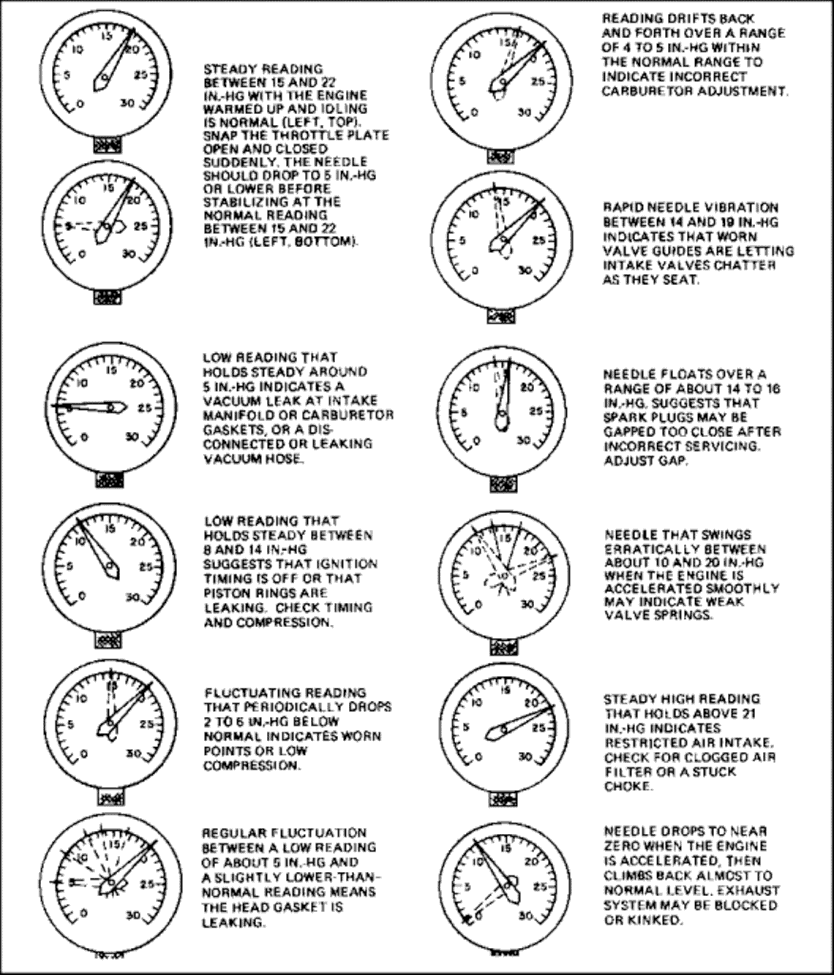

Sounds simple enough - don't mean to be trite - but, you have validated you have the vacuum hoses connected "correctly" i.e. to their proper manifold &/or ported connections? Sounds stupid maybe, but I've seen folks connect vacuum hoses to the top of the air horn which does nothing for A/F mixture. You still operating w/ the TVS switch & solenoid or has it been deleted?
Old Oct 3, 2023 | 09:35 PM
Posts: 25,793
Perform the 1st test (top LH corner) and evaluate your vacuum. Your vacuum should be rock steady. The needle should not waver at all (or whatever perm gauge you're using). If its a gauge, the reading should be identical to the test in this diagram - immediate drop to 5" and back up to 17".

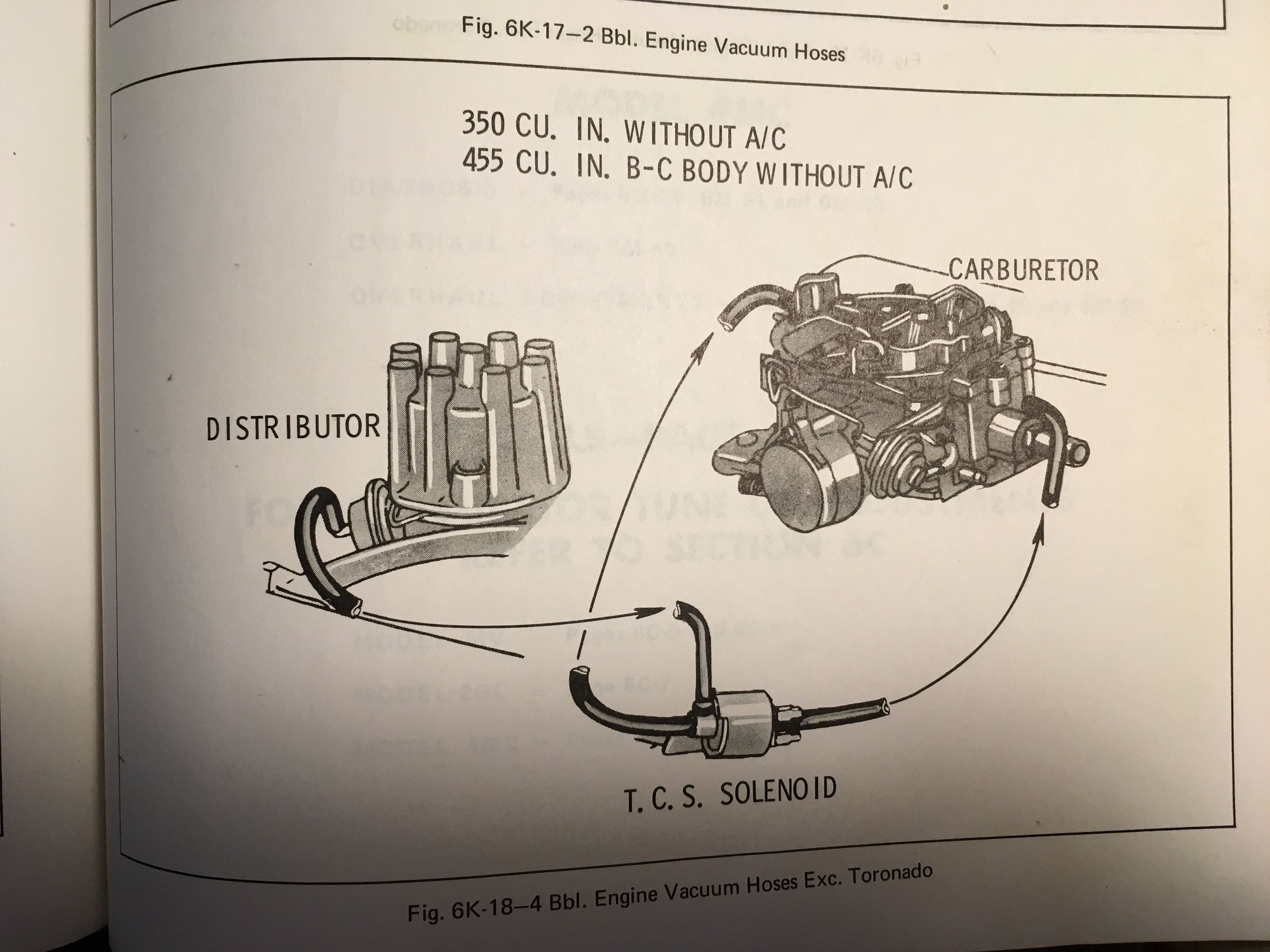

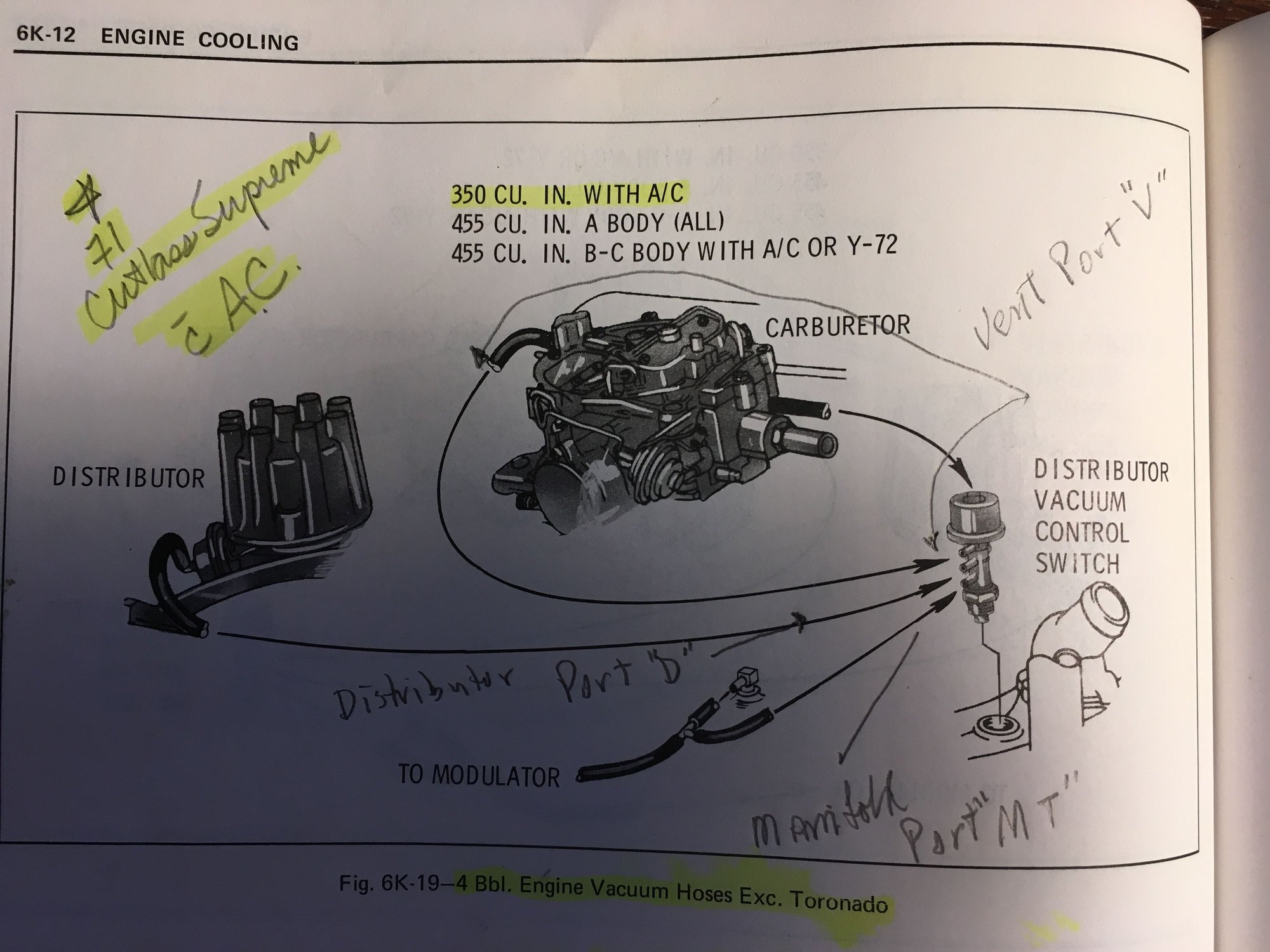

Question, on the front pass side of the intake manifold, there is some sort of "valve" about 2" tall, that has a 2 wire plug on the top of it and is "supposed to have" 1 vacuum line going to it. Any idea what it's for? hasn't been there for at least 30 years !
I think you're referring to the TCS, I called it the TVS in an earlier thread. Is that what you're referring to? I'll find a picture.
Old Oct 4, 2023 | 04:43 PM
  #35
Posts: 25,793
You have AC or no AC?
Old Oct 4, 2023 | 04:46 PM
  #36
Posts: 25,793
Old Oct 4, 2023 | 04:54 PM
  #37
Posts: 25,793
Here are some threads stolen verbatim from our site. Have a look...

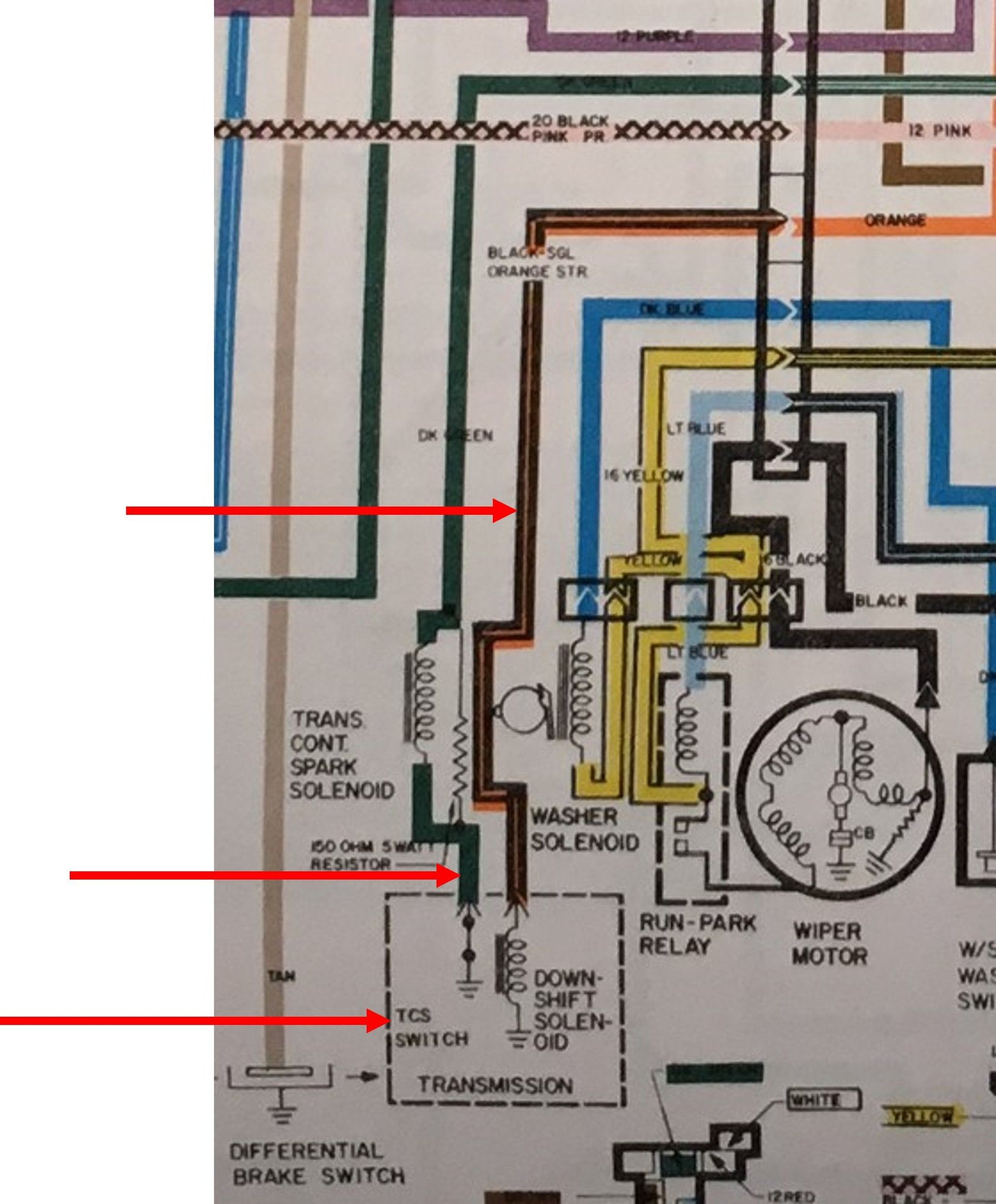

Transmission Controlled Spark (TCS) is referred to in the 1971 CSM as Distributor Vacuum Control Switch (same thing). The wiring diagram will illustrate the acronym TCS. Is this what you're referring to - based upon without AC or with AC. There are two wires which connect to the TCS solenoid - I think one is Black and one is Dk. Green - I'd have to look at the wiring diagram.

Posts: 25,793
One Dk. Green wire & one Black Wire with Single Orange Stripe
