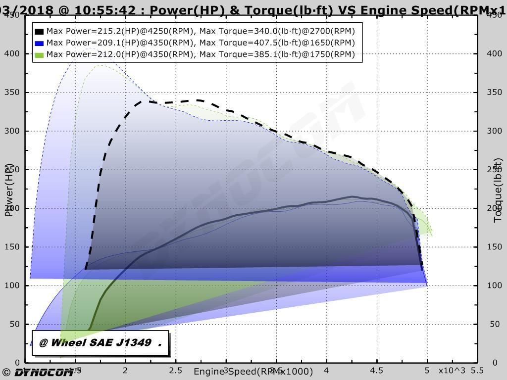

Did a quick set of pulls on a mobile dyno on Saturday, so I've got some baseline data for future improvements. 215 rear wheel horsepower and 340 lb-ft on a mild 330. Not too bad, but lots of room for improvement.
Disclaimer: Run 1 was good, but Run 2 and 3 were bad because I punched it too early, and my torque converter skewed the data a bit, but if you look in the upper RPMs, it's pretty accurate even on runs 2 and 3.

Engine data:
- 330 bored .020 over, Egge high compression pistons, a little short on compression height, but block decked .010. Haven't measured actual compression or deck height, but builder calculated 10.4 to 1.
- Running 93 octane with 35 degrees total timing. Recurved HEI with 13 degrees initial and 35 degrees all-in at 2500 rpm. 10 degrees of vacuum advance.
- Stock #4 heads with stock valves, no porting but three angle valve job
- 1.75" full length headers, 3" collector with 18" extension, transitions into 2.5" dual exhaust, no h-pipe, exiting underneath before the rear end, cheap Thrush Turbo mufflers (replaced Flowmaster 40s after getting fix-it ticket from the police)
- Th400, 3.90 rear with 28.5" tires. 3333 rpm at 70 mph. Hit 115 MPH on this dyno run in 3rd gear (1 to 1). Should have seen 5,250 RPM, so converter must be slipping a little. Hughes 2,500 stall converter.
- and most importantly -> Comp Cams 265DEH cam with 211/221 duration at .050, 110 split
Aside from dropping in a 455 or turbo/supercharger, where should I focus my efforts? Any and all feedback would be much appreciated It's fun to drive, but I think there's more

- stock 330 cast iron 4-barrel intake
- 1977 Quadrajet running 12 to 1 AFR at WOT (per AEM wideband). Secondaries opening fully, no air cleaner during these dyno runs
- Fuel was at 12 to 1 throughout the RPM range, so not leaning out
- HEI seems to be struggling and will sometimes miss fire above 5,000 RPM, but ran okay during these pulls, no miss fires.

Upgrade to a 14005 Accel Super coil and the ignitor 3 HEI or MSD HEI module. A Performer RPM intake with the divider notched may help. The stock valve heads and small cam limit hp but very good torque numbers. That equals 270 hp, which isn't bad for what it is.

I’m a forced induction fanatic, but with your high compression ratio, you don’t want to go turbo/supercharger on this one. With any make of high performance engine just remember this: power is in the HEADS. If it were me, I would rework the heads/carb/intake to be the best possible match. That doesn’t always mean swapping everything, just tweaking this or that..... Since you are running dual exhaust and headers with a wideband, I think it’s begging for more on the intake side of things. Cam and rocker swap might be in your future depending on how far you are willing to go. The other reason not to go BOOST is you will always want more. It is super addictive. You’ll be a junkie in no time and your wife and wallet will thank you.

12.0:1 is too fat. 12.5-12.8 seems to be the sweet spot more often than not.
And get a better module for the HEI. That's most likely your problem there.

Upgrading the HEI looks like the #1 priority. I see the torque declining as RPMs increase, so maybe that will help stretch the torque curve a little bit. It feels really weak above 5,000 rpm which might be the cam combo, but it would be good to eliminate any HEI weakness from the equation.
#2 -> Leaning up the secondaries to move the AFR higher. My primary jets are 68 with Cliff Ruggles' progressive rods, and I'm seeing 14.5 - 15.0 at cruise, so that's looking good. With higher compression, I'm keeping it a little on the rich side, but at WOT, I can definitely make that leaner than 12.0 (while keeping an eye on the spark plugs).
#3 -> I'm going to double-check my distributor timing. I don't trust my cheapo tach and want to be sure that I'm getting a good curve. A crappy timing curve could really hurt the torque, too, so that makes sense.
With regards to stall converter, I'm seeing it flash at about 2,200 RPM. It's a heavy car with me in it, which drags it higher, but I've got 3.90 gears in the rear that make it flash lower. More torque would move it into the 2,500 range. Anyway, lesson learned -> on the dyno, accelerate to 2.5k then punch it. Those torque numbers on runs 2 and 3 are bogus, so don't trust those.

When I rebuilt the carb, I modified the secondary throttle plates to ensure a full 90 degree opening, and these are opening completely when I step on the throttle. On the other hand, the air valve seems to be too tight. I loosened in last night and took a test drive, and that improved things, but I still get a consistent misfire at 5,000 rpm, pointing to a weakness in my HEI.
Next steps -
* confirming that mechanical timing is 'all-in' at 3,400 rpm and not drifting higher as rpms increase. I checked this a couple of years ago, but going to check again.
* checking for full voltage on the Batt wire at 5000 rpm
* replacing my engine block ground strap
* if that doesn't help, upgrade the module and coil
If I can cure that 5,000+ rpm misfire, I will look again at the secondary rods
Thanks!

Thanks TripDeuces, good point. My air valve is opening, but just barely above 4,000 rpm, then the ignition begins to stutter, so I can't see it opening more than 20-30 degrees. I'm guessing a partial opening of the air valve is a good thing, I'll make sure it doesn't swing a full 90 either way
I cleaned up the engine ground strap and retested, and it was still stuttering above 4,500. I also wired the Batt connection directly to the battery, but that didn't help, so I ordered an HEI upgrade kit from Pertronix (coil, module, cap, rotor, etc...).

Regarding the high torque numbers on runs 2 & 3, my Hughes torque converter is loading up for those pulls, so they look artificially high (in terms of engine torque). However, that is a good illustration of how a converter can multiply torque. I can definitely feel the extra torque when I launch. I am sure that true engine torque is actually a bit lower at those RPMs.

Pulled the heads -> mystery solved
Hey Guys, no worries, thanks for all the comments, I appreciate the help! I agree that my cam choice isn't the best, but here's what I discovered:
1.) My static compression was lower than I realized -> 9.3 (vs. 10.4)
a.) I cc'd my combustion chambers at 64 cc which is higher than the purported 58 cc on #4 heads. Maybe my 3-angle valve job dropped the valves deeper? Probably not enough to add 6 cc, so just shows that all #4 heads are not 58 cc.
b.) The compression height with the Egge pistons was deeper in the hole than I realized. I took off the heads and measured it myself, it was 15 thou deeper (measured 30 thou in the hole), with a 40 thou gasket that makes a 70 thou quench height, not sure that matters with open chamber and dished pistons, but it does impact compression. I had heard that Egge lowers the compression height as a safety measure for blocks that have been decked during a rebuild -> well I can confirm that this rumor is true.
c.) The Egge High Compression piston has a 4.9 cc dish (measured it with clay and a graduated cylinder), so that was good to go.
2.) My valve springs were installed a little on the loose side in terms of seat pressure and needed a valve shim to increase the seat pressure. This had a pretty significant impact on my max RPM. I am guessing that my engine builder was doing me a favor during break-in, but either he forgot to mention it or I forgot to remember it. Either way, there were no shims under the Comp Cam springs. It was stuttering at 4700 rpm with the loose setup, but after adding a 60 thou shim, it increased to 5300 rpm before stuttering (valve float). I didn't measure seat pressure with a valve spring compression gauge, but I imagine that I could add another shim and get some higher RPMs, but it may be a while before I pull the heads again.
The 265DEH drives pretty good, it's been fun around town with the increased valve seat pressure, but open to suggestions (thanks!)
