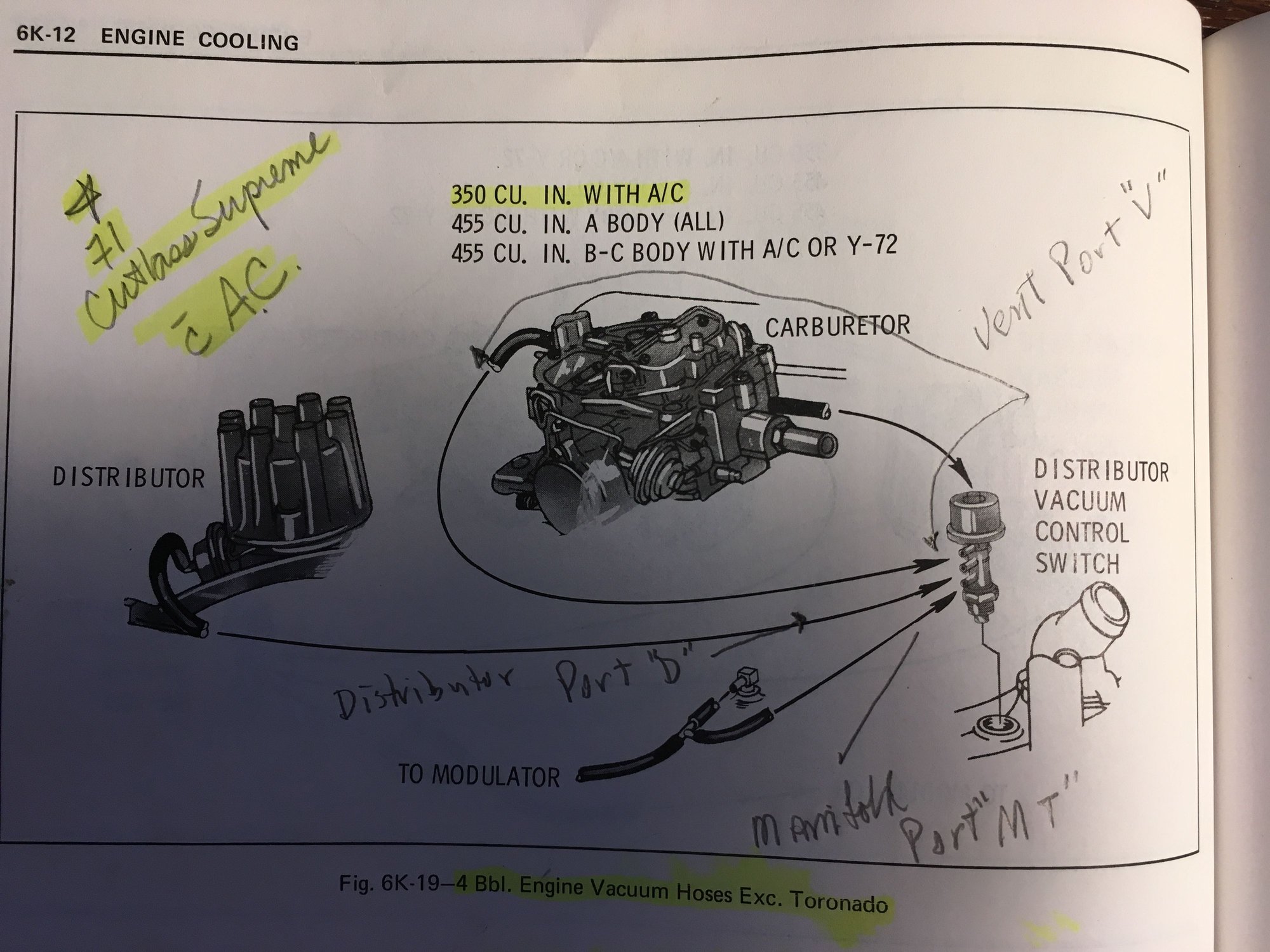

Old Aug 4, 2021 | 10:47 PM
Posts: 26,056
Old Aug 4, 2021 | 11:01 PM
Posts: 26,056
This vacuum routing is from the 1971 CSM. You have a 1973 Cutlass 350; therefore, your routing may be dissimilar - do not use the one I am providing as a reference for the correct routing. But I am providing it to you as a check & balance for you to establish and review in your own 1973 CSM whether you have the vacuum hoses routed appropriately for your so-called "thermo doohickey". Double-check your vacuum routing specifications.
