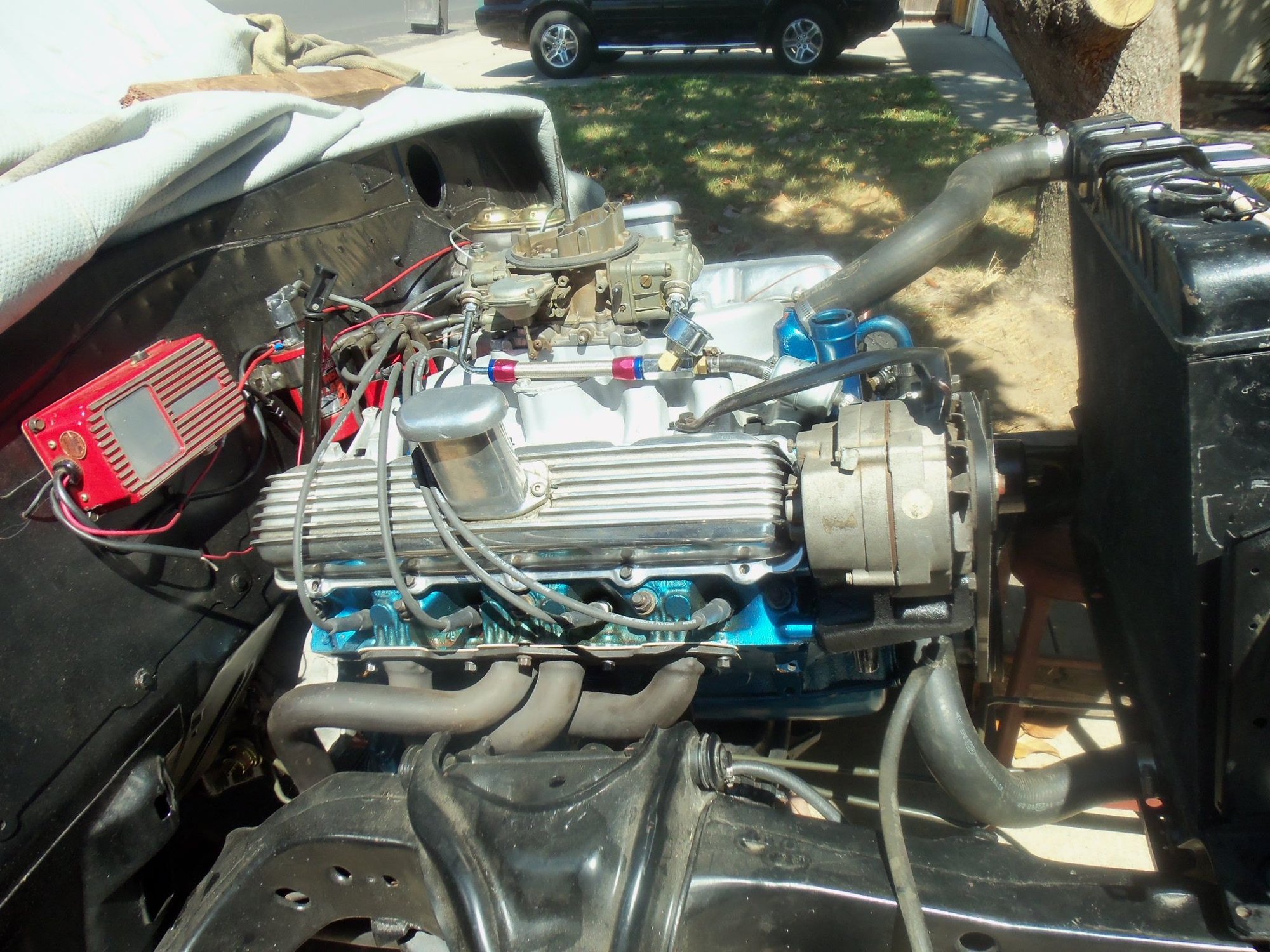

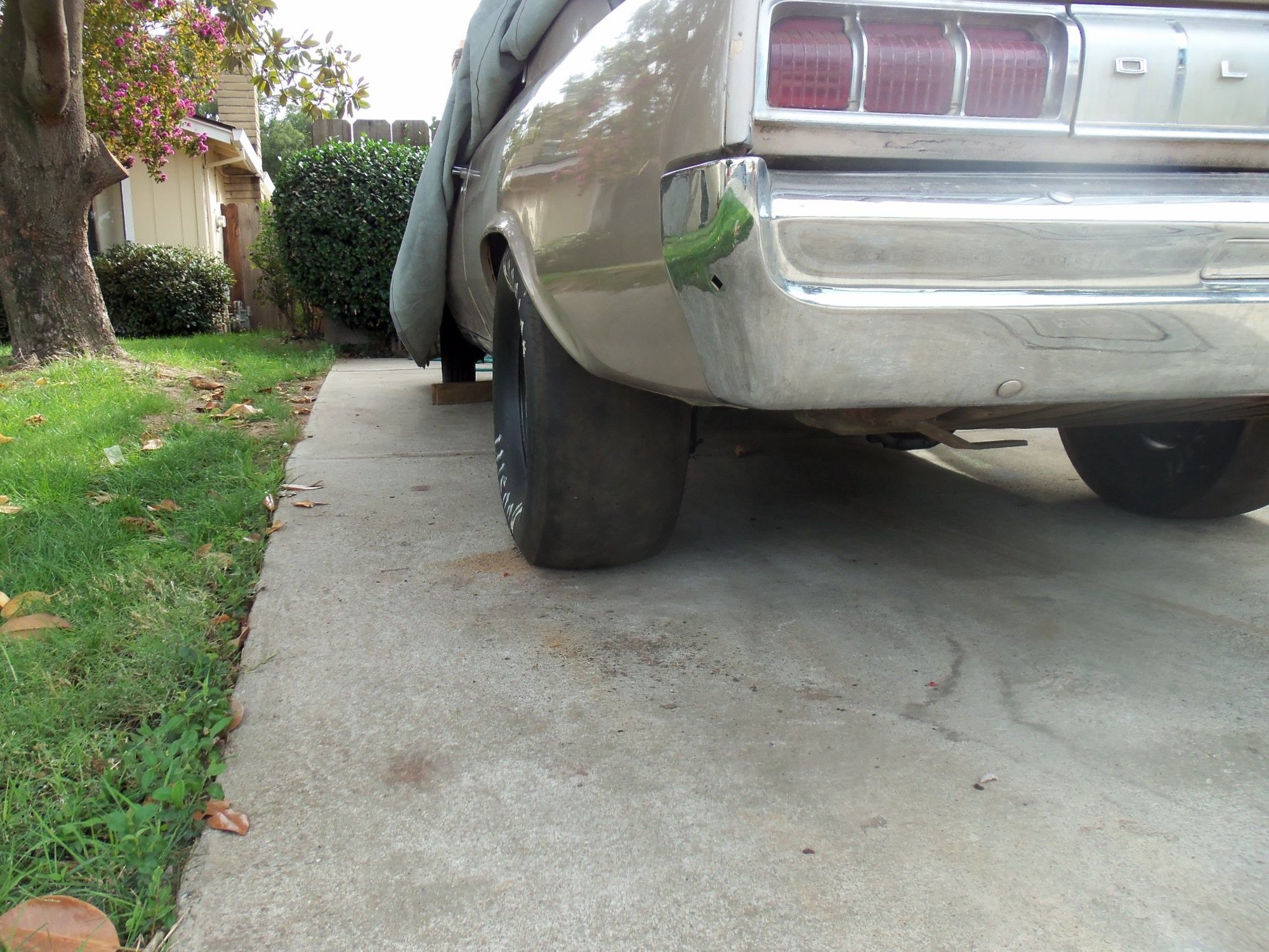

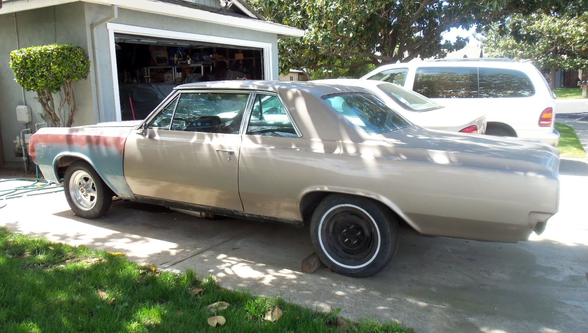

My 64 F-85 post ran 1/4 in 12.04 at 115 MPH.
4.33 rear end posi, 400 trans shift kit 350 T/Q, 455 engine Ga heads Torker intake 800 carb. cam was a Mega cam 292. Heads had the center ports welded up and exhaust filled in with zinc. With headers, slicks, no pipes.
Old Nov 18, 2020 | 06:30 PM
Gerald Nickels's Avatar
Joined: Apr 2011
Posts: 1,962
From: Nor Cal
I only ran it one weekend It would of ran 11 if I had a good Torque Convertor like 350 HD stall. I sold the body and traded the 68 4.33 rear end to a Canadian for his 3.42 I now have ready to go into my 65 Cutlass (442) clone and I save the 455 and 400 trans too.
