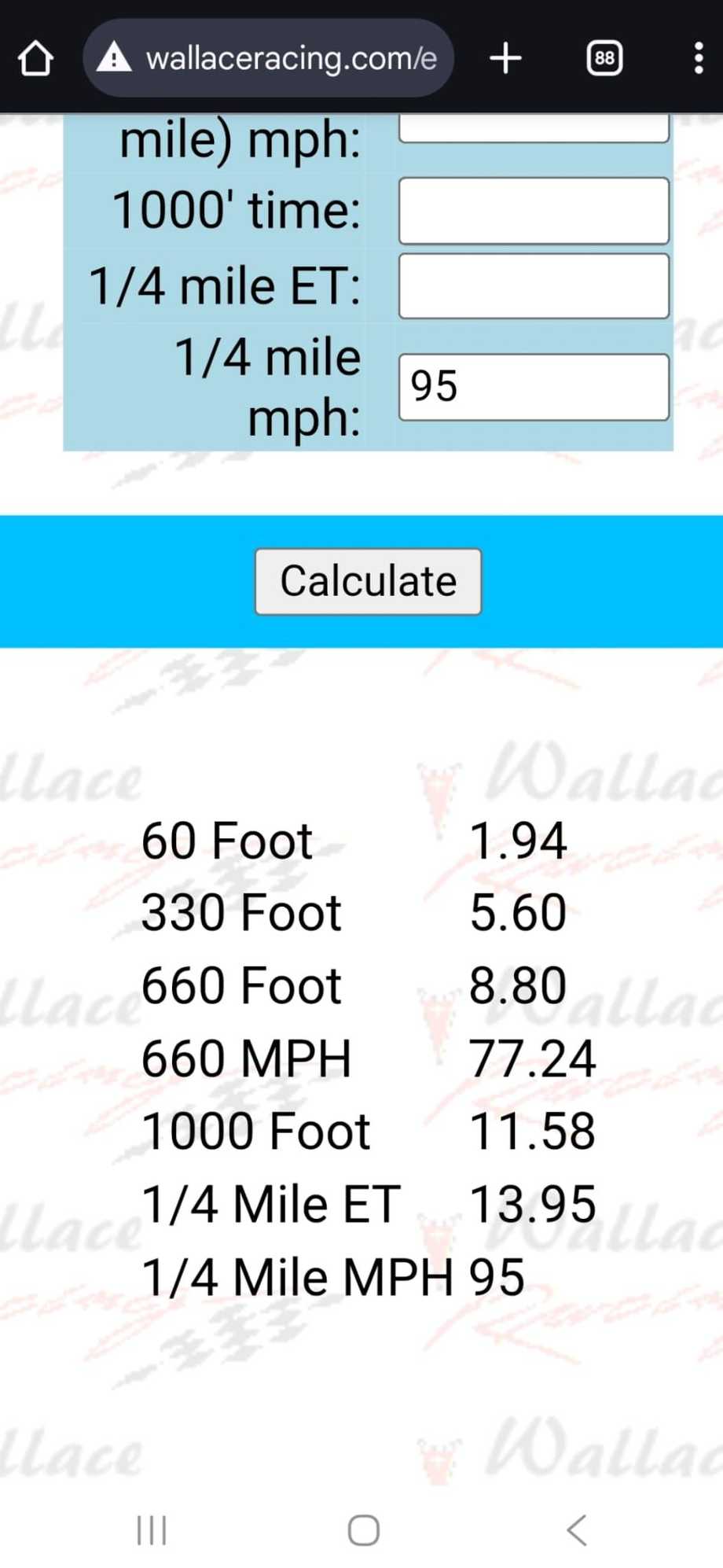

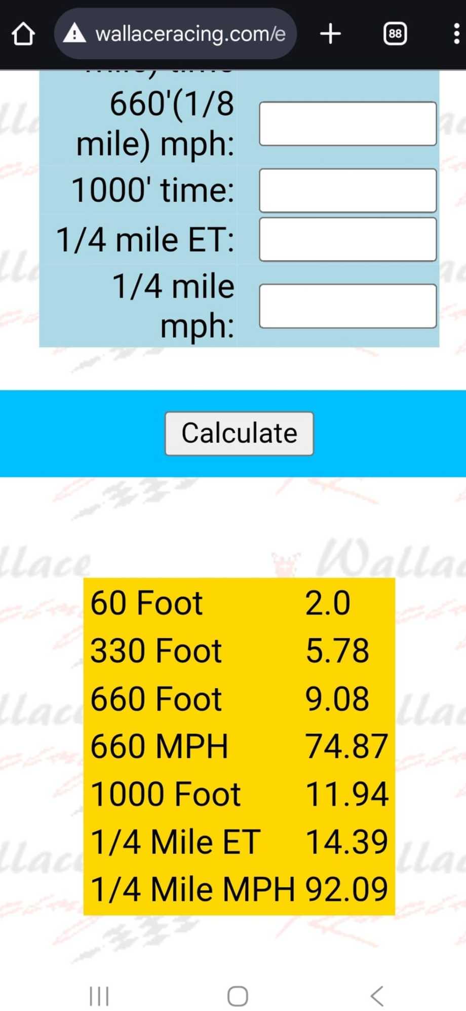

Around a 9.0 in the 1/8.
Here are idealized results for a 95 mph 1/4 mile.
And here are idealized results for a 2.0 60ft.
http://www.wallaceracing.com/Calculators.htm
Weight is not in play in this type of calculation.

If your trying to gauge performance based on weight, your ride is on par with an original 1987 Grand National.
Depending on options they weigh up to 3550 lbs curb.
Motor Trend saw 95.1 mph in the 1/4 mile, August 1987.
ET was 14.7 in the 1/4, so you can see the enormous difference between real world and a prepped track ideal.

Oh I see, I thought you hit 95 in the 1/4.
Your 60 ft is horrendous. With the right stall, tires, shifts, track, prep, weather, etc, could be 1.58
And if you're wondering how accurate that calculator can be. It can be very accurate. My peak performance in my 87 442 was close item for item after about 200 passes. Time slip to calculator.
