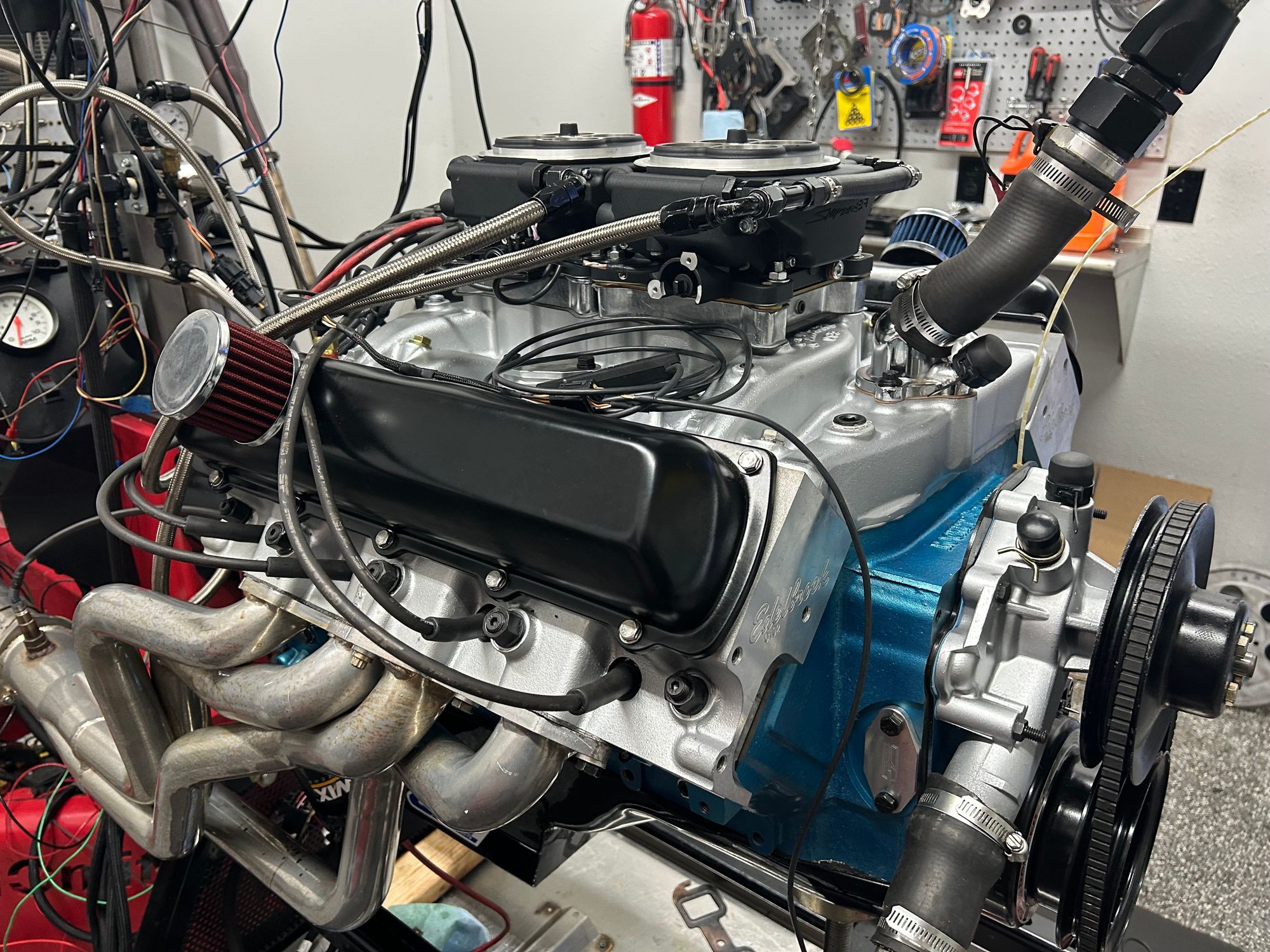

I’m doing two of these for a customer. This is the first of the two;
4.390 bore Racetec pistons
4.60 stroke Bryant billet crank
7.00” K1 rods
2x4 Sniper setup
Old Edelbrock low rise 2x4 intake
Ported Gen III Edelbrocks
9.8:1
238/246@.050 hyd roller
561hp/640tq
This intake isn’t the best, especially when it’s trying to feed 557ci. Good tq, not a lot of hp. Needs bigger headers too. BUT, the torque comes in early and strong. It’ll probably break a few driveline parts!!

At first I thought it was the first engine of two, for a boat. But I assume from the front drive that isn't the case? Can you share what the engine(s) are going into?
What do you think it would make with a more well suited intake and headers?
This one is going in an early 70’s A body.
A good victor with a 950 would make well over 600, it made 582 with an out of the box Victor and a 750 during break in.
But this is a relatively mild build, good not great heads and not a lot of cam for 557ci build.

Update;
No more Snipers as there isn’t support for those anymore.
Instead it got (2) 800 Cfm AVS 2 Edelbrocks and a Progression Ignition Dist.
Final numbers are 575hp/653tq. Actually I did a lower pull that made just shy of 660 at about 3000rpm. Dyno sheet to follow.
Note; any of you that still think you need an ignition box for a street or street/strip build of this power level are fooling yourselves. This is an electronic Dist, with a $50 coil. Didn’t miss a beat to nearly 6000 rpm.
And another myth busted, wait till you see the BSFC between these carbs and the Sniper. Some of you will be surprised, I wasn’t.

Interesting build. No more support for the Sniper? Is it because they Gen 1? How did you like the AVS2?
Yep, Sniper 1 is done.
Haven't used one of these carbs in a while. It was pretty good right out the box, but did need a rod and spring change.
I spent more time on the timing curve and valve lash instead of the carb. A welcome experience.
