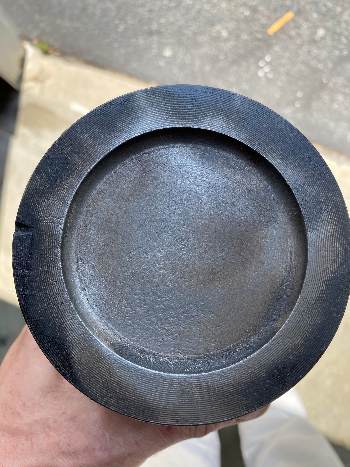

You may want to check the deck of your engine block adjacent to the cylinder that the broken piston came out of. If you'll notice in post #4 above, the piston has a "B" stamped in it at about the 4 0'clock position. This was done on Olds engines to denote the "relative size" of the piston. Pistons were made in A, B, C and D to accommodate minor differences in the machining of the blocks. It's a good idea to match the letter on the piston to the one on the block.
Only stamp I found on it was a F

the stamp is visible in your second picture C

I’ll half to clean the top to make sure but I sure don’t see a C on my piston
can see a B on the other picture

Ok I’ve cleaned the tops of 3 pistons and there is no stamp on the top the only stamp I have is the F for the front , part number and the GM date code
second pic is a different piston

the C is clearly visible at the bottom of the picture 45 degrees from the notch on the outside of the piston not in the dished area and I can still see it faintly after being cleaned ,it is still there

From: South Central Florida
If the tops of all of your pistons look like the ones that you have posted I would seriously consider a replacement set. They appear to have suffered from detonation. Can you post a pic of the broken area on the first piston? If it came out of the engine with pieces missing between the ring lands, then you definitely have a problem. Factory high compression pistons weren't made to run with today's low octane gasoline and have a tendency to self destruct.
there was a detonation problem
im putting this motor back together so I can drive my car
I’m building a 462 forge piston roller motor but want to drive the car in the mean time
the ring land was cracked and I dropped the piston and broke the side out

Originally Posted by billrob71
there was a detonation problem...I'm putting this motor back together so I can drive my car......
The good thing is with replacement (read thicker) head gaskets, your compression ratio will drop to a more tolerable level. Good Luck with your project.

Got a piston coming thank you
My question I’m staring at this piston I can not see a C on this piston , I’ve zoomed in on the picture
I can not see It
