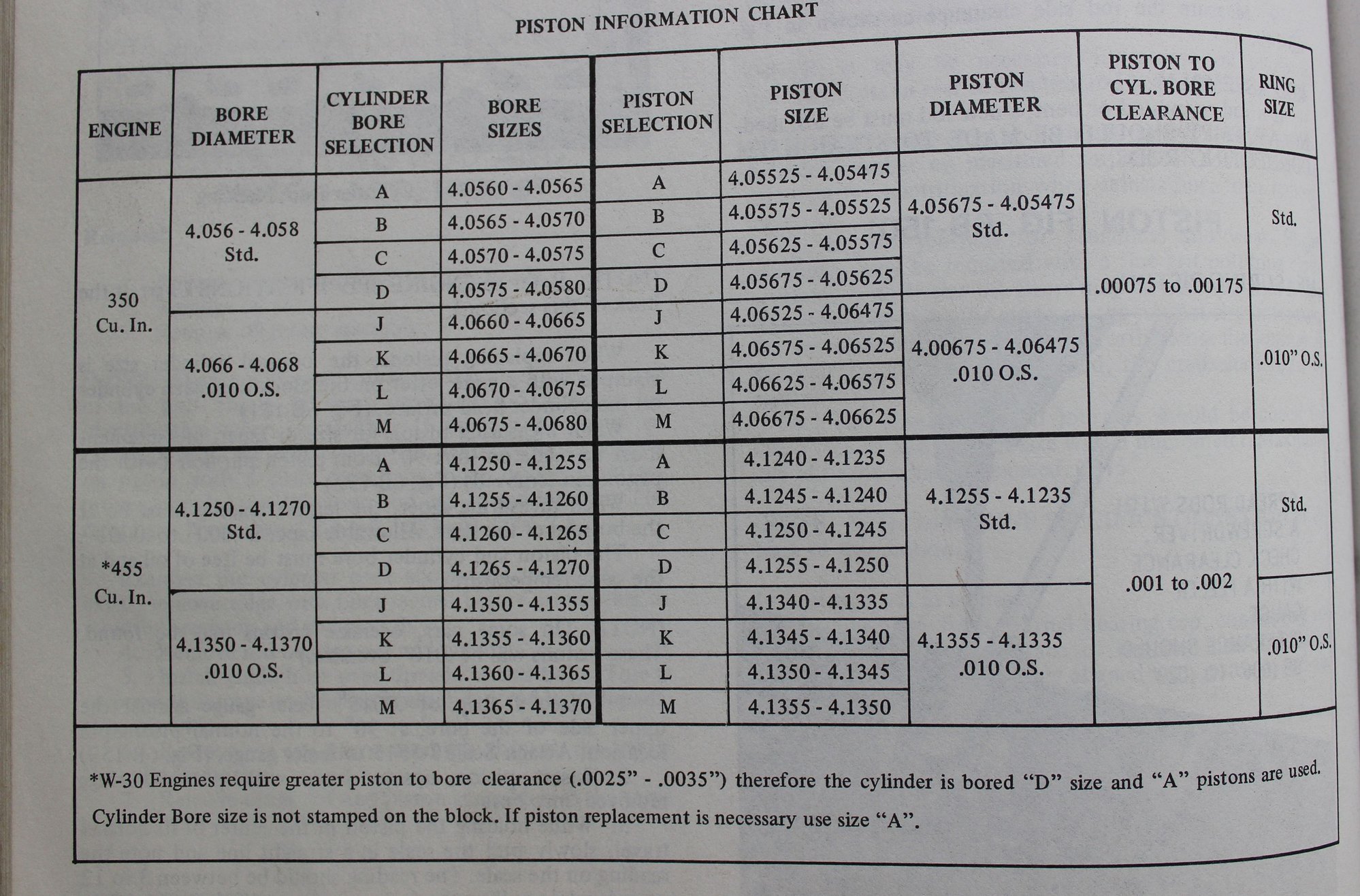

From the 1972 CSM. 73 is probably similar.

so did they measure the bore after cutting it and could there be multiple sizes on the same block? Only found one B on each side.
doesn't really matter since the block has been bored .030 over

I think they used the same mill on finishing all 8, so they would be the same, nominally.
