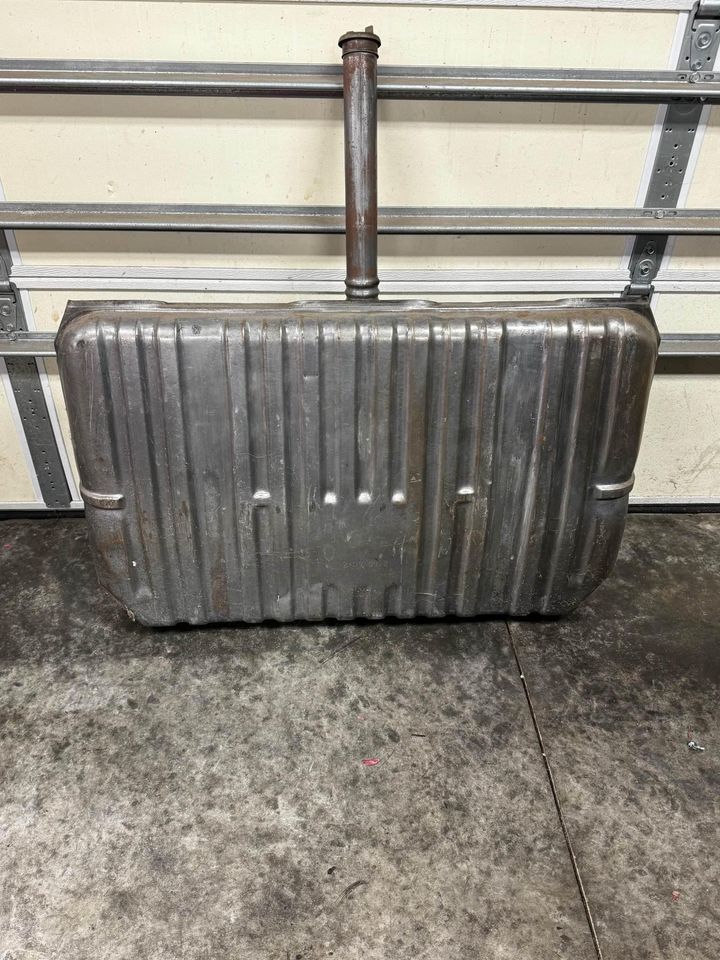

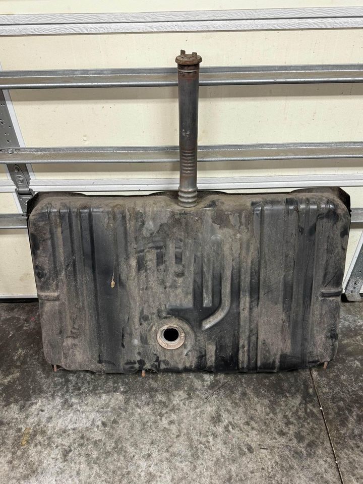

I'm not sure which year this is from, if that is important you probably know anyway. I was told the tank was taken out of a car not long after new when the car was made into a race car. Decent condition for 50 years old. Outside has some surface rust, inside is very clean with a tiny surface rust spot visible. I'll try to clean it up and get some better photos. $100 pickup central Illinois.

Suggest you indicate how many vents are on the tank and location(s). Images would help. ‘70 - ‘72 Cutlass tanks are not all the same. 2 or 3 vents?

I see three vent tubes at the front of the tank, which implies a 1971/72 tank. The three vent tubes connect to the liquid/vapor separator behind the back seat.

‘70 with 35NA9 (CA emissions) had 3 nipple vents in the same location as the image of the tank offered.

In ‘70, the standard 20-gallon tank had 2 vent connections in the location as shown in the image.
