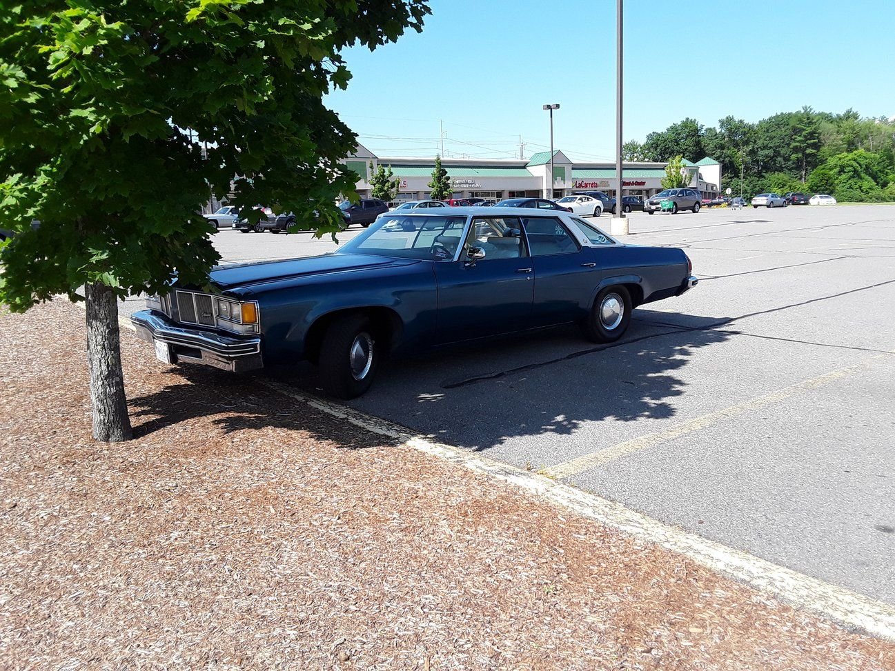

Here's the pic you uploaded to another thread. Post more detailed pics if you can. I've never sprayed metallic flake or BC/CC but I did spray SS urethane in OE Sandalwood on my 71 Olds 98. I'm definitely not a "bodyman" but I know you won't be satisfied with your paint until you finish wetsanding and buff the paint.

I wasn't going to post images but okay.
Here is a video for starters: https://tinyurl.com/y3r9ddz6
Did you catch the greenish tint in the sunlight. That's what 1.5 teaspoons of green ghost pearl does.
When dealing with heavy orange peel common on heavy clear coats, it's not that easy to just sand away at will.
Often, the low spots cannot be removed because it would cut too deeply into the flakes or pearl layers and seriously distort their appearance.
I could not go deeper than this before re-clearing the car because the flakes were just staring to break through, whether you can see it or not.
This is not unusual in metal flake jobs, and I did not want to risk more than about 8 heavy coats of clear for fear of cracking, meaning there was only 2 sealer coats that were totally clear on top and available to be sacrificed and sanded away.
If you can believe this- the above finish went directly to what you see below now after just 6 cans of Spray Max 2k clear.
What you can't see very well in the direct sunlight is the moderate orange peel and fine pin hole pits still remaining in places.
Notice the greenish tint and the gradient top to bottom? You will only see that in direct sun.
See the remaining orange peel and pin holes in the bottom half of the bottom photo?
If you look in the corner, the greenish reflection (satin green ghost pearl) shows up well.
The video does not do justice to the depth or to the lack of flaws you see in direct sunlight.
If I can seal these pits or get some additional good advice, I can salvage this paintjob.
