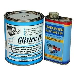

I have polished aluminum rims I'm going to powdercoat black in the center , and POR15 clear coat the edge for a lasting shine appearance.

If you want a chrome finish cheap, this is your next best bet.
Spray on Chrome. Then clear coat it with the POR15 stuff.
