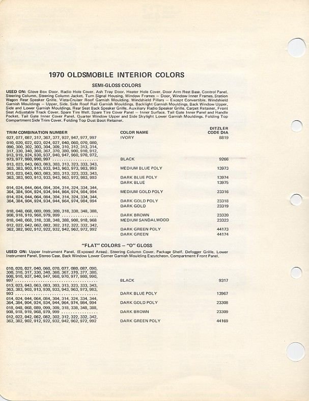

Given this photo, I am in need of some help
What is the difference between the Dark Green and Dark Green poly colours? I am thinking Poly = metallic, but even then, where do I find information on which part is metallic and which isnt?

Sorry, no. In Oldsmospeak, "poly" was metallic. Look at the paint chips. Only the metallics are called "poly". Polyurethane paint wasn't used by Olds at that time. Paints were primarily lacquer, though there were some uses of enamel.
To the OP's question, you need the Product Information Manual (aka Assembly Manual) for your year and model. The first section included pages that tell you exactly what parts of the interior were painted with which specific paint formula for each interior trim code.

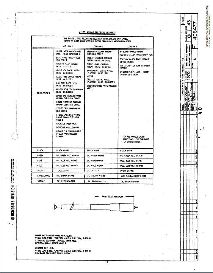

Here is an example of one of the several pages of interior paint colors and locations from the 1965 A-body PIM.

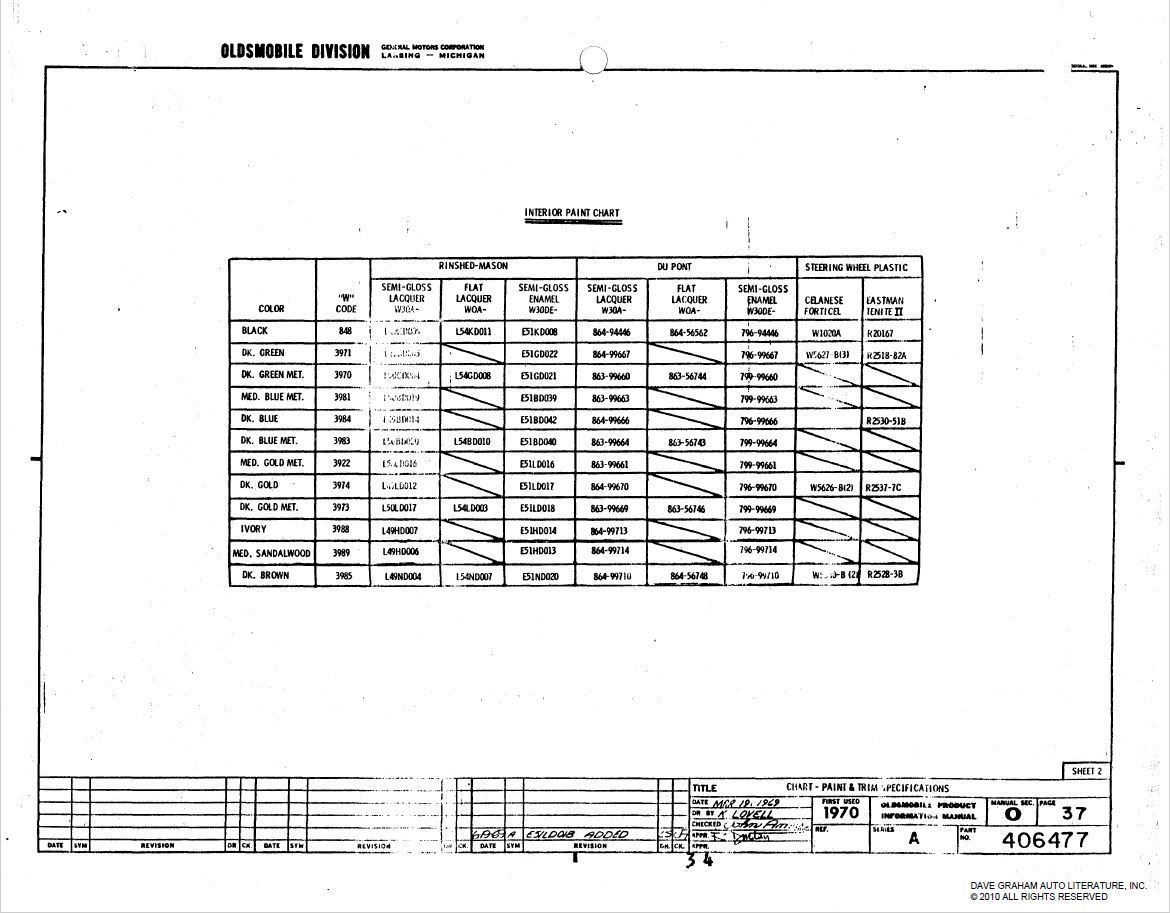

Good call. I looked at my assembly manual (1970) - group 0 has this info.
In fact, Page 37 uses the word metallic instead of poly
Page 43 lists which pieces get which colour
