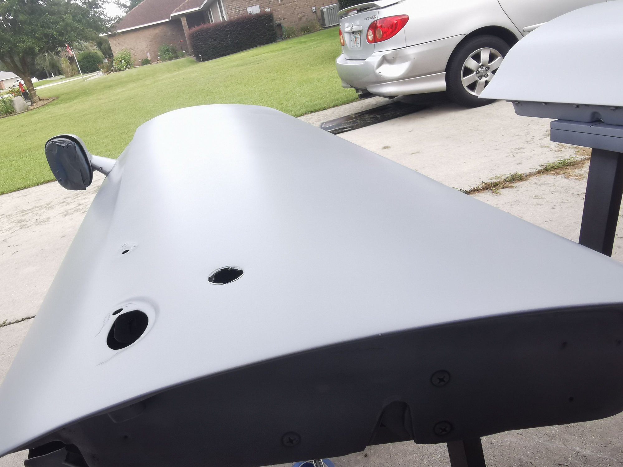

Hey tedd, Do you have any pictures? Are you spraying to far away? Enough reducer was it super hot when you sprayed it? What your gun adjusted properly? I open the flow screw to flow more paint and less air a lot of things could do it here's what my primeer looks like just sprayed these yesterday came out really smooth
