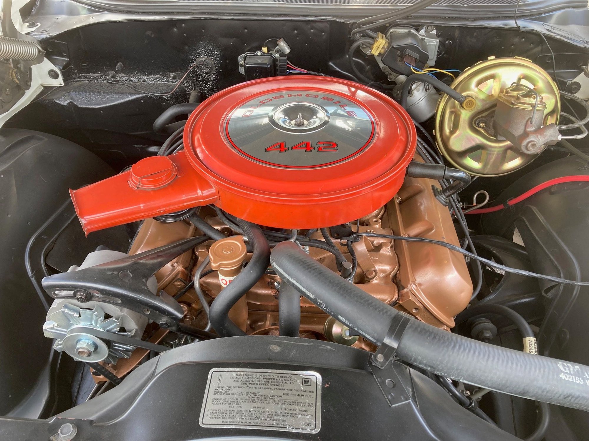

Here's a shot under the hood of my '68 4-4-2, which might be closer to yours if yours is not a W30 or Hurst Olds. I used Seymour GM Chassis black for all the painting under the hood (firewall, core support, cover over the radiator, bracket for alternator/power steering pump/AC compressor, underside of hood, etc.).
Randy C.
'68 4-4-2 convertible
'69 4-4-2 convertible
