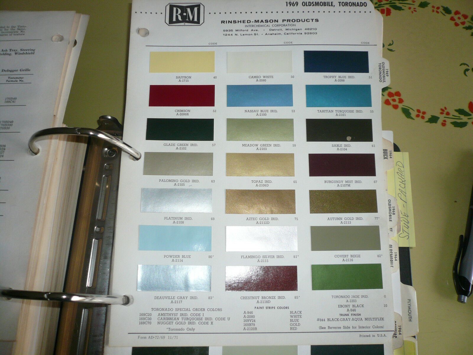

I'm trying to identify the color code of my 1969 Cutlass. It's the original paint. I've narrowed it down to 3 possible options. Topaz, Aztec Gold, or Palomino Gold. I'm leaning toward Topaz, but not sure. Anybody here have a good eye for color identification? I need some touch-up paint and need a color code.

Why guess...What's the code on the firewall tag say?
A good auto body paint supplier will have a spectrophotometer gun. Bring it there. Bring in a sample if it's not on the road.
This method will provide a better match as the paint has likely faded. Golds n Silvers are hard to match.

Looks more like Topaz to me. Is there a 65 on the body tag? Aztec is more brownish.

Aztec gold
No longer available.
I painted with a DuPont mix my spray card is marked up as +.5 845 +.5 891

75 is Aztec. That is darker. It looks more like 65 topaz. Look for evidence of a respray. Hard to say from pics paint chips and light reflection.
A spray out is the only way to get it close. Crapshoot. A good paint guy will get it close.
Have the paint supplier mix some spray bombs up for ya.
https://www.autocolorlibrary.com/pag...ldsmobile.html

Buy all 3 and try it in a spot next to a panel no one but you will notice. Then paint it the color
