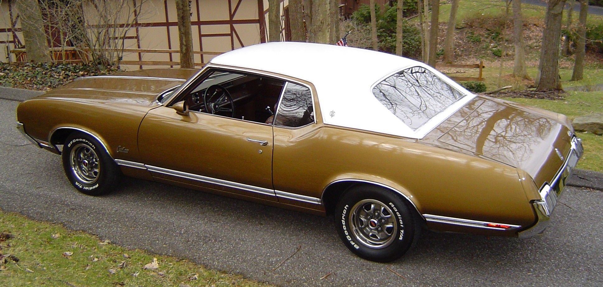

This is a 1970 with a factory painted top that I wish I had purchased locally in PA about 15 years ago. It came from Canada before that if anyone recognizes it.
Terry

RPO D99 two tone paint was factory available pretty much across the board well into the mid-70s (yes, even on the colonnade cars). And yes, the paint colors were separated by the same trim as was used on the vinyl top cars. You could also order RPO Y66, which was special order two tone paint, but those are much less common, and much more difficult to document.
