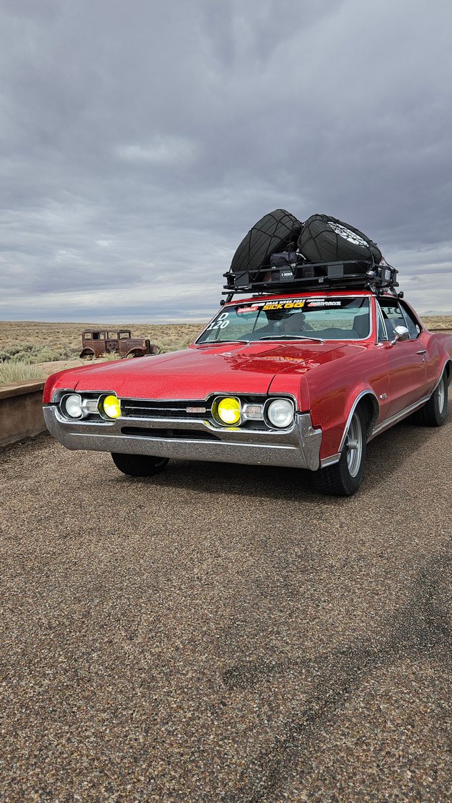

I used 1/4" fine line tape and Eastwood Cassis semi-gloss. Maybe not correct, but it looks good. Don't forget the screw heads!

Fleming, why are the inside headlamps yellow? Looks cool
Honestly, I don't know why the yellow lights. It was a 60s thing. Mine are actually functional fog lights on a separate circuit. The outer/low beam holes have Hella H4 conversions with OSRAM bulbs. I think you can get Holley Retro brights in yellow, but they're expensive. Some just paint them with tinted clear.
Any of you fossils want to explain the yellow light thing? 😁
