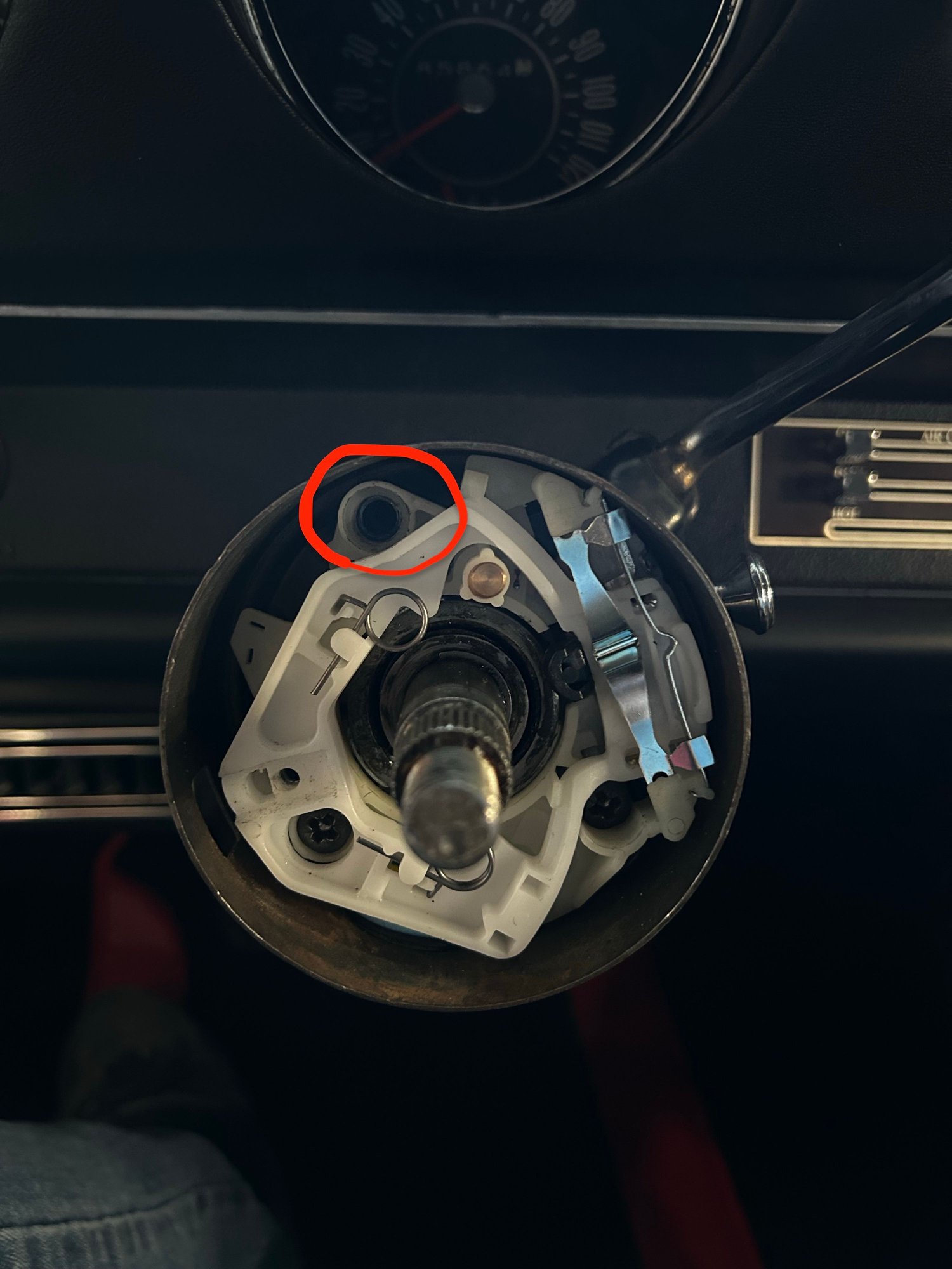

In photo 1, this was taken in the beginning of dis assembly. I have circled in red the top bolt, its in about the 12 o'clock position.

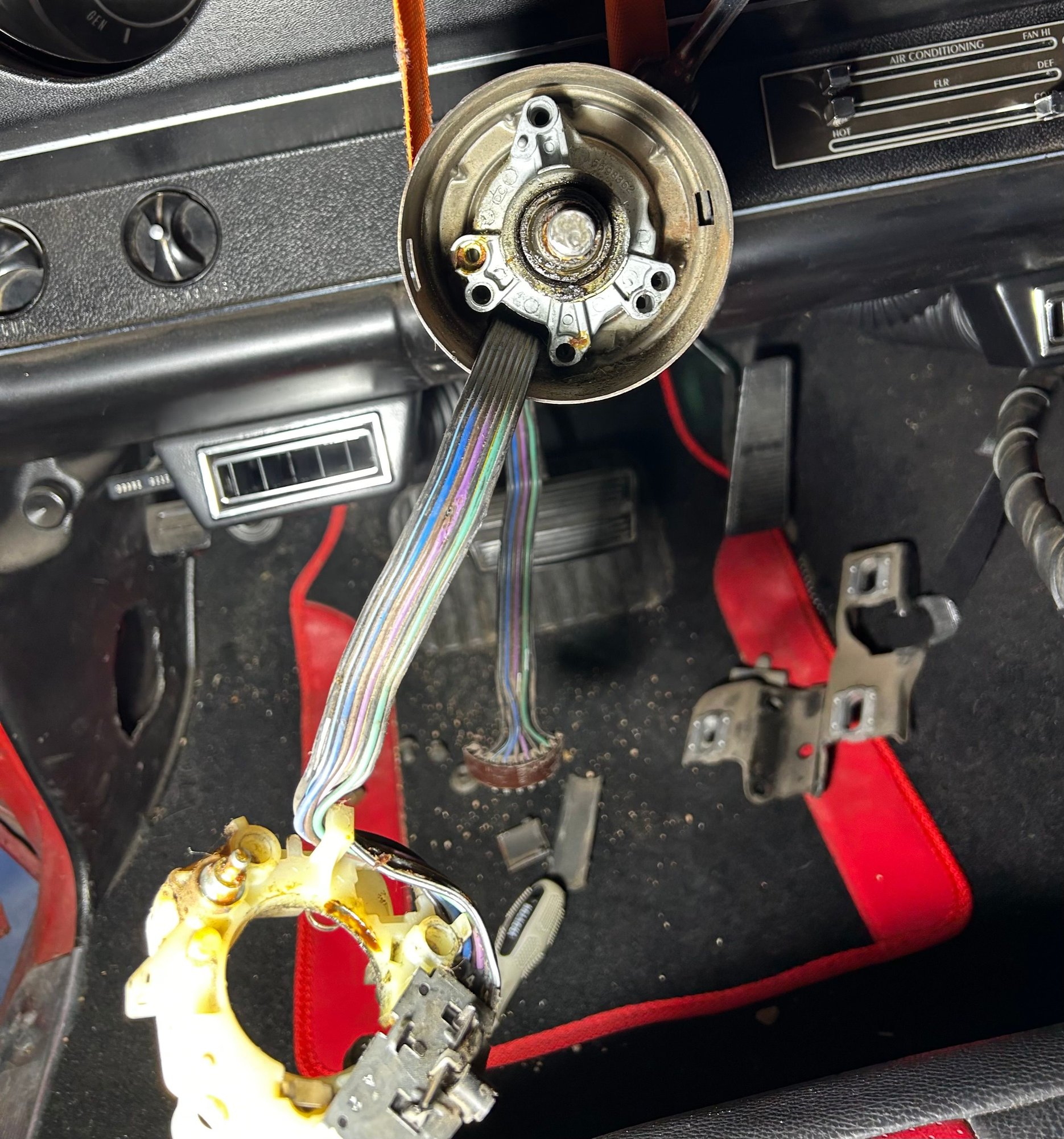

In photo 2 I show the "housing". The bolt go thru this, but it is not threaded. It does spin / rotate slightly.

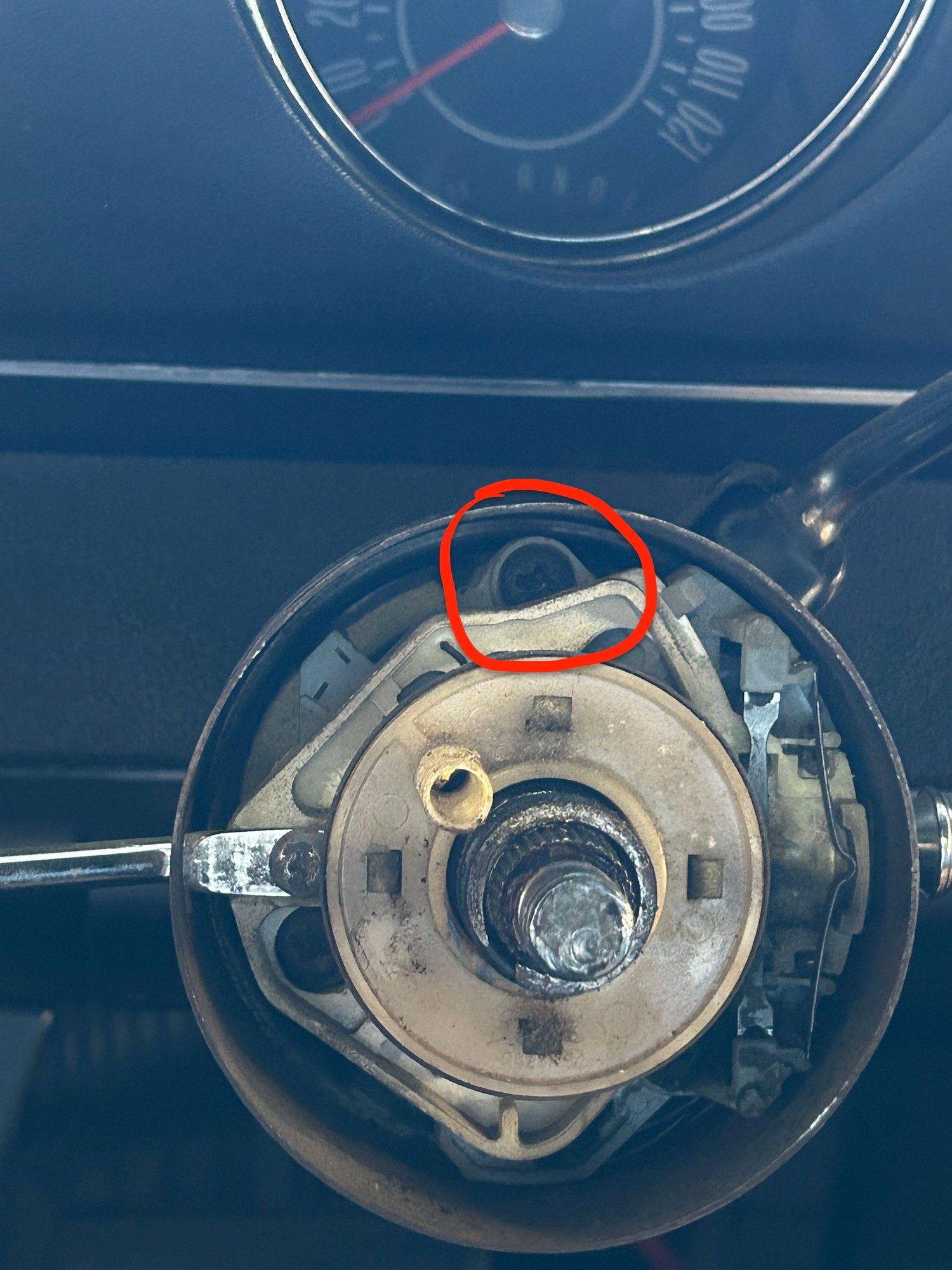

Photo 3 shows after re assembly. That circled bolt is now at the 11 o'clock position. That forces the turn signal level to be rotated down, almost touching my leg. I cannot get the housing back to 12 o'clock.

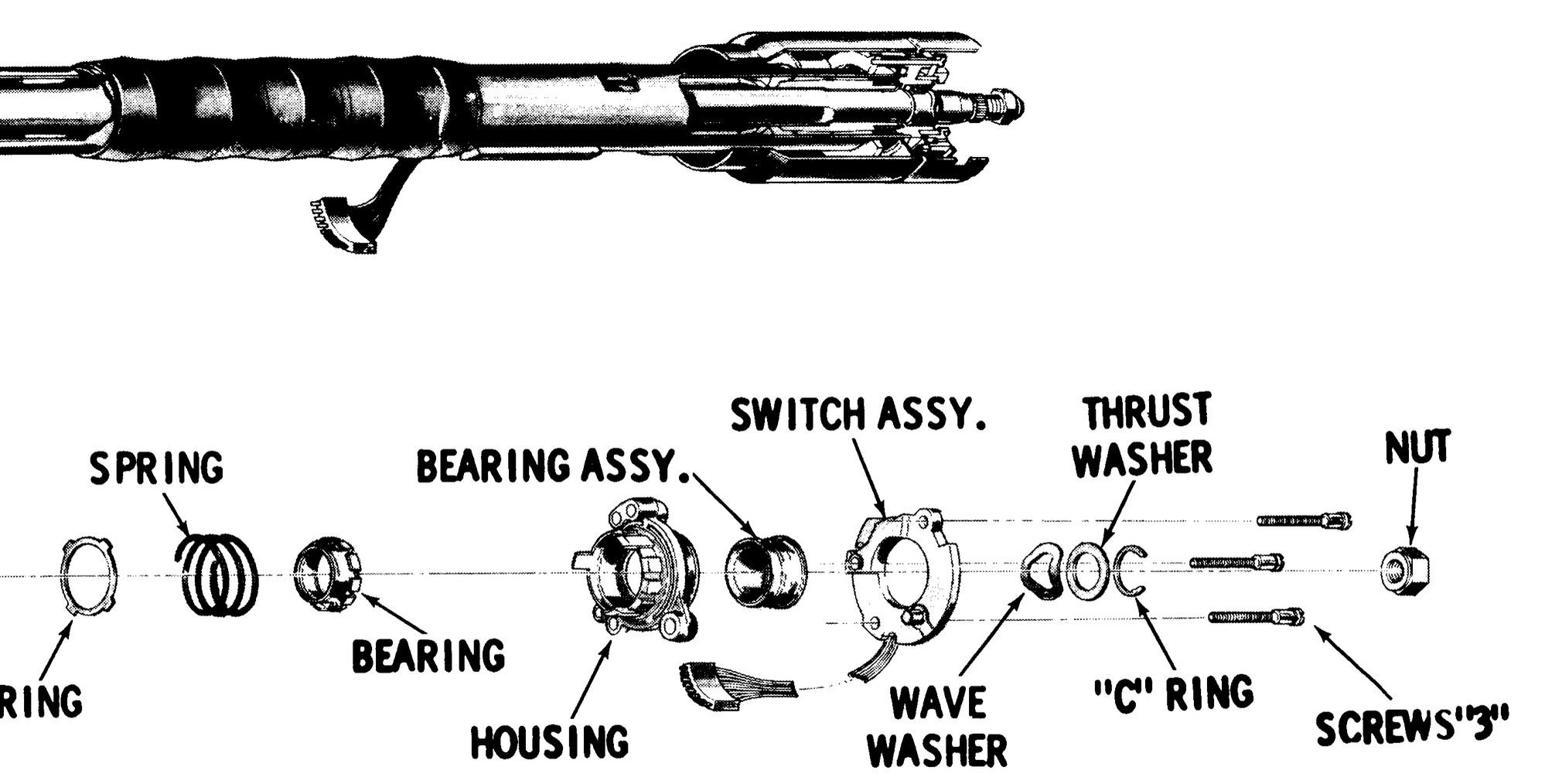

Photo 4 shows what I THINK the assembly should look like. It does not show what the 3 bolts actually are threaded in to.

If you look at the flasher button on the column in the two pics looks like you turned the wheel housing no ?
and take a second look at the blinker arm to see if it is properly attached

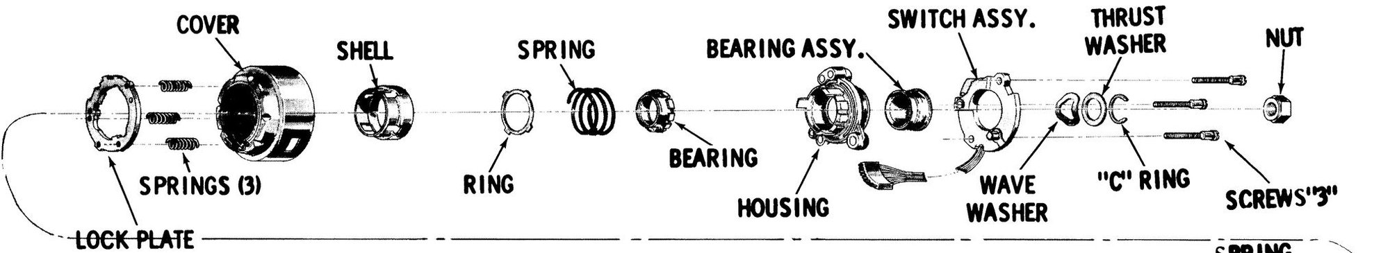

I think I may have rotated the "Lock Plate", which is the far left item in the picture below. Does anyone have ideas of how I can rotate it back into place? Hopefully without disassembling the whole column....
