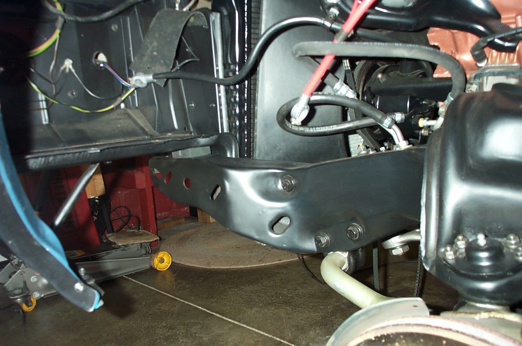

I replaced all my body bushings including the ones on the core support in '18, I really lucked out as everything unbolted with no problems!. I bought everything from Inline. Their core support bushings were a good 1/8" thinner than my originals so I had to add shims(like the assembly manual shows) to keep the sheet metal aligned properly. Lucky for me my local Napa store had the large body shims in stock in 1/16" & 1/8" thicknesses. My original core support bushing had no shims. You wouldn't think 1/8" would make much of a difference but before I added the shims on top of the new bushings the sheet metal was all out of wack at the front!! Big gaps at the front edge of the fenders!
