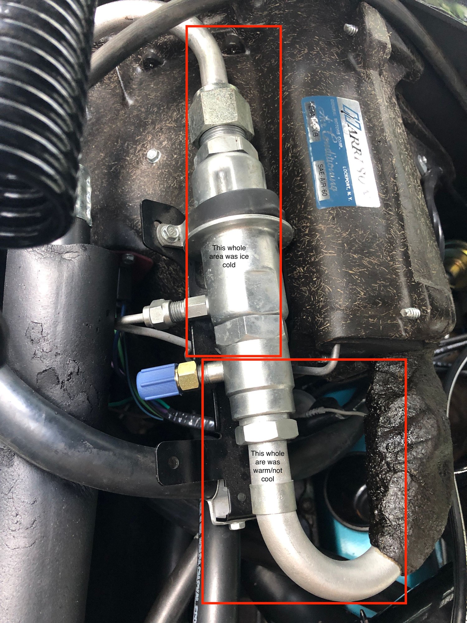

Okay where do I start... I have bought all new/rebuilt AC equipment during these last three to four years from different vendors (parallel flow condenser, drier, AC box w/blower, expansion valve & POA valve (adjusted for R134), all new hoses, and had the compressor rebuilt. I had completely taken apart the car and went through all the AC vacuum hoses and checked to make sure everything operated correctly. I placed 10.5 ounces of Ester R134a refrigerant oil in the compressor after draining out the oil that the vendor had placed in the compressor for shipping purposes. I then turned the compressor by hand ten revolutions and then placed it into the car. Again, everything is new or rebuilt in this system.
I went to a local repair shop that does AC and they put 3.2 lbs of R134 into the car. When the mechanic tried the AC, the compressor was engaging, he was getting air out of the vents but it was not cold nor cool. As the mechanic was checking the system he noted to me that the beginning and towards the middle of the POA valve was very cold but the other side of it where is goes off into the evaporator was warm - not cool. The mechanic did not know much about this system and thought there was a bottleneck happening there in the valve. He said to take the car home and see if I could figure out where the issue was and then bring it back to him to evacuate the system again if I need to change a part out - the mechanic stated he would not charge me for the services to evacuate the system since I had already paid for the freon and he would put it back in once I corrected the situation.
I took the car home and checked to see if I had everything tightened and that all seemed good. I then placed a set of gauges on it, the low side read 90psi and the high side read 150 psi. I thought maybe there might be too much freon in the system and I went back to the shop where he evacuated all the refrigerant out of the system and then placed 2.5 lbs of refrigerant back in. We again tried the AC but still no cold air, the POA valve was doing the same thing again - very cold on one side and warm on the other. I had him evacuate the R134 out of the system again and I brought the car home. When I got it home I searched on the web on how to test a poa valve. I followed what the youtube video
showed and I took off the lines on the poa valve and the expansion valve and hooked up my low side pressure gauge to the POA's low side valve and the took my compressor and blew air through the expansion valve and it showed I had pressure of 27 psi and the air was coming out of the POA valve where I disconnected the muffler hose. I think that the poa valve is good according to the test I ran but I don't know whether this test is a good indicator of a healthy or busted POA valve.
Pondering my next move... The compressor sounds good (no noise that would alert me that something is wrong with it), no squealing from the belt, air blow great through the vents from low to high. As I stated in the beginning I had all new hoses, condenser and drier and had rebuilt the ac box and the POA valve was adjusted for R134. My mind is mush going through all the AC threads on the site, I need assistance - did I miss doing something? Should I have added more freon - higher than the 2.5 but lower than 3.2 lbs?
My original one and the one I received rebuilt (2016/2017?)

Is the POA valve calibrated for 134a? Pressure sounds good though, ought to freeze you out of there. How about the temp sensor bulb, mounted securely and wrapped with that goo the factory used?
Rule of thumb with a 134a conversion is use 75-80% of what the original R12 charge called for. As in if it wants 4lb of 12, use 3lb of 134a.
Good luck. AC can be a voodoo science sometimes.
*EDIT* Sorry, missed where you said POA was set for 134a.
All of the above questions are a Yes response.

Okay, so I've had two cups of coffee and my mind is a bit clearer. I was re-reading the Service manual and came across the "Refrigeration Circuit" section, the mechanic had it backwards in how the system should work - he had me confused too. The system shows it goes from the compressor to the condenser to the drier to the expansion valve through the evaporator then into the POA valve before going back to the compressor. This means (to me) that the POA is acting correctly, I remember the mechanic pointing out that the expansion valve was warm too - so is it the expansion valve that is bad?

Tom, there is a replaceable screen in the expansion valve that gets clogged sometimes if the system breaks. Is the expansion valve new, used, original? A few years after our cars they went to an orifice screen deal. Scratch that...I see you said everything is new.

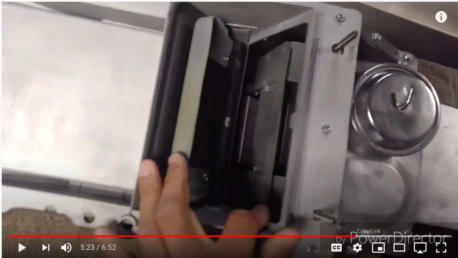

Question, on the inside AC/Heater box what is supposed to open to allow the evaporator to allow the cold air to come through into the compartment? I had taken off the lower ac vent and lower right side panel to view the side vent to see if it opened up properly when the lever was switched to the AC normal and Max settings and it worked properly.
I'm just trying to think of other reasons why the cold air is not making its way into the cabin. I truly appreciate the input given so far both through this thread and pm's.

I found my answer looking at a Youtube video - I'm going to need to find out if the actuator is opening up the door to allow the AC to come into the cabin. Is there an easy way to check since it is behind the box?

Inside the HVAC box there is a door that moves to let air come from either the heater core or the evaporator. That door is controlled by a cable attached to the COOL / WARM slider control on the dash.
There is nothing inside the HVAC box that controls the flow of freon. The freon is all throughout the AC system, when the compressor runs it is moved through the system and the expansion valve creates a restriction so there is high pressure on one side and low pressure on the other. The low pressure freon goes through the evaporator where it absorbs heat from the air, then travels back to the compressor suction side.

I finally have AC! Just in time for summer to come and go It was the POA that was defective, I bought another to replace it only to have the guy ship me the wrong style. The second one that he sent fixed the issue I was having, now I'm set for next summer's heat

Thanks for posting the solution. It all makes sense - the POA valve icing up where the restriction was and it was acting as an expansion valve.
