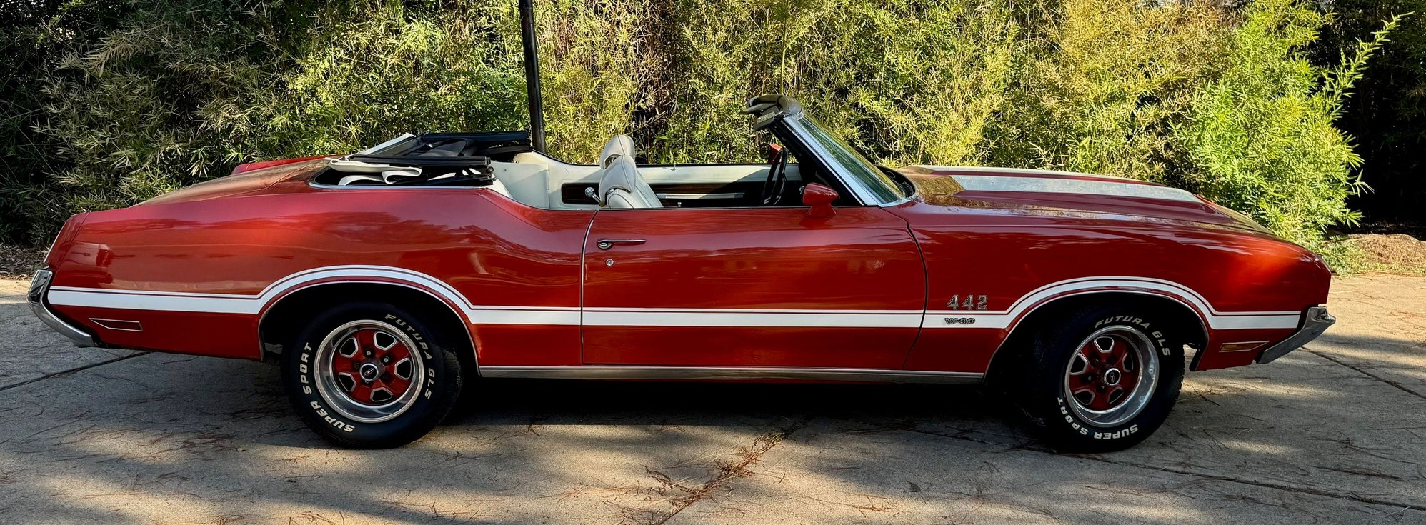

Thinking about installing an LS in my 1972 Oldsmobile Cutlass Convertible. I bought it knowing that it was originally a Cutlass Supreme Convertible made up to look like a 442. Also had the original engine replaced at some point with a 403 that appears to now have spun a bearing, so it’ll have to come out. My tentative plan is to upgrade the drive train and then tackle the paint and body. Looking for some input.

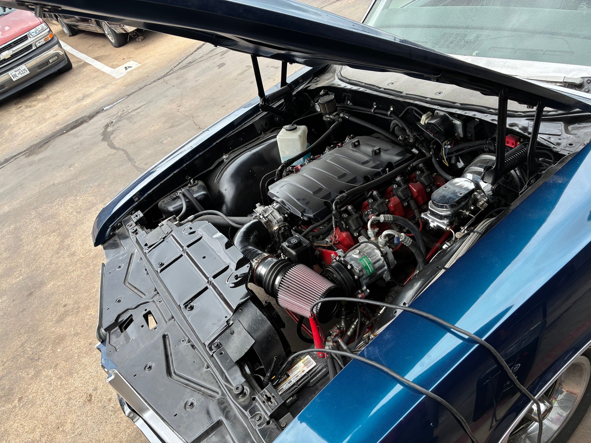

recently finished an Ls swap in my 69 convertible- (many on this site will tell you that you should keep it all Oldsmobile). The swap was a big undertaking-( by no means am I a professional mechanic) lots of information about ls swaps on gm A-bodies. Combination of motor mounts, exaust, engine, will determine what will fit. I was not certain my hood was going to shut for the longest time- but it does.. i did mine on the cheap with a vortec truck motor. I was just thinking I should post some pics-

Sounds like a fun project. The car looks great, why plans for paint and body work?

Some minor blemishes and areas of concern should probably be addressed.
