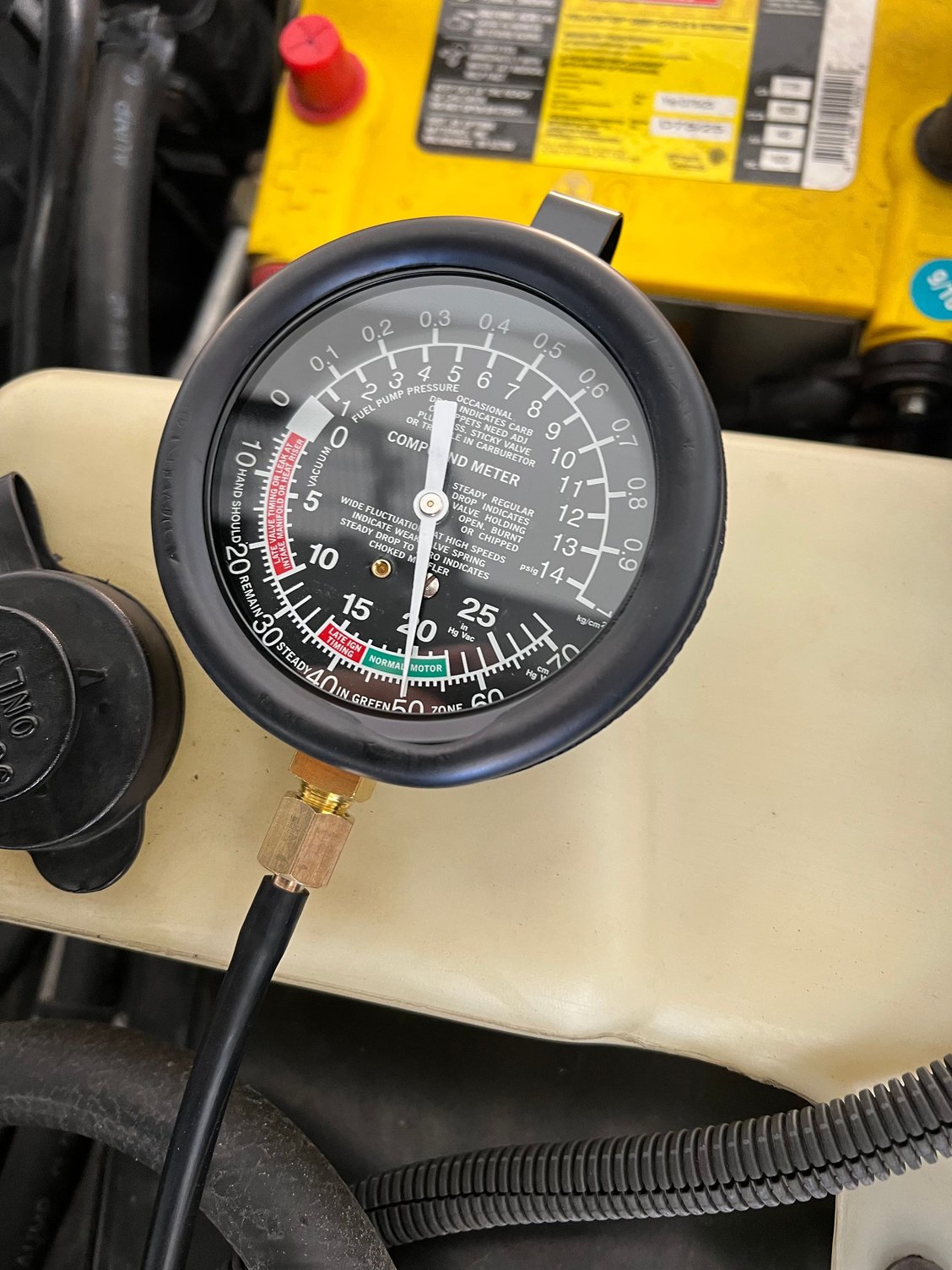

Thanks, I isolated the egr and put my vacuum gauge in lieu of the EGR. Ran to closed loop and duplicated the problem. Vacuum never indicated as the throttle (tps) was not actuated. Just for funnsies, I swapped out the map sensor with typical results. The problem is clearly an issue of when the ecm goes into closed loop. Diagnostic continues to show 1.7 volts rich, idle hard ossilates until dying, or tripping a service engine light and reverting to open loop.

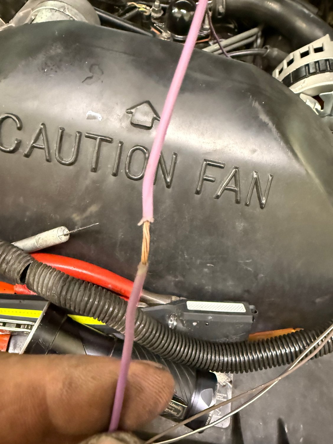

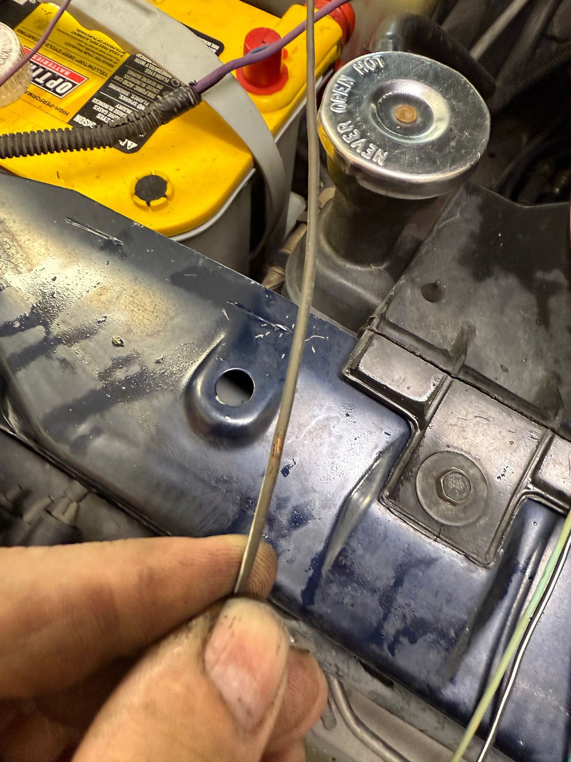

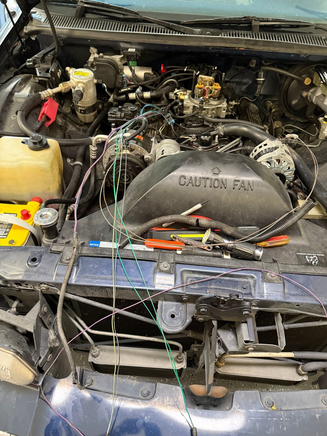

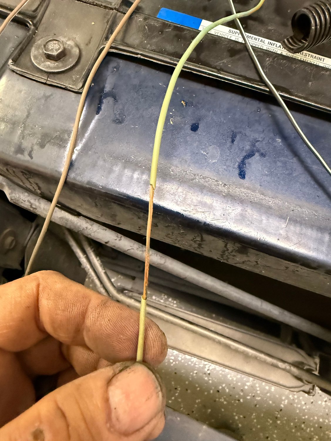

After six months of exhaustive troubleshooting, I have finally located the source of my issue. The wiring harness to the front of the engine wraps around the front of the oil pan. The alternator excitation lead insulation had a worn/deteriorated portion which was shorting to the power steering circuit and the O2 circuit providing excessive voltage to the ECM to indicate a hard enriched exhaust. I removed the harness, cleaned, repaired and secured with fresh split loom. Ran the car last night with normal O2 readings switching rich/lean as advertised. Very happy to put this problem to bed..
