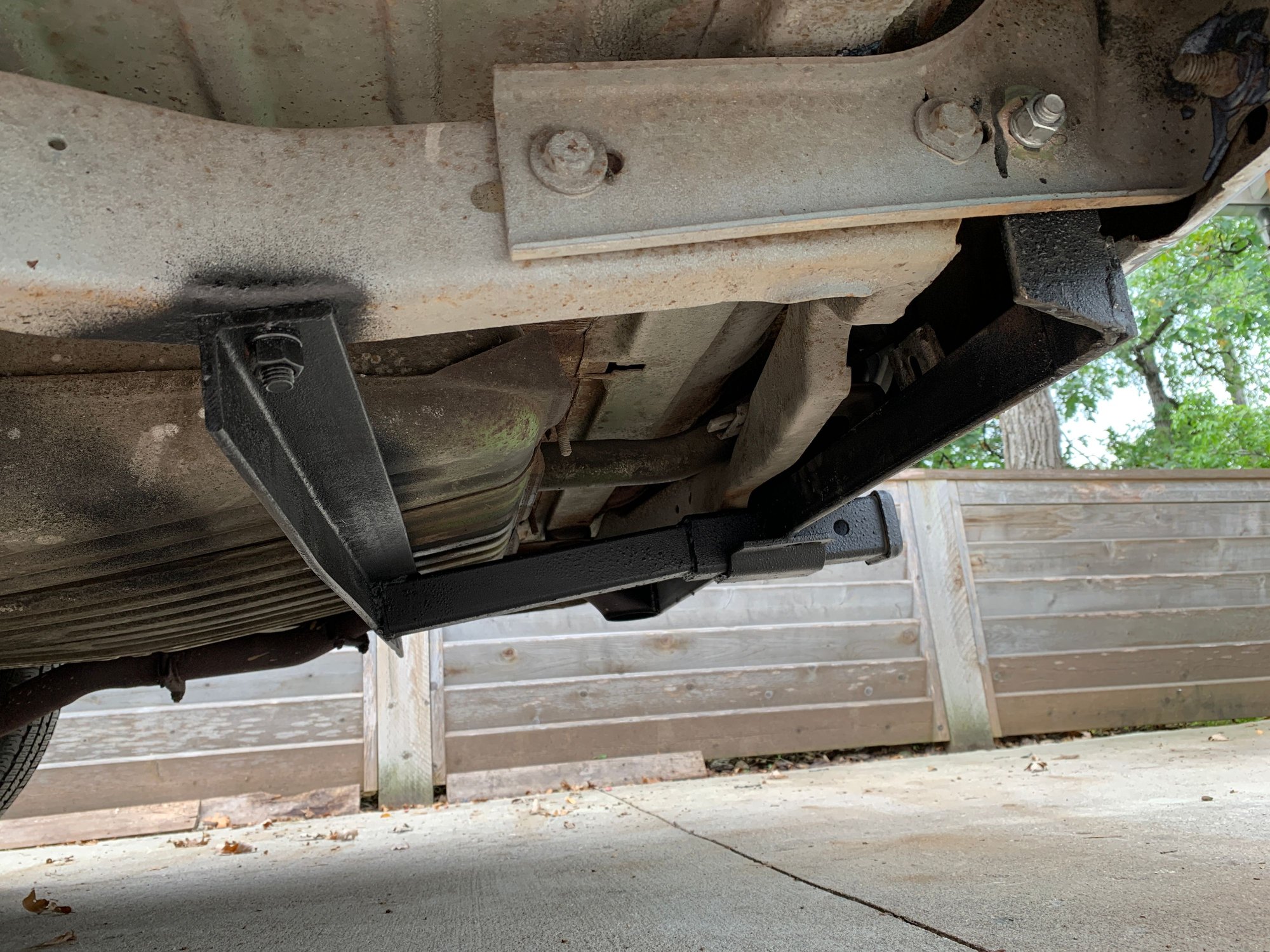

My second try at loading some photos here. The deed is done. Today. Looks pretty neat and tidy to me. Haven't towed the camper yet, as I still need to get the car wired for the brake controller.
Tomorrow we add a transmission cooler.
Thanks everyone for the advice and encouragement.

That hitch is not giving me a warm/fuzzy feeling.

Uh-oh. How come, Eric?

Agree. I don't like it. Review Joe's Post #9. They installed simple angle iron and not much of it in the correct manner. You essentially have ONE bolt on each side in the frame - ONE BOLT and a single piece of angle iron. I'd prefer to see a minimum of two bolts (best 3 bolts) and a minimum of 2" square tubular iron - not angle iron. Again, review Post #9. Not having a warm & fuzzy on that hitch.

You have basically a bumper hitch, IMO. You have two bolts in the bumper bracket and you have two bolts in the frame. You have VERY VERY limited lateral strength. You need far more support provided by the frame.

You can probably salvage what they already have installed with some modifications. I'd prefer to see one large flat piece of solid steel which spans the entire frame - from frame rail to frame rail with a minimum of three preferably four bolts mounted/running through both the solid piece of steel and each frame rail. They'll have to weld that piece of steel to the current assembly (remove, reassemble, weld, remount). In case they or you might have difficulty finding such a piece of quality steel, go to a ship yard &/or boat yard where they have numerous pieces of various sizes laying about. A ship yard &/or boat yard is constantly (daily) welding in new bulkheads, pieces of hull, doors, windows and the like. One quarter (1/4") thick would be sufficient, 3/8' thick would be optimal, 1/2" thick would be overkill. I recently had to raise a 5th-wheel hitch on an F-550, I used a piece of 1/2" thick steel 32" square mounted directly onto the bed and through the underlying frame rails and cross-members. Towing 16K lbs. Don't compromise.

Took the words right out of my mouth.

Look, that angle iron is probably the lowest grade mild steel you can get. Angle is a crappy choice for bending loads, which is what this will see, both towards the ground for tongue loads and towards the back of the car for towing loads. There's a reason why real hitches use 2" square tube or better. The single bolt into the bottom flange of the frame is now in tension for tongue loads, and there is almost no edge distance from the hole to the edge of the angle iron. I wouldn't tow more that a Class trailer with this. The 2" receiver is a joke - don't attempt to use it with a real trailer. Sorry, this is a poorly designed hitch at best, and that angle iron under the gas tank is already distorted from the install. The "S" shape in this photo does not instill confidence. There are multiple critical welds in tension, which is really poor practice. They should be in shear for safety. Also, I suspect that black paint is hiding some less than stellar weld beads.

I like the Reese hitch Joe provided in a picture. They sell that hitch via a retailer in Canada.
https://store.cookstreetcastle.ca/product-p/6366306.htm
Here's the skinny on the specifications - Part No 37042
https://www.reesetowpower.com/Produc...-trailer-hitch
Dimensions: 10.25" x 32.5" x 6.9" (Shipping) Finish: Black Powder Coat Over E-Coat Weight: 52.3 lbs Weight Carrying (WC): Up to 500/5,000 lbs. (TW/GTW)
  • 2 in. Square Receiver Tube Opening
  • Rated Up To 5,000 lbs. Gross Trailer Weight (GTW) And Up To 500 lbs. Tongue Weight (TW)
  • Suitable For Use With Weight Distribution Hitch Up To 6,000 lbs. Weight Distribution (WD) And 600 lbs. Weight Distribution Tongue Weight (WDTW)
  • All Hitches Are Designed For Customers With Trucks, Vans, And Sport Utility Vehicles
  • Bolt-On Installation, No Welding Required
  • Metal Shield® Resists Rust And Corrosion

As disappointing as your feedback is, I appreciate it. I want to do this right.
I'll go back to one of the shops that turned me down, for advice if nothing else. They were potentially willing to do it in the middle of winter, at their down time, but given where I park the car for the winter that's next to impossible. (They were also going to manufacture something).
Just a reminder: the camper is just 1,800 lbs, with a tongue weight of around 180 lbs. I don't plan to ever tow anything else with this car. But I've had it for 20 years, and I'll be keeping the car and the camper for life. So I want to do this right.
Thanks again. I'll keep you posted.
