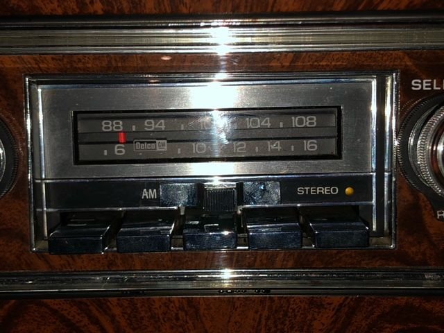

Radio removed AM FM slide bar replaced so radio back like new. There were 3 coins inside the radio jamming up the buttons and causing the other slide bar to break. I found some NOS slide bars for a 1977 radio. Antenna next.
