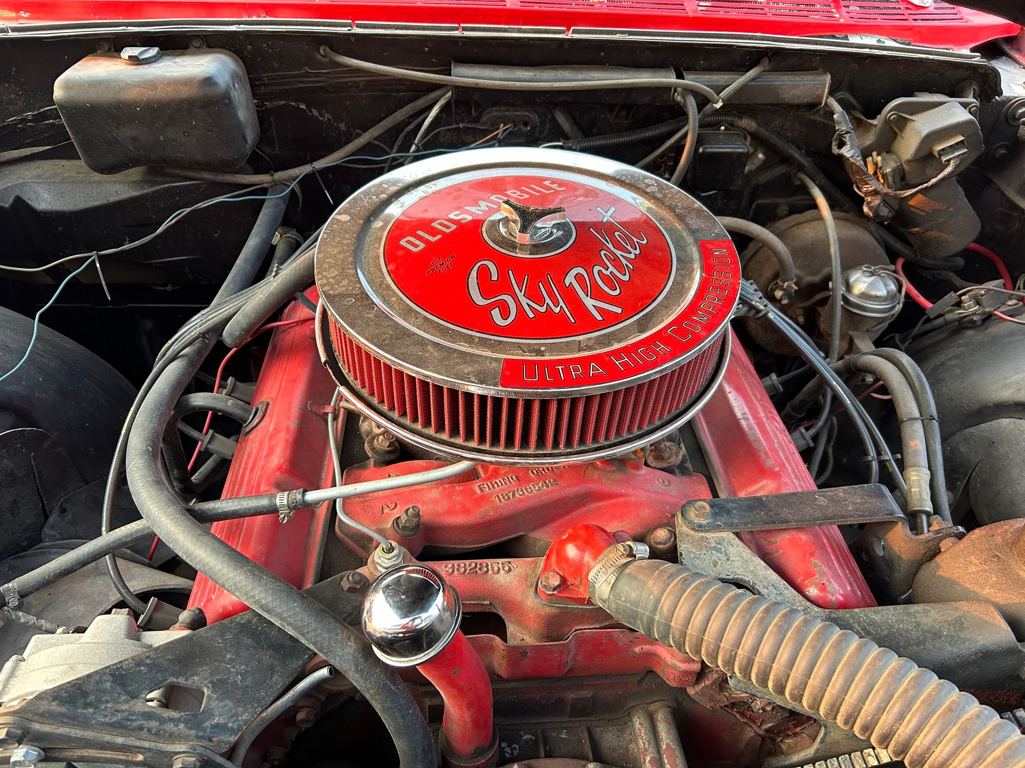

Old Jul 26, 2024 | 08:09 PM
Mwatts2024's Avatar
Joined: Jul 2024
Posts: 15
From: Canada
Originally Posted by Olds64
Does your car have a fan clutch? If so, it may have failed. Make sure the radiator and fan shroud are in place.
I posted some pics under the hood

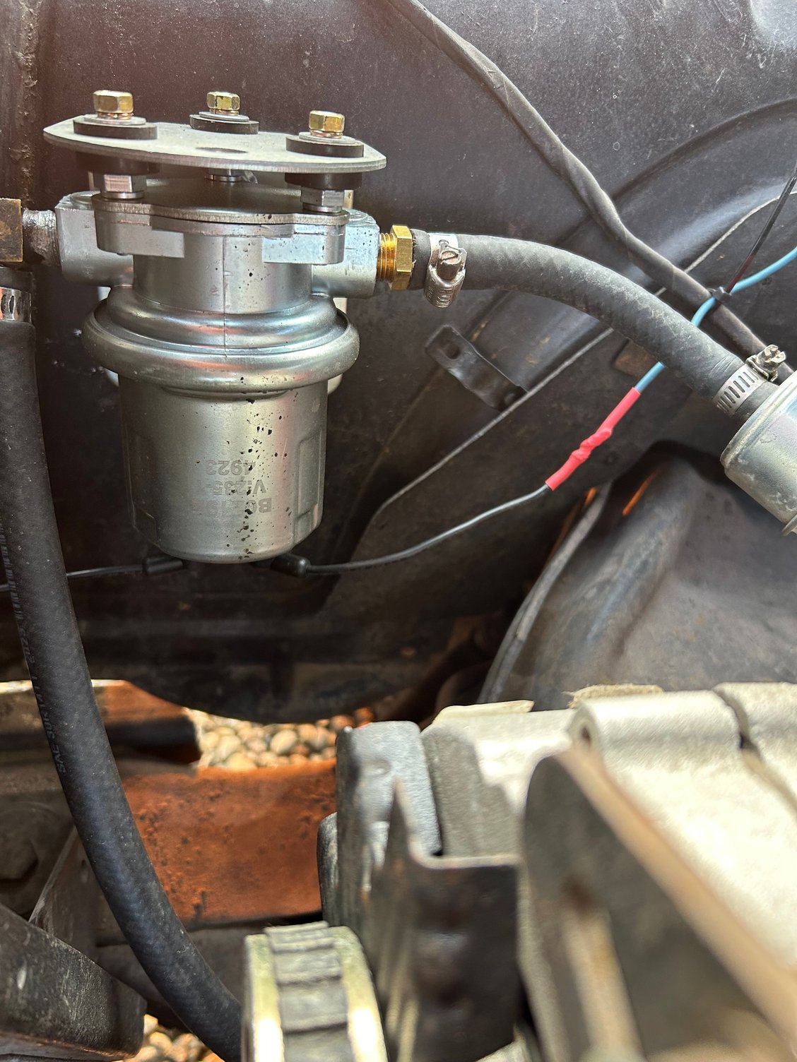

Actually I had it switch to an electric pump because I couldn’t find a part around here and didn’t want to wait forever to get one.
Usually people mount an electric fuel pump near the gas tank because they are "pusher" pumps. Do you have a fuel pressure gauge and a fuel pressure regulator ?
Old Jul 27, 2024 | 12:15 AM
Posts: 15,409
also the fan I guess was pretty small so the mechanic put on a larger fan.
Is that picture above the new fan or the old one? It looks like a flex fan, which would not be my first choice as they do not move as much air as a regular factory style fan.
thank you. I will have that moved. I see your right about that.
that is the new fan. The one that was in there before was a lot smaller. You think it’s not right?
Old Jul 27, 2024 | 06:26 AM
Posts: 18,225
When the mechanic installed the new fan was the OE fan shroud removed and saved? Even if the OE fan was smaller if it had the correct shroud it probably moved plenty of air. It's hard to tell but it looks like there's no fan clutch installed with the current fan.
