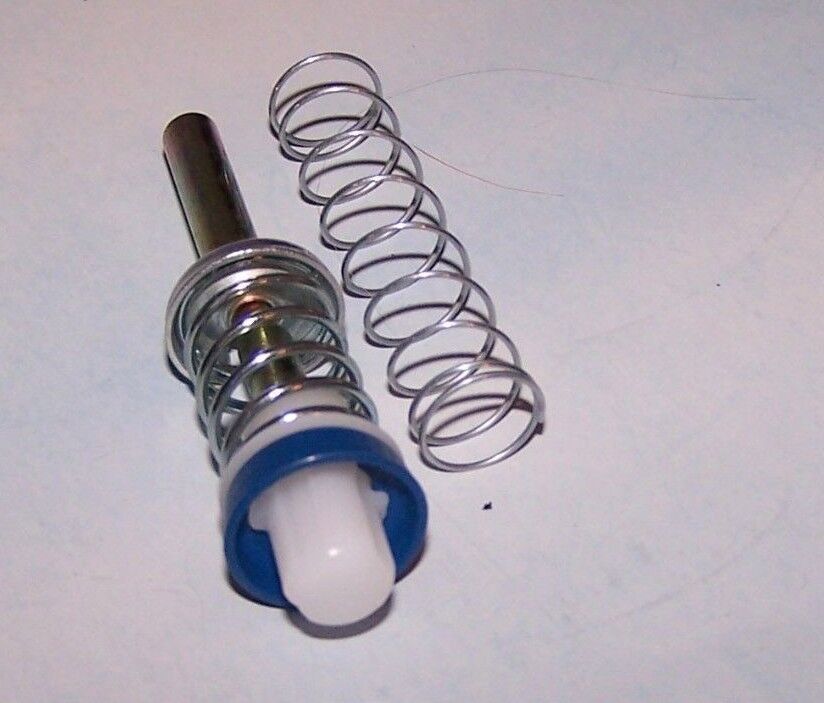

Obviously, this is only a suggestion. My first suspicion would be the Q-Jet accelerator pump. Both the linkage &/or the grommet on the pump are known to get sticky in various positions. Very inexpensive and easy fix.
EDIT: Sometimes that spring can bind/wear out, etc.
Will check that out. Thanks, Norm.

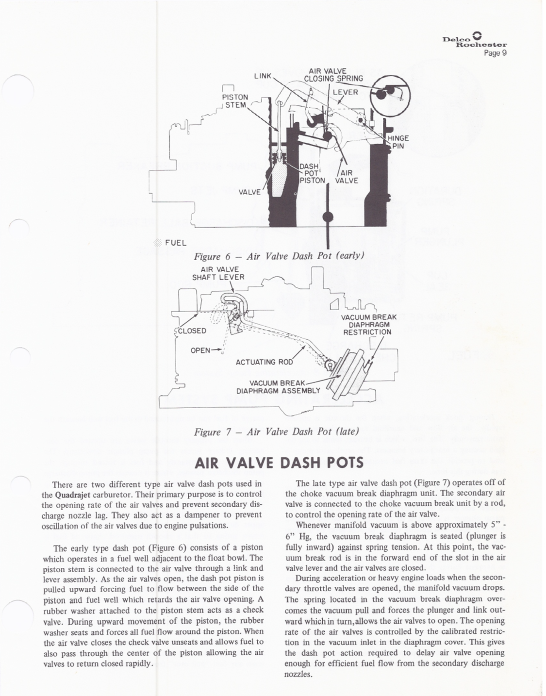

And your description would still be incorrect. The vacuum diaphram is only used to retard the opening of the secondary air valves. It does NOT cause them to open. You can disconnect and plug the hose to that diaphragm and the secondary air valves will open even more quickly. Your statement from above is completely incorrect.
Originally Posted by Dynoking
The diaphragm fails causing the secondary air valves to not open
Of course, rather than take my word for it, let's "brush up on Qjet operation" by going to the Rochester Qjet manual. Note in particular the second sentence in the first paragraph.

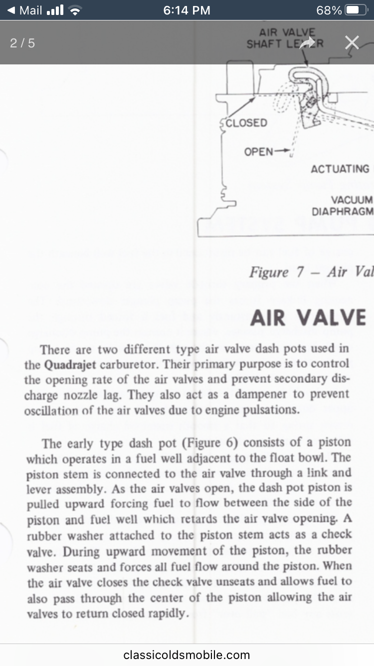

in his first message he specifically says “it controls the opening”
here’s your link pick, it specifically says “it controls the opening “
what it does is controls the opening rate…that’s why the dashpots have a tiny oriface in the opening to gradually bleed off the vacuum and allow the air door to open at a predetermined rate.
his second part is wrong…not the controls the opening part because you are saying that same thing

Did you conveniently leave out the part where I said his second statement was WRONG? Ya, you did.
again, back to what I initially said…..”it controls the opening” that’s his first statement..it’s also yours.
does it control the opening? i know what happens if the diaphragm doesn’t work. I said he’s wrong on that.
Wanna try again?

To be clear because Joe likes to lie.
the dashpot DOES control the secondary air valve opening…he said it doesn’t
if the dashpot is defective, like the diaphragm has a hole in it…it won’t allow a any controlled opening of the air valve ,, the air valve door would only be controlled by the air door spring, which could cause a hesitation/lean condition when secondaries open open to fast

Just to clarify, there IS a vacuum diaphragm on the Qjet secondary air valves, but as correctly noted, it doesn't control opening, it actually holds them closed under high manifold vacuum conditions.
this is false.
the diaphragm DOES control the opening rate..that’s it’s sole purpose. Holding them closed is NOT its main function. The air door is held closed by the spring tension on the air door shaft. The car with run exactly the same with or without a defective diaphragm, until the secondaries are opened.
wanna rethink this?
wanna rethink this?
My statement would have been clearer if I had said that the vacuum diaphragm doesn't ACTUATE opening. Yes, I could have worded it better. More to the point, I was specifically replying to a prior post (NOT yours, by the way, despite your need to make everything about you) that stated that a failure of the diaphragm could PREVENT opening, which it cannot.
