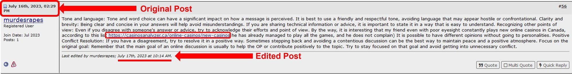

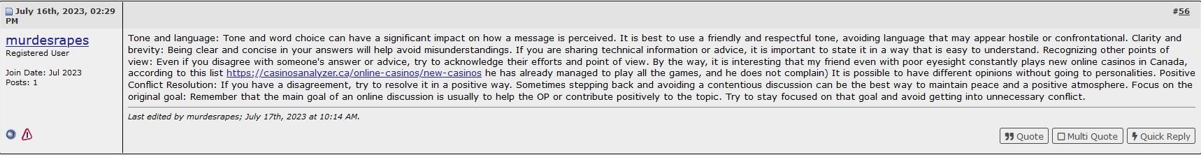

Actually, there was a response to your query...but 1st.... I STRONGLY suggest no one click on the link inserted into Post 56
Follow along, you'll see what's happening...phishing scam w/ a bit more disguise; however, be aware it is entirely possible to introduce a virus, Trojan Horse or back-door man-in-the-middle attack from such deviant behavior.
murdescrapes created a user account and logged in July 16th, 2023, 02:29PM. Luckily Member SY2455 (and others) created a Post quoting murdescrapes first post. NOTE this first post (captured via SY2455 quote) was edited by user member murdescrapes on July 17th, 2023, 10:14AM. murdescapes is still listed as having Posted only "1" (one) time - because an edit is not considered a new (additional) Post; albeit, murdescapes still demonstrates only one Post.
This is the clever part.
The last post to the thread was July 16th, 2023, by yourself (DYNOKING) at 09:42AM. One half hour later (after your last Post) murdescapes logged onto this website and edited their original Post by INSERTING a URL link into their original Post (#56).
I have notified the moderators.
Note the timestamps
SY2455 first captured the original quote - note the timestamp.
When they inserted the URL link - note the timestamp.
