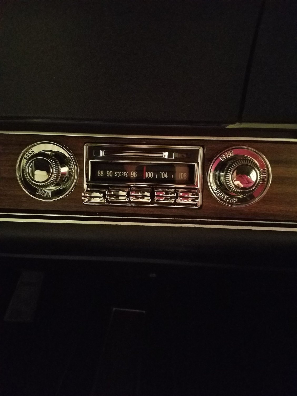

Picking up my old thread...
After two long months I just received my kick panel speakers and new retro stereo. 300 watt ken Harris with 300 watt 6.5" kenwoods. From all I've read I might need additional tweeter speakers, but gonna start with this.
Before I begin the install, looking for any tips/advice - from installing stereo and kick panels to running wire (front and rear, tho I'm not installing rear speakers at this time -I don't want to cut any panels and, being a convertible, my placement options are limited.)
I have 14 gauge wire and all necessary connectors. Just got to figure out necessary wire lengths and the best way to run the wire under the carpet.
Do I need to connect the windshield antenna, or is it okay to leave it untouched, in the harness (the yellow wire is sealed, so I'd have to cut it and add a connector)..?
As I say, any and all tips are much appreciated.

Fun71 you are totally correct... I misinterpreted the diagram.... FYI, Ken Harrison KHE300 radio sounds/looks great with the kenwood kick panel speakers. Impressive retro look with genuine faux "dial" display However, the radio is cheap feeling.. All plastic, very light... Dials don't fit well (had to wedge them on), weak push buttons feel like they may break eventually.
Happy for now... Sounds and looks 1000x better than the center speaker, for just over $400
