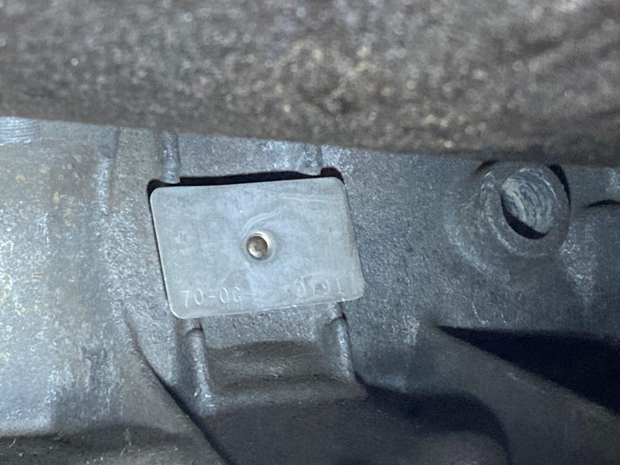

That's weird - I can see the images on my screen. I guess it may be more appropriate to post these specific questions in other areas. Apart from that - what would prove it to be a W-30? Just paperwork? This is the right side of trans.
it looks like it says: 70-0G 9791

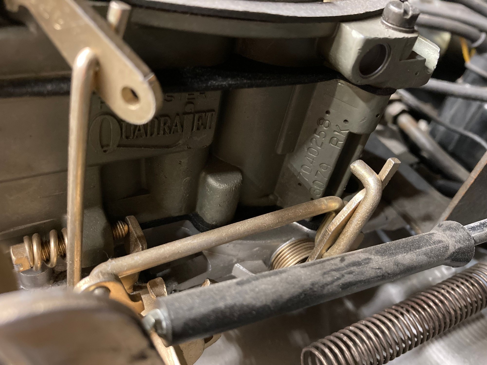

CARB: Quadrajet 7040258 3079 RK
Don't give up on the VIN Derivative block pad. Yes, it is difficult to visualize w/ the ALT brackets in place. A thorough dowsing of engine cleaner or oven cleaner + a long handle wire brush can significantly assist.
Nice car. Validating a W-30 almost always requires paperwork documentation but other members have more keen awareness than do I in terms of assisting w/ other mechanical forms of helpful validation. Speaking of which, here is an excellent thread to read through regarding your carburetor. MUCH can be gleaned reading this post:
7040258 (70 W30 Auto) Date Codes vs Vehicle Build Date

If the 01D was obtained from the cowl (data code) tag, it would be the 4th week of January, I believe. If so, this bodes well for the carburetor as has been suggested in the thread I provided to you:
3079 (Mon, 11-03-69) - 4th week of Nov 1969, 4th week of Dec 1969 (2)

OG is a 442 automatic transmission. It's not the W-30 version.
Did you typo your VIN? The 6th digit represents the model year. A 1970 hardtop 442's VIN should start 344870 with the 0 indicating a 1970 model year. You listed the VIN as starting with: 344872. This is an invalid 72 VIN as Oldsmobile used a slightly different format starting in 72.

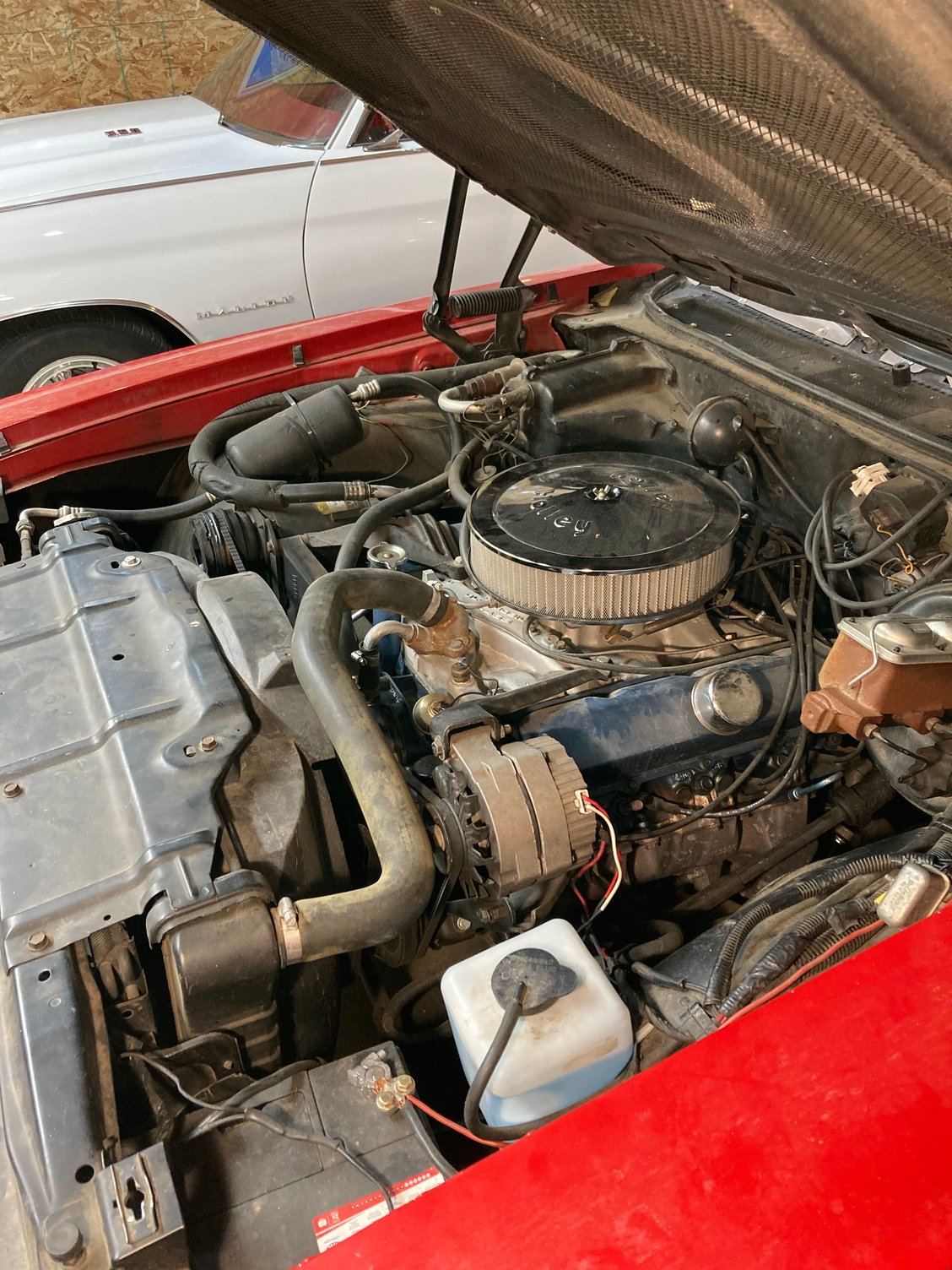

I like it and welcome to Classic Oldsmobile. Couple quick things. It has black fender wells and no W-30 holes. It also has non 70 mirrors. Looks like a nice solid car. I hope you enjoy it. How about some more under hood pictures. Especially the underside of the hood. Really looks like a great starting point. 👍
Old Oct 30, 2023 | 02:55 PM
I am putting my money on this being an original OAI hood. Original hoods "sag" on the sides like this. Nice car from here.

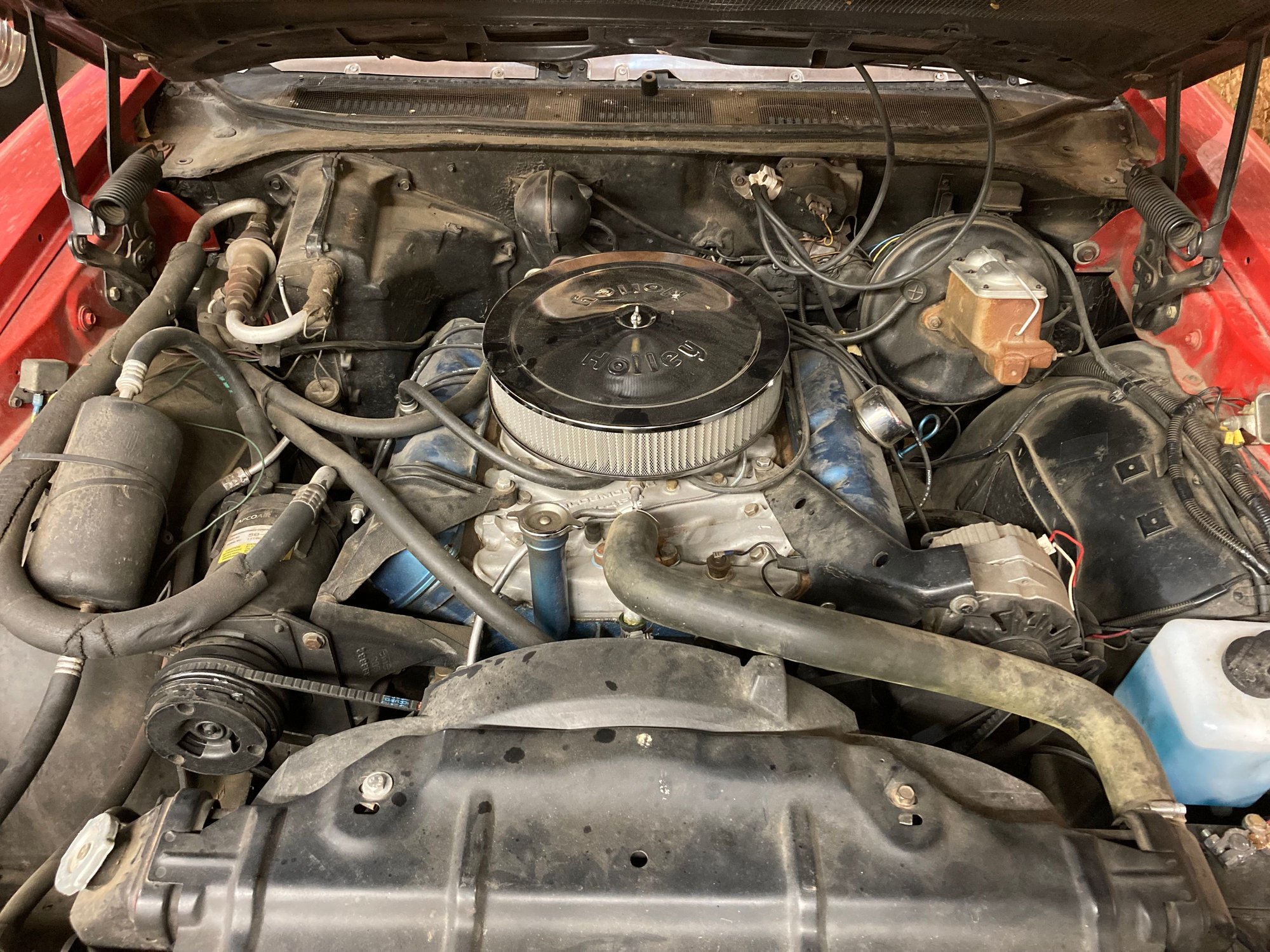

Ok, as requested I took a few more pictures. Feel free to ask for more. It’s still dirty from its trailer trip from another province and it has sat for years. I’ll get it washed this week and on a lift very soon.
So, from what I can put together searching around on this site (great site by the way!) is it has a W-30 carb, W-30 intake, W-30 heads, W-30 differential, 4 core rad, not sure of block stamp yet and trans is an OG - not an OW. Which is a shame as that would have been definitely the item that could figure this car out. How ironic it’s the only item that could be missing.
Those are leaves on the mesh of the hood and I swear I’ve bumped my head 10 times on the nose of the hood.

Check the VIN that's stamped on the transmission that may give you some more info. If it matches the VIN on the car then you can be pretty sure it wasn't a W-30

This is definitely the next thing to do. If that 'OG' trans matches, then the car's not a W-30. If it doesn't, then it might have replaced the original 'OW' unit and the game's still on!

I'm still learning as I go here - and you all have been great help!
I mean that the Code on the differential is stamped TM. I was under the impression that was a W-30 only rear? It does also have the W-27 cover. In my heart, it's unlikely that it's a W-30, BUT - it has W-30:
Carb
Intake
F heads
Exhaust Manifolds
Differential
Radiator
Seemingly original hood.
Missing though, are the trans and red inner fenders. I can't see VIN on trans yet as shifter cable bracket is in the way. Can't see engine VIN yet as ALT bracket is in the way - but when I take it in for a once over service, I'll get it on a lift and find out. If it's not a W-30, then someone went to a lot of trouble to find those parts and put them in.
If I discover that it's NOT a W-30, then I have a conundrum... do I make a W-30 tribute as I have most of the legit parts, or do I sell them for fair market value to someone that needs them and just make a great 442?

Well, it’s official - it’s not a W-30. I crawled under the car and took the tranny bracket off and checked numbers. The good news is the numbers match the VIN, so at least it has its original tranny.
What that likely means now is I’ll have W-30 heads, Carb, intake, exhaust manifolds and differential for sale sometime. I have a pic of the tranny numbers and the car all cleaned up before putting away for rest of winter.

What was the code on the passenger side of the transmission? On the tag? That would be OG if its a 442, OW if its a W30

This is the tag on the passengerside. I copied this picture from another member's thread.

John - What am I missing? OP states the above tag is from the RH side of the transmission (passenger side that would be). The tag demonstrates 70-OG = 442. I'm not an expert on this, but doesn't it suggest it is not a W-30 since the W-30 should be OW? Maybe I've lost my mind...
I'll just grab a cookie on my way out the door...😉
For some reason I can't see the photo with the tag. Just the one with the drivers side transmission. OK, that does confirm its a 442 but not W30. Sorry for the confusion!
