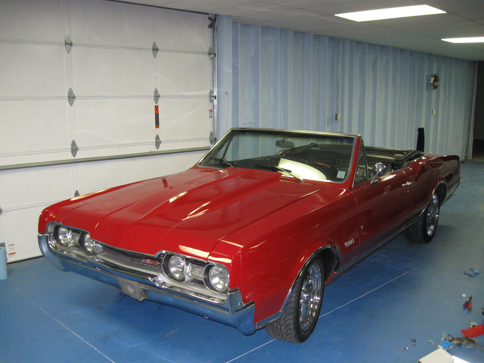

so I'm fixing up a friend's 442 that he just inherited. the guy that built it was into drag racing and built the car as such. my friend is just looking to drive the thing and put some miles on it.
here she is:
it isn't numbers matching and the interior is a mis-match of parts from that era, but if you aren't judging it for concourse points, it's a nice clean car that drives quite well.
