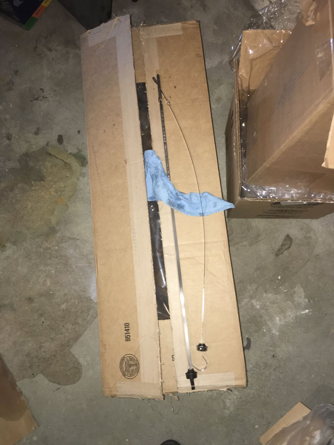

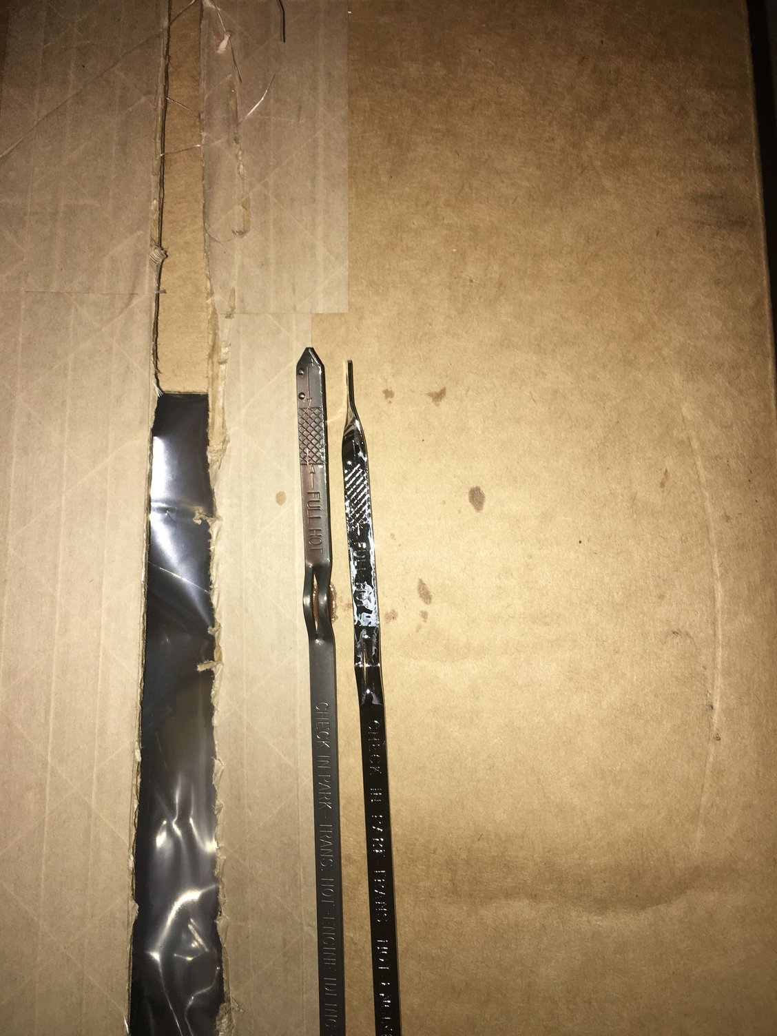

I have over filled my transmission with fluid and wanted to know the best way to drain it. I am trying to swap it with a newer shorter dipstick tube and need to be able to mark it accurately. However, I laid my new dipstick (on the right) side by side to my old dipstick(On the left) and although my newer dipstick is shorter in length the "full line" is actually higher than the old dipstick which is three inches longer.
Old dipstick is on the left and new is on the right.
My new dipstick tube is 27 inches long. I don't know the length of my old dipstick tube but the dipstick itself is 30 inches long. Also, I wanted to know what is the best way to mark a dipstick (permanent marker or engrave).
