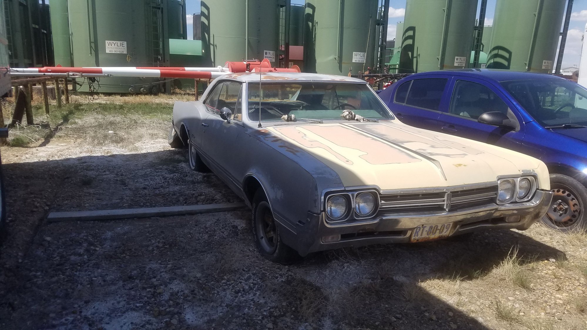

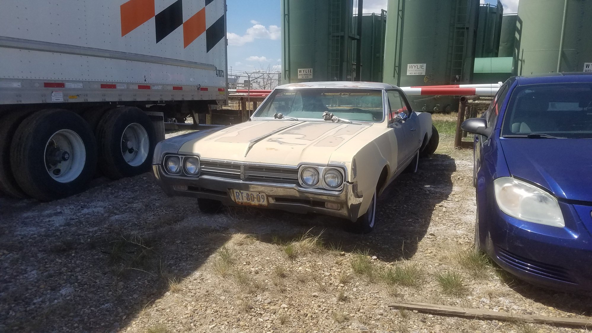

Pictures
Welcome to the site, let's see some pictures.
Originqlly posted on my computer, on my phone now so here goes.

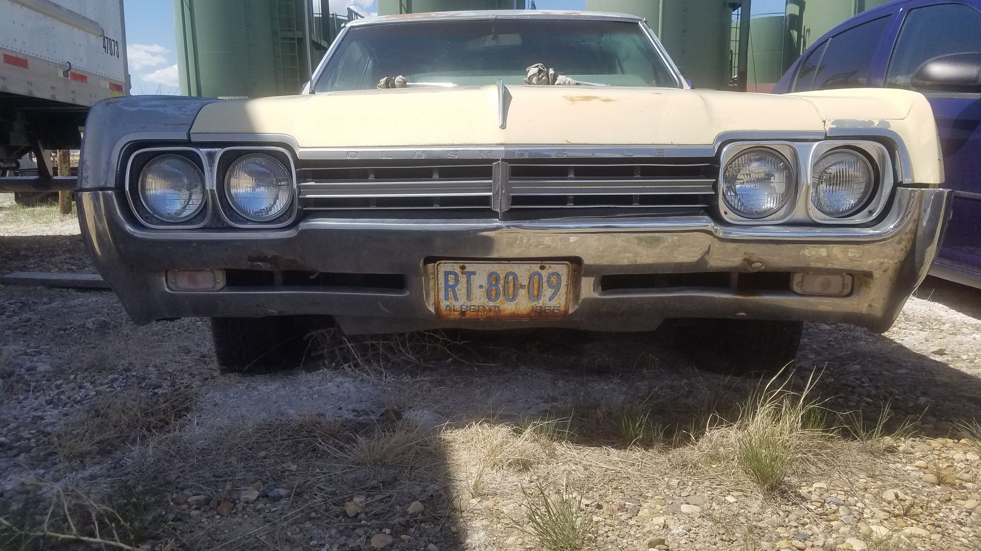

Front bumper is a bit bent and a little rusty but altogether front end is ok
Will have to take more pics but will need some right side sheet metal. Guy before me put in patch panels and didnt seal seams properly.
All the chrome is together, including all the drip moulding around the windows. Except... the left side is missing the wheel well and side chrome trim from another body repair, this one solid. Personally i dont mind the look without it. Its like playing dressup and pretending i have a 442.

Welcome aboard! Looks like she has some pretty good bones! The 330 motor is mostly overlooked but has great potential. If you go camshaft shopping be careful to verify the lifter bank angle in case the motor has been changed by some previous owner. The 1966 and earlier 330 blocks are 45 degree angle; the 1967 and later Olds motors are 39 degree. The transmission if automatic was a two speed Jetaway (not the same as a Powerglide) with variable pitch torque converter.
