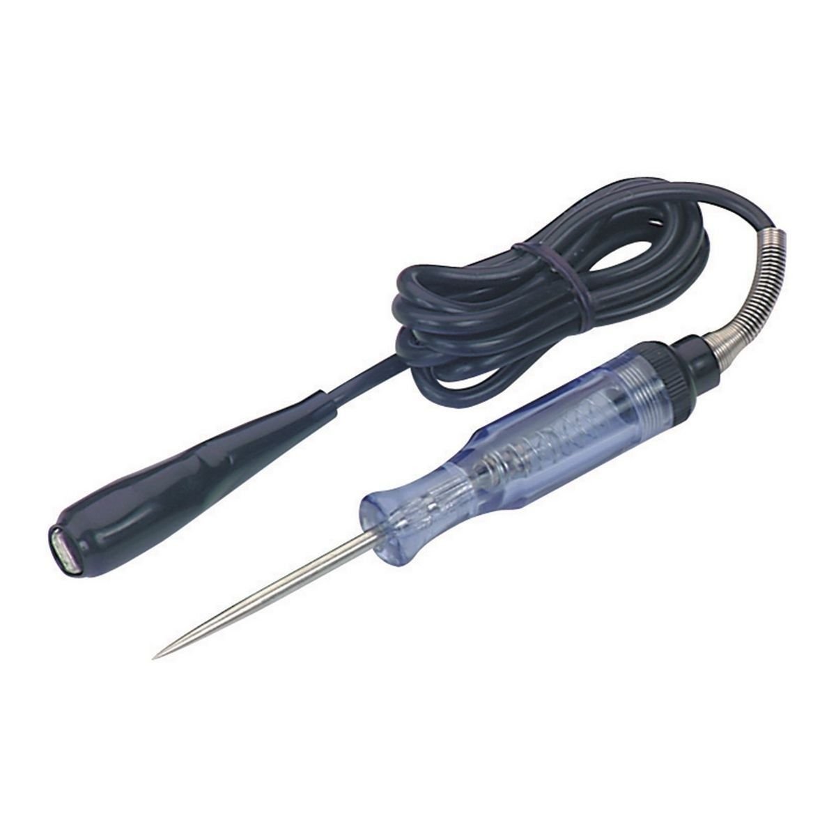

I don't wish to throw a wrench into your troubleshooting procedure; yet, I don't want you to just toss a part at this and find out it wasn't the switch. Removing the switch is not fun, replacing the switch is not fun. IMO, I'd first perform the test(s) as Joe suggested (unless you really just want to spend the afternoon removing the switch if you have nothing else to do). Use a simple test light and ensure you have POWER on both sides of the FUSE and at each wire. Then, you'll know if it's worth the bother to R&R the switch. If you have no POWER on both sides of the fuse, then the switch isn't your issue.

In case you're unfamiliar with a simple test light. You can pick one up at any automotive parts store for generally <$10. Saves tons of time deciding if you do or you do not have power (the first order of business).
