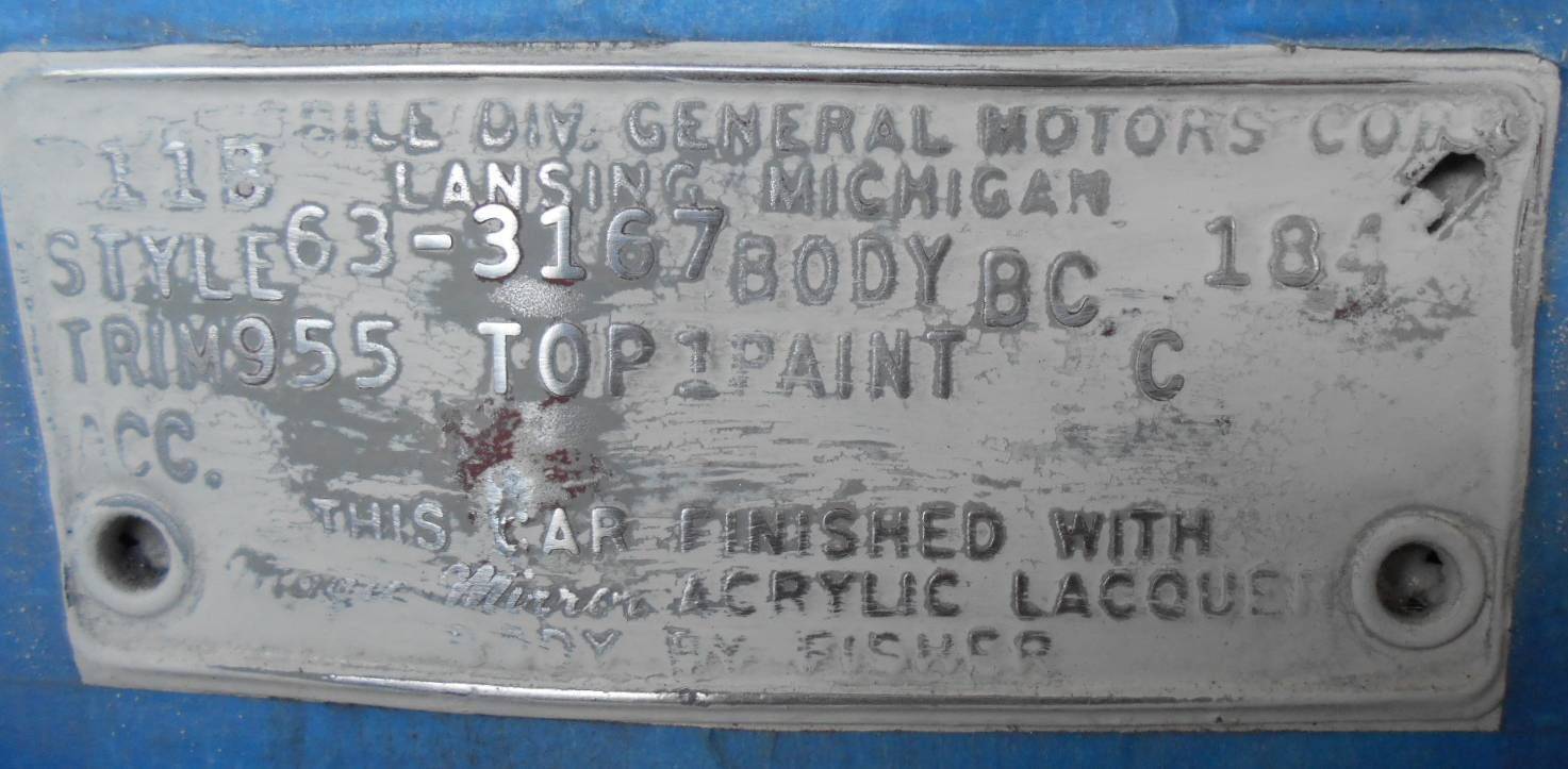

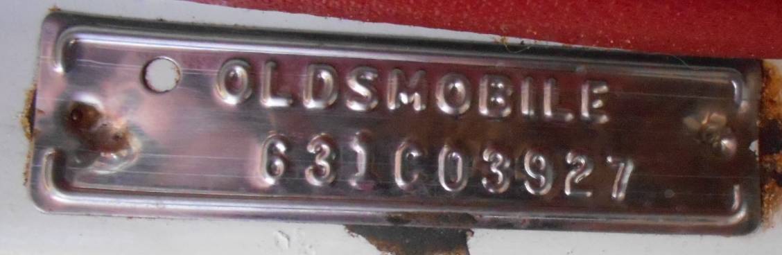

Hi Joe, yes I bought the car in the Palm Desert ad. Yes the gauges will be coming off of the instrament panel hood. The car is primered over the original paint. the underside of the car is so clean it is unbelievable. The intererior is original although the seats will have to be redone the rest, panels front and rear can be saved. The top is history. It looks like it may be an original 4 speed car, it has the center console. I posted pictures of the ID plates if someone can decypher them it would be a great help.

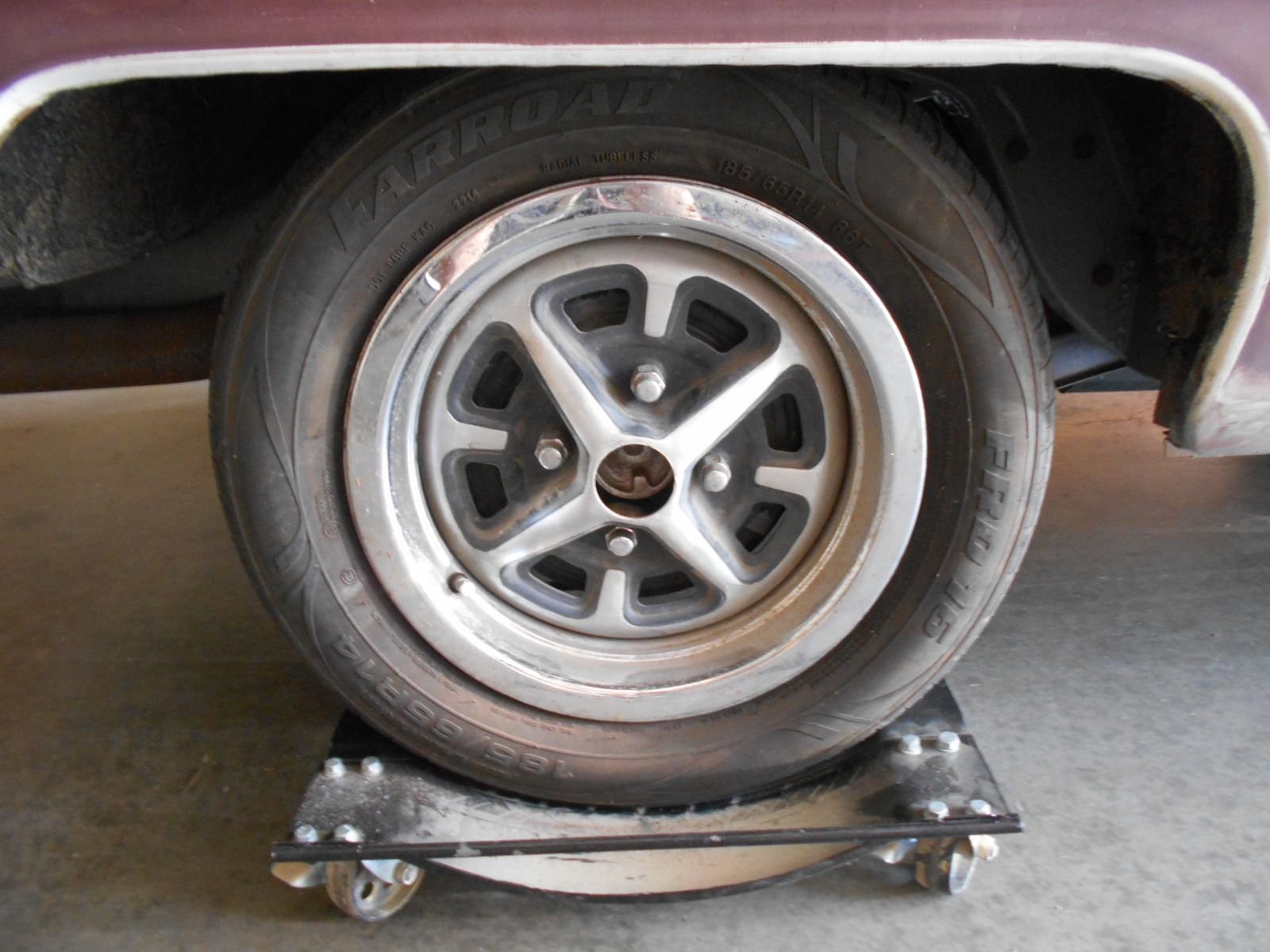

Does anyone know what these wheels are? 14" four lug pattern

Wheels look to be from an M.G. I hate to tell you that console is for an automatic I think that car new was a column shift automatic

Thanks for the info on the wheels, I will look into it.
An MGB to be exact.

Can you figure out the Data Plate?
Style 63-3167 I think this means 1963 car
Body BC 184
Trim 955
Top1 Paint C I think this means Provincial white
Old Jul 19, 2018 | 08:32 AM
Ancient Iron's Avatar
Joined: Apr 2010
Posts: 530
Style:63-3167 63-1963 31-F-85 Deluxe -67 convertible
Body BC 184 Southgate California assembly plant
Trim 955 red
Top 1 Conv. top White
Paint C Provincial White

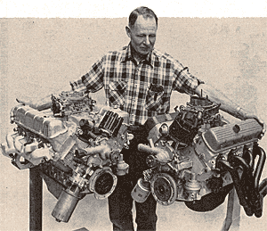

Is that a Buick V6 in the 63 as I see the distributor is in the front.

Nope.
The Olds 215 is based on a Buick-sourced design, which shares architecture with the V6 and small block Buick families. Olds used a specific block and pistons, and the heads and valvetrain are unique to Olds. In this photo, the Olds 215 is on the right, Buick on the left. Note the different shapes of the heads and valve covers.

11B: 2nd week of November 62 build

Oh right! I was thinking Olds had dropped the 215 for the 330 in 63 but it was 64 wasn't it?
