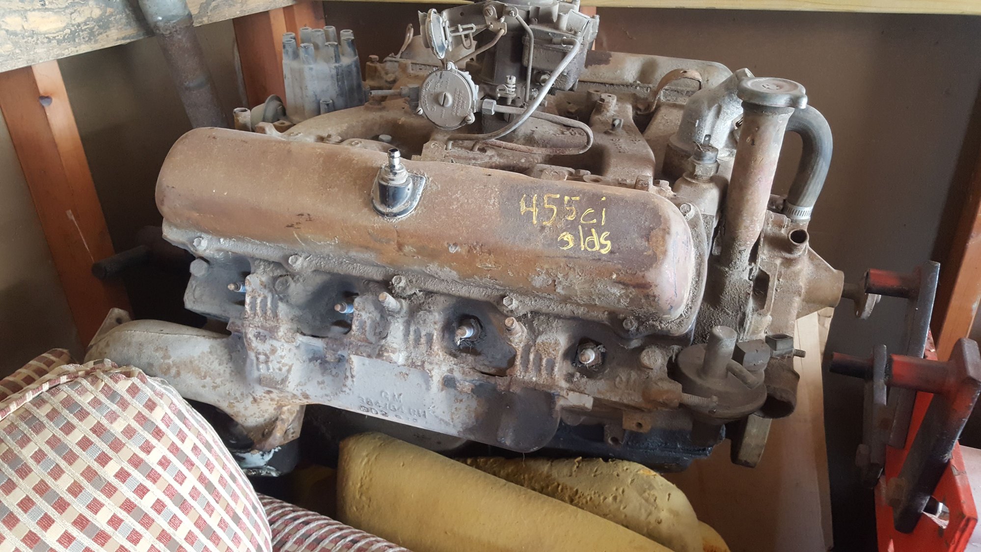

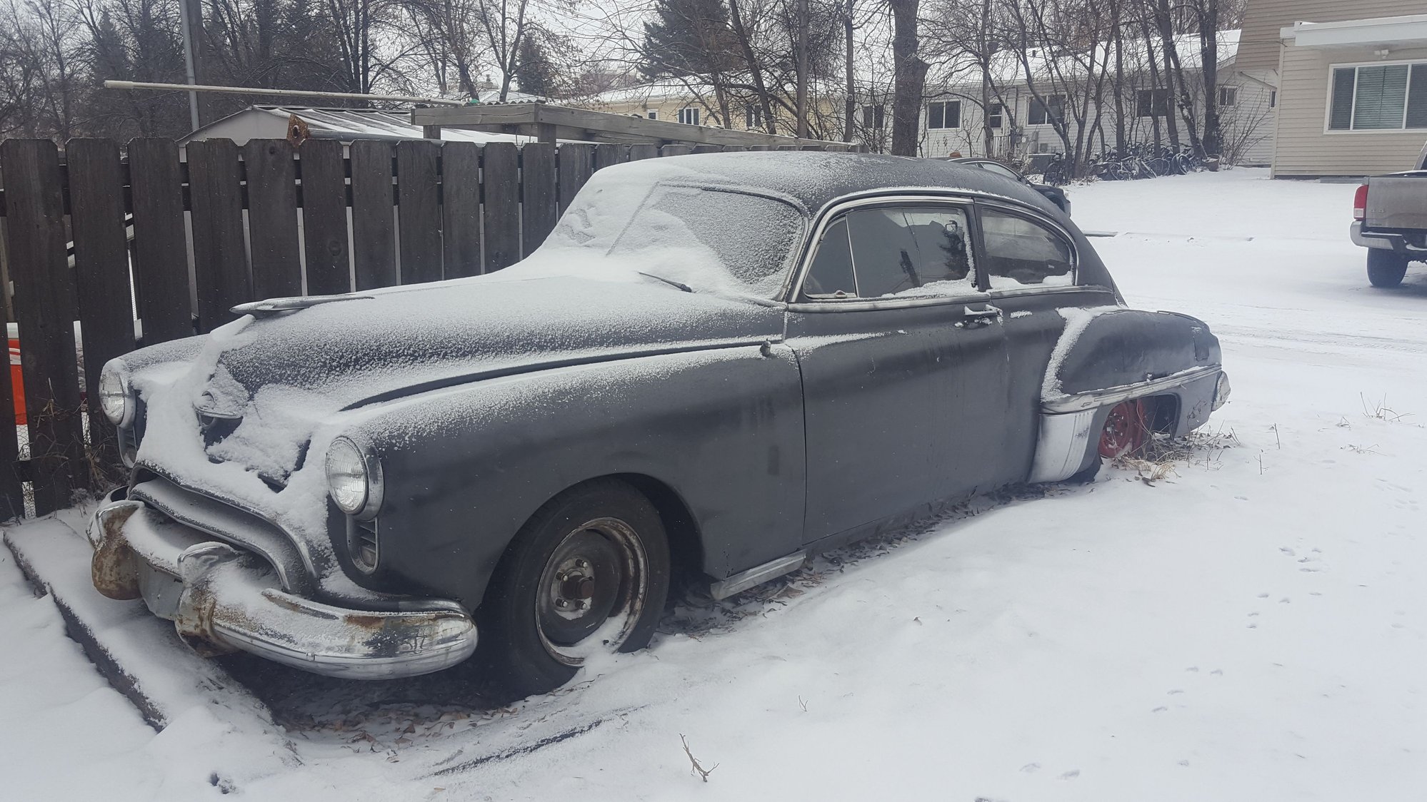

I have a 1949 fastback 76 that i am planning on dropping a 69 Delmont 455/th400 into. I have the engine and trans, and engine mounts that supposedly bolt the whole thing up. Is there anything i should be aware of? The mounts are from a 1954 88 with a 350 swapped in that i found in a junkyard, and the transmission mount is from a guy who did this very swap

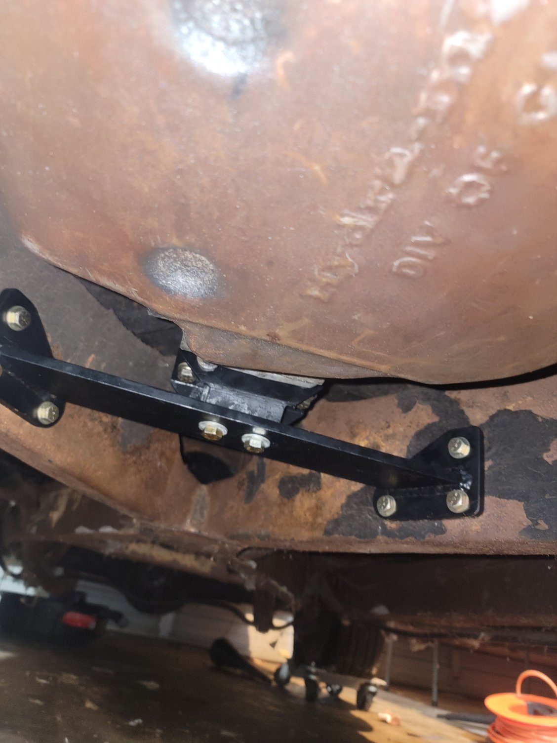

I just thought of 1 more thing. The mounts shown in my first post on this thread, bolt to the side and front of the motor. The transmission mount i have is for the tailshaft. Do i need side mounts? Or are the front mounts enough? And does anyone recognize where those engine mounts came from anyway? Certainly not stock for 54!

Think in terms of a triangle for mounts to minimize engine/transmission rotational movement. While you have two mounts on the front, they aren't very "beefy". Two engine mounts on the front and one on the tail shaft mount will work.
........Just my two cents worth.

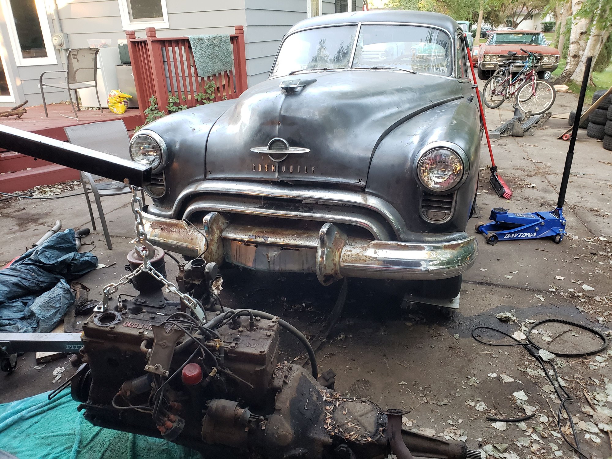

Finally got the old straight 6 and 3 speed out!

The stock rear will work great. the problem you are going to have is axles. the 10 spline just don't hold up. they twist and eventually break off.
you will have no problem for a while. Brake stands and hard shift 1st to second shifts will catch up to you.
I'm with you on the very front mount all the way to the trans mount. I used flat stock weld to the cross member with a tube welded on the plate, back to the second mount holes on the block.
I used motor mount #2261
That carries the weight of the engine, takes the weight of the trans bell housing.
I converted mine to late model power steering. I've seen some make brackets from the frame to mount rack and pinion.
What are your plans for the six cylinder. I would like just the cylinder head. It would be very cool as wall art.
Good luck. It will be a test of your welding skills.
Gene

in the pic of when you got the mounts, look like a brkt came off the frame towards the engine.
You understand what I was saying about making brackets from cross member to the middle mount holes on the block.
do you have a pic of the trans crossmember?

Progress Update!
I did a compression test on the 455, no compression in 2 cylinders. Checked inside and yea its gonna need a full rebuild. So i went and got a 350 (Olds of course!) to bolt in for the meantime. With the custom mounts id miraculously found over the last 2 years it went very smooth! More updates to follow hopefully this summer!

I suggest you make sure the drive shaft will not hit the “X” member when you lift car and the rear wheels are not supported
i did the same on my 50 Olds coupe. The short shaft T350 , when I lift the car on my lift the drive shaft hits the cross member. I think if you use a long shaft T400 would fix the problem.
I have to disconnect the drive shaft before I put it up on lift. I found out the hard way, Bent the drive shaft just little dent, but had a vibration.
I would suggest a mount of some type attach to the bell housing of some type. The way you mounted, that is a long distance to be unsupported . The original set up had a front mount and a mount at the bell housing to carry the weight.
maybe use the factory cross member with metal bolted to where the trans is bolted to the engine and down to the cross member. Just my thoughts.

I had to use a th400 short shaft to make it fit, otherwise the yoke wouldve been nearly inside the x member. But Ill double check to make sure the driveshaft doesnt hit the x member before i finalize it. also, I think i will put some mounts for the trans bellhousing for more side-stability. looks like something i will have to fabricate
