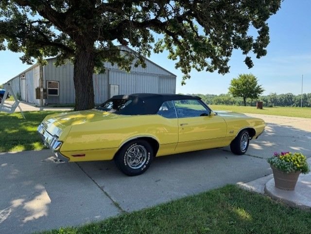

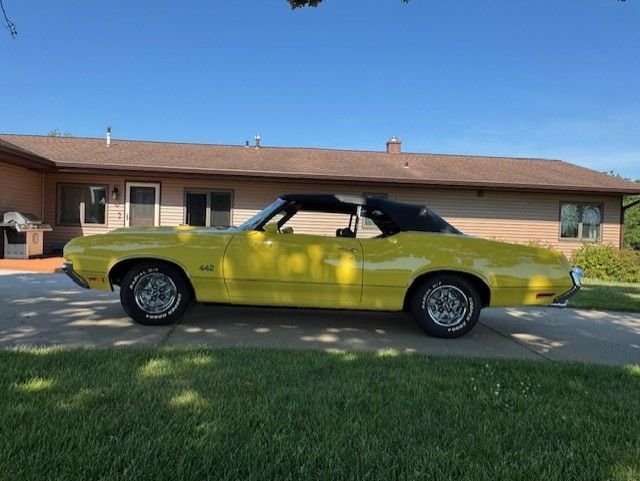

Old Jul 3, 2025 | 11:33 AM
  #147
Jacoz70442's Avatar
Joined: Aug 2010
Posts: 266
From: Fox Valley, WI
Ok, so....this has been a very, very long time coming. She's finally done(well, like anything we have, there's always something minor that crops up, but no big challenges"! as you can see from where it's come from it is a gigantic leap to here. So many hours, back and forth with parts, things that need adjusting and the list goes on. It's been in my hometown for the entire time and it's a 250 mile round trip when I was able to get back and work on it; hence, the long time to get here.
The great part is I was able to work with my Dad on it the whole time. That always comes with some challenges with a father/son build...HA!. What a rewarding experience! We took it to a show in Janesville, WI this last weekend to finally get it out. I honestly just wanted to drive it and be able to have people see these things. There's always more Mustangs, Chevelles, and more but these are just so right with the lines. Anyway, I actually won best Olds in the show. I was just happy to drive her and get the enjoyment of having something we worked so hard on get to see the light of day again. I'll post more pics later with the top down and out around. It's now in the Fox Valley area in Wisconsin so maybe I'll see some of you around! Have an enjoyable and Happy 4ith of July. I hope this gives someone the extra push I needed at times earlier on. Thank you for all the help, recommendations and more during this process!
