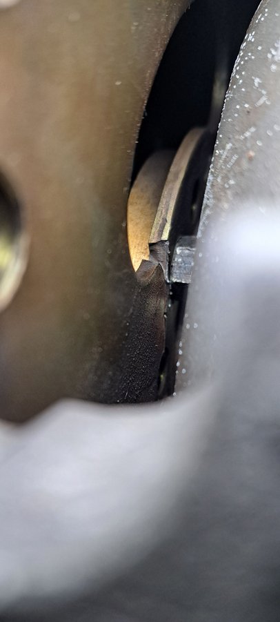

I took a few videos, it really does sound flex plate related but may be detonation. I will check the actual crank to flex plate bolts. It may be this Speedmaster flex plate. I don't think anyone else has a neutral balance flexplate for a 330 crank. Just weird it gets quieter, the longer it runs and timing drops. Running 91 Octane, the last of the non ethanol available, now will all be 10% with STP additive and stabilizer.
https://youtube.com/shorts/M4QeR9zFC...UOVN5j1PuHqCuV
it’s also making the noise during cranking. pull one plug wire at a time to see if the noise changes when it’s at its worst . to me it’s a mechanical rotating assembly knock .

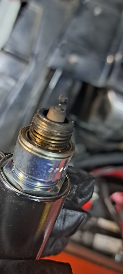

Pulled the plugs, they all looked like the same. It definitely sounds external or totally different that the last few rod knocks my Olds have developed, almost tinny in person. If the motor isn't screwed, I am considering going to my Qjet, Performer and manual control of the 4L80E and putting the Terminator X Max on my Dakota, for a few reasons on both vehicles. I had to move it to put the Dakota in the garage. I finally changed the Dodge factory tiny 6 gauge battery cables to 1 gauge cables. It didn't like -40 despite a 850 CCA battery, factory mini starter and our Coop full synthetic 0W30. Even they look tiny compared to the 4/0 cables I put on the Olds. We have a snow storm coming, other than moving snow tomorrow, I plan on a more through inspection tomorrow, including disconnecting the torque converter, running it disconnected and really inspecting that area. I have never seen a real knock go away after initial start up, usually the knock gets louder as oil pressure goes to nothing, not 40 psi at 750 rpm.

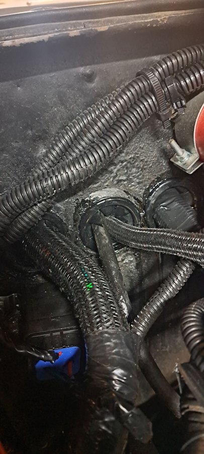

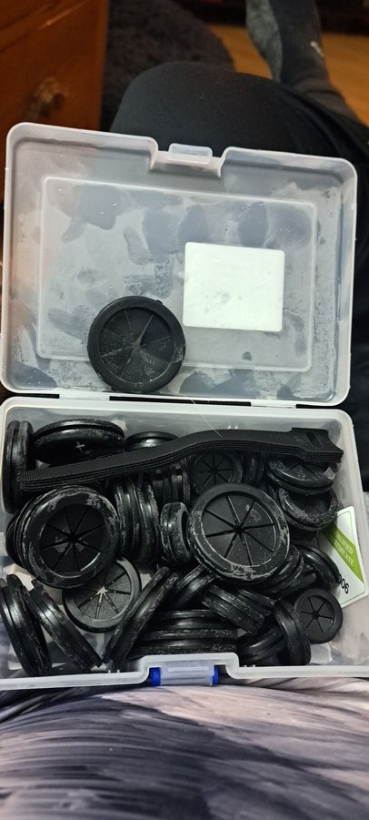

I received my grommets last night.

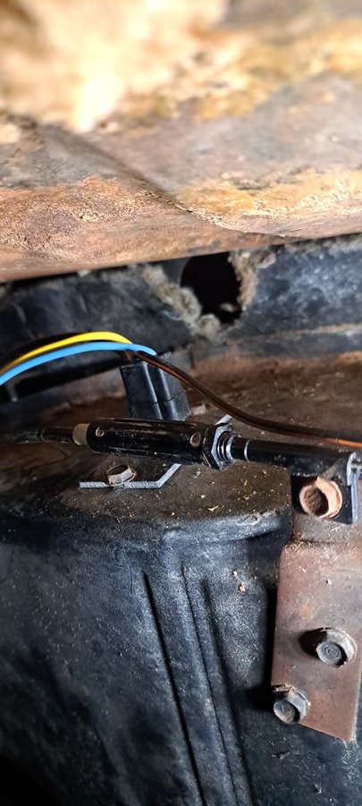

I am going to find a spot on the passenger firewall to drill a 1.5" hole to route the Holley Terminator X Max wiring through the firewall and mount the ECM in the glove box. It will just look so much neater. When I drop the 4L80E to replace the flexplate, I need to clearance the floor pan more for the cooler lines, some dimples, still super tight. Also now that the 68cc Olds Edelbrock cylinder heads are finally released, I need a set! When I put this motor in the car, it was all put together to easily add these heads. For example, I used RTV only on the block side for the pan gasket, same for the timing cover gasket. I have all the gaskets, including Mr Gasket MLS 4.100" head gaskets going on, if the other gaskets do get damaged on removal. I also have a Cloyes 9 way billet timing set, thrust button, Lunati custom 218/218 on a 112 LSA hydraulic roller cam, with the Harland Sharp roller rockers made for these heads in a 1.65 ratio, .541/.541 lift. Also the ridiculous expensive Comp Evolution hydraulic roller lifters, hopefully the live up to the name. So only the only thing needed besides heads, is push rods, have a checker push rods. These new heads will put me at 9.4 to 1 fine for any octane but will continue with non ethanol Premium 91, should be in 400 HP range with the cam swap and more importantly 450+ ft-lbs probably, not to far off my 2100 stall. Exciting, need to make it happen.

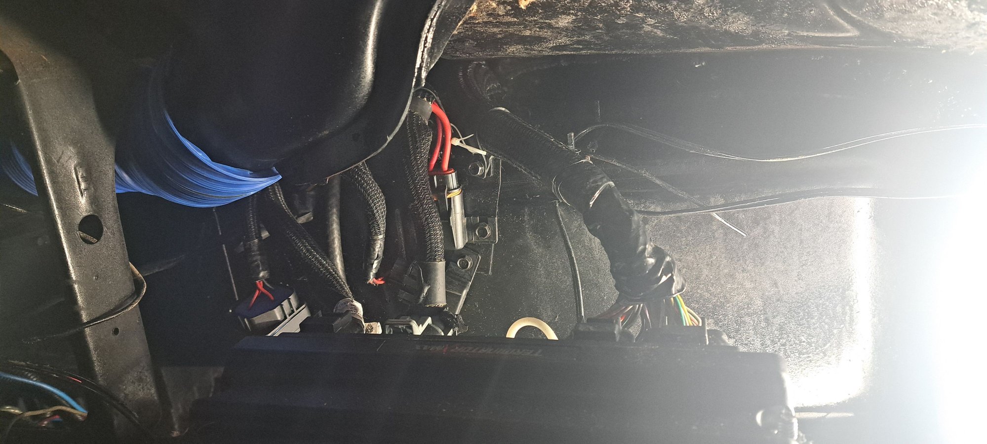

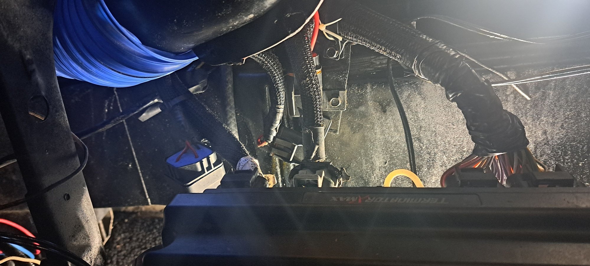

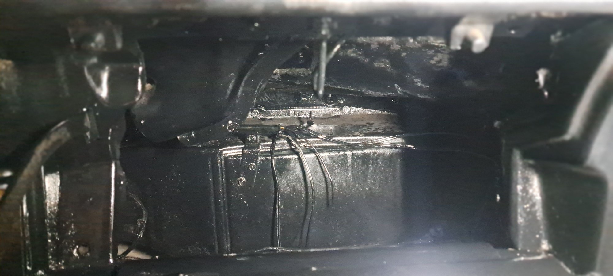

Well, I started moving the Terminator X Max inside the car. I just removed the glove box liner, didn't really use it and, drilled two holes and bolted it in the liners place. When I pulled it out, I realized, I didn't completely remove all the mouse house up in there. I scraped, vacuumed and hit with Spray Nine then painted. I expanded the original heater wire grommet hole to 1 3/4", the 1.5" ID grommets that fit the hole just fit the Terminator big connectors and relay connectors just fit. I added a second hole beside it the same size, plenty of wires to come inside. Also sprayed Tremclad professional gloss black on all the rust.

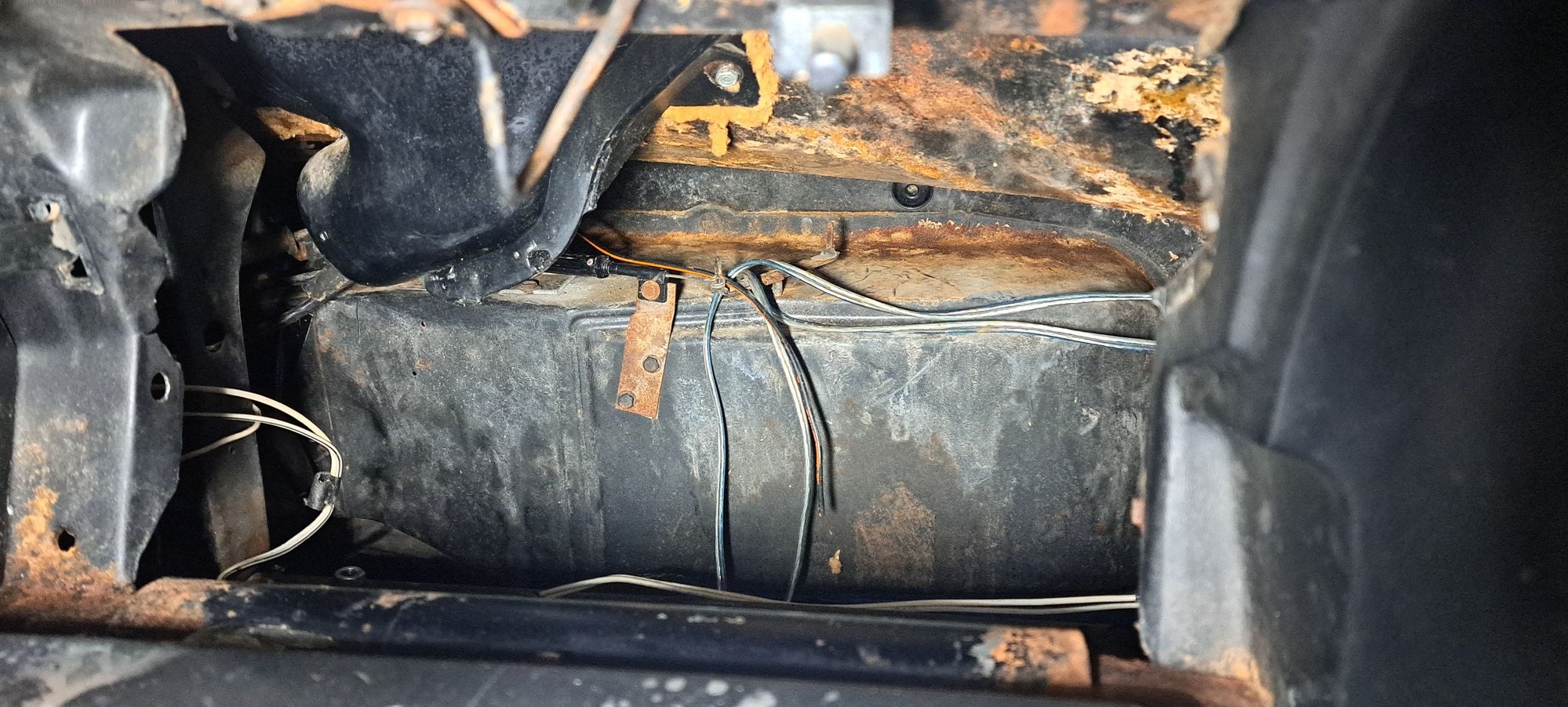

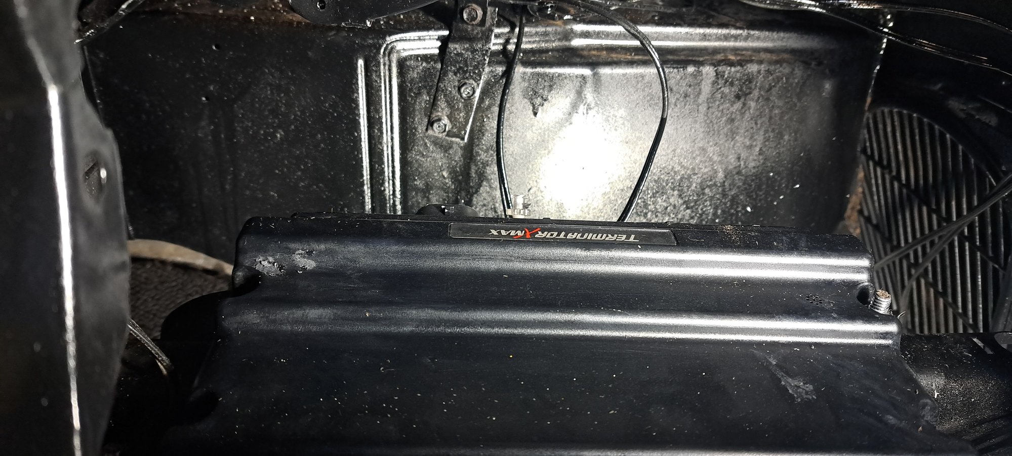

Ok so I got the Terminator X Max and all it's wiring moved. I needed three holes with 1.75" OD/1.5" ID grommets to fit all the wiring. It is neater under the hood but far from perfect. Good lord is there a ton of wiring between the EFI, ignition box/distributor, fuel pump and the trans harness. Also sending money to Mark to get a set of the new Edelbrock heads and a new neutral balance flexplate.

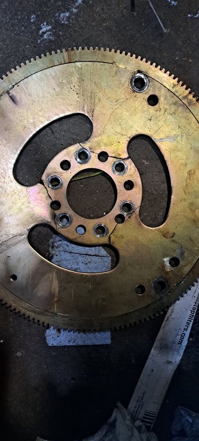

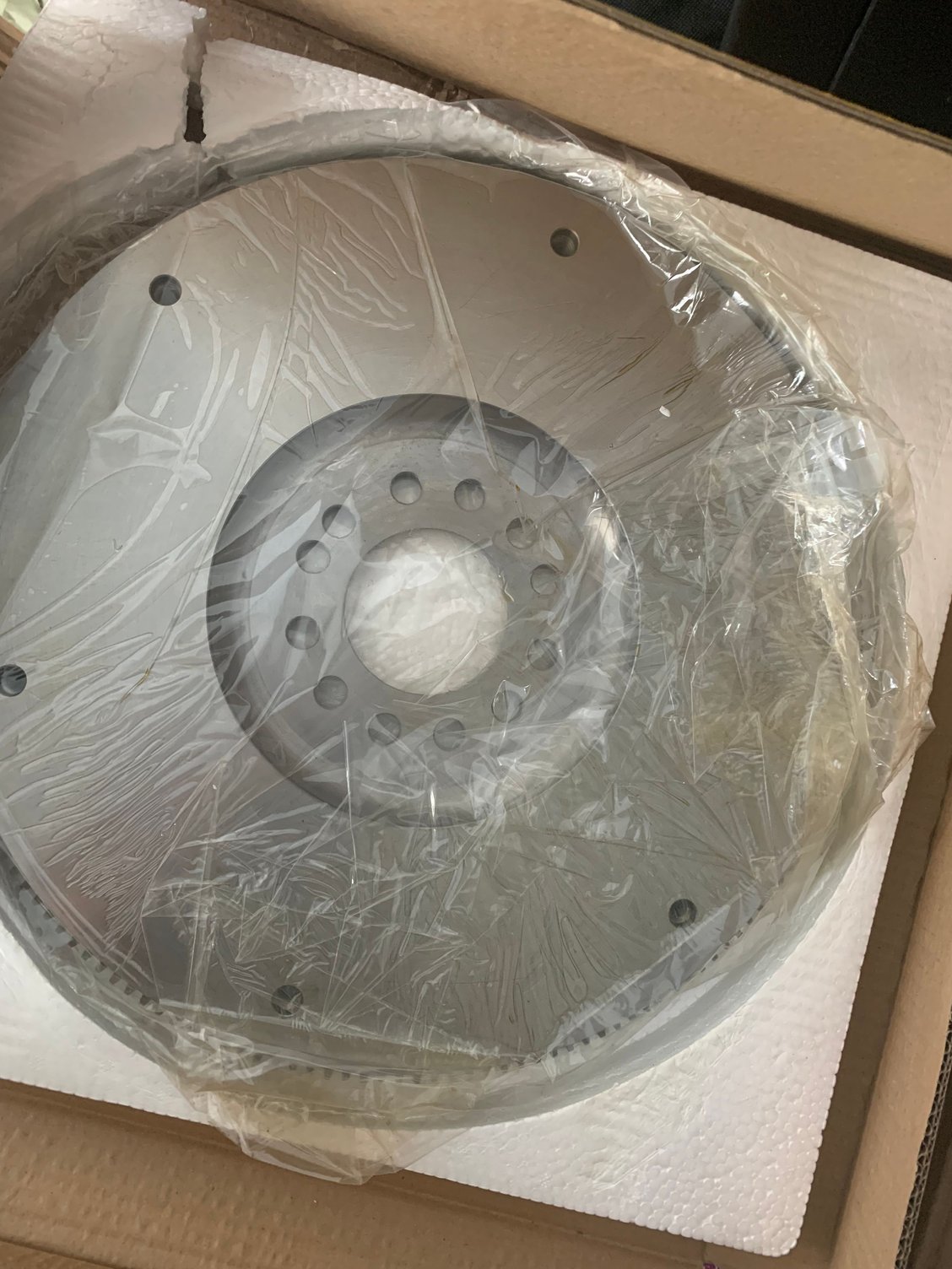

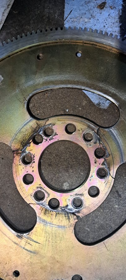

Ok, so I was going to buy the US made ATI flexplate. Despite being supposedly checked for balance, obviously not very well. Cutlassefi and others have had issues with them not being neutral balance out of box, double digit ounces out. So I sent Mark some more money for another Speedmaster neutral balance flexplate, that has been checked. If Dale and Mark don't have issues with these flexplates, good enough for me. I also ordered six All Star Performance 1/2" longer dowel pins. Also have 50% down on the new Edelbrock 68cc heads, hopefully mid February they are ready to go. Going check all fitment on this new flexplate and add even more cooler line to floor clearance when I drop down the 4L80E. It is nice to finally have an automatic not covered in it's own juices.
Old Jan 18, 2025 | 12:08 PM
  #313
CANADIANOLDS's Avatar
Joined: Sep 2013
Posts: 2,912
Ok, so I was going to buy the US made ATI flexplate. Despite being supposedly checked for balance, obviously not very well. Cutlassefi and others have had issues with them not being neutral balance out of box, double digit ounces out. So I sent Mark some more money for another Speedmaster neutral balance flexplate, that has been checked. If Dale and Mark don't have issues with these flexplates, good enough for me. I also ordered six All Star Performance 1/2" longer dowel pins. Also have 50% down on the new Edelbrock 68cc heads, hopefully mid February they are ready to go. Going check all fitment on this new flexplate and add even more cooler line to floor clearance when I drop down the 4L80E. It is nice to finally have an automatic not covered in its own juices.
have a close look at your busted flexplate to see if it needed anything added or taken away to balance it to your neutral internal rotating assembly.
if it’s untouched, with just the external weight removed, then I would install the new one with no worries. if it’s had some work done to it, then call the place who did your balancing to tell them you’re changing your flexplate and want the new one matched to the busted one for balance.
they should keep your balance spec card on file and have given you a copy…just for this reason.

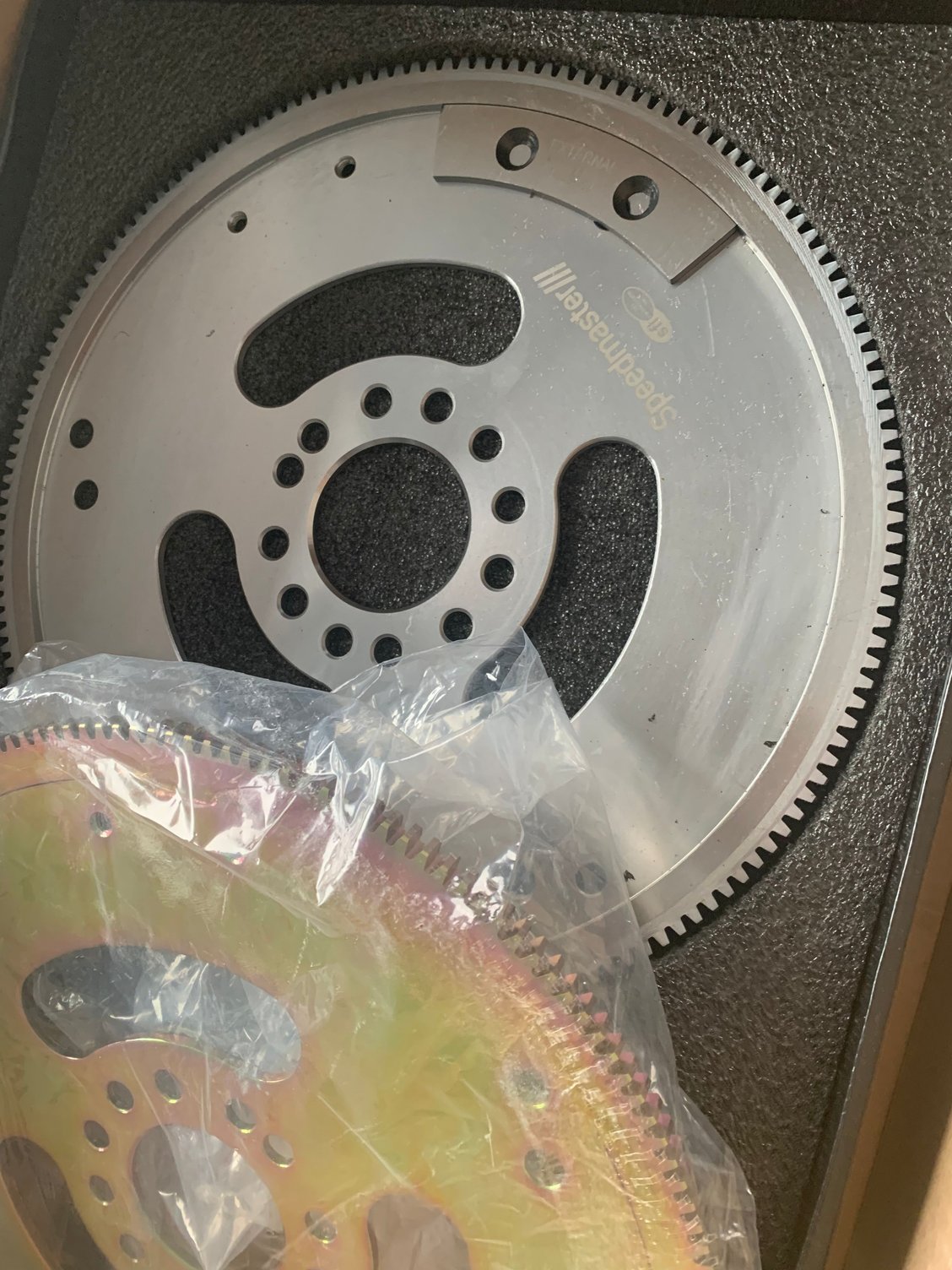

I received my three speedmaster Flex/flywheels I ordered. I have another four coming of the non SFI flex plate type. For $23.00 U.S. you can’t lose. I’m not screwing around with 50 year old stuff that has chewed up teeth or is bent.
these $23.00 ones are super thick at .190”
that’s thicker than the old Diesel ring gears which I use to collect and use for extra insurance..stock gas flex plates are really thin

Yeah, the flexplate is toast, broken all around the bolts. Mark is supposed to send me one next week.

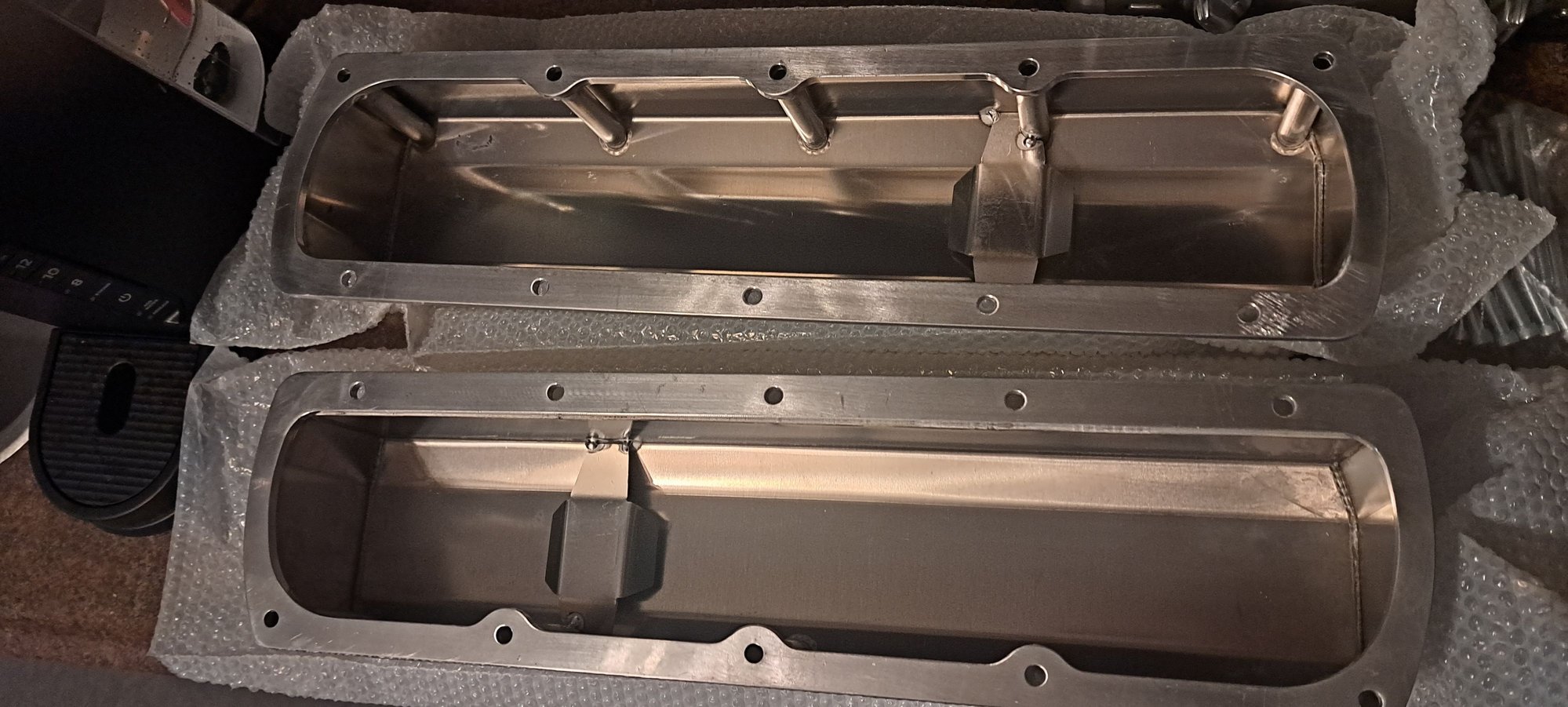

I ordered a set of the aluminum welded valve covers with breather holes. They should provide slightly more clearance than stock. I like the separate outside ledge on the bottom. I also ordered the Transgo 4L80E HD2 shift kit, while the trans is out. Mark is supposed to send my flexplate this week as well.

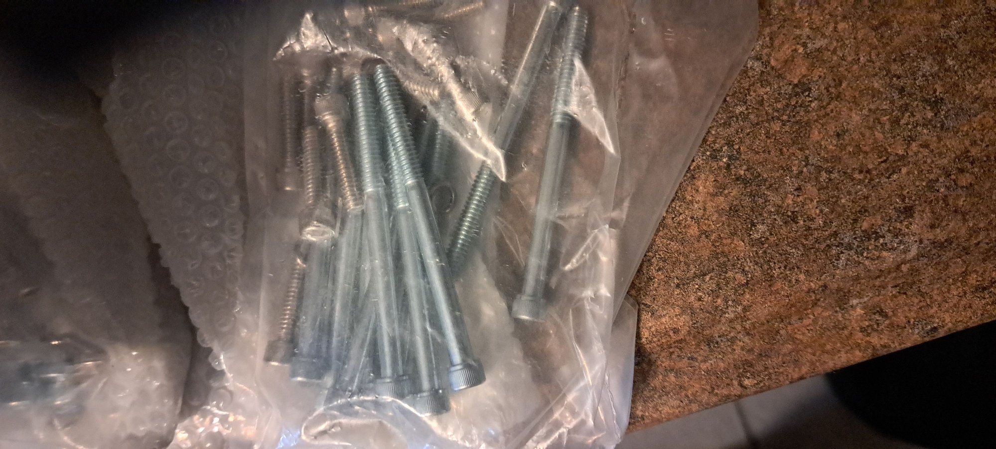

olds 307 and 403's Avatar
Out of Line, Everytime😉
Posts: 10,054
From: Melville, Saskatchewan
So these arrived, Peyton's covers are super nice but triple the cost. These look really nice along with the welds, I like the short outside edge. The baffles look good and they fit 1.25" grommets. Similar height to stock covers but gain from the shape and no recessed gasket ledge.

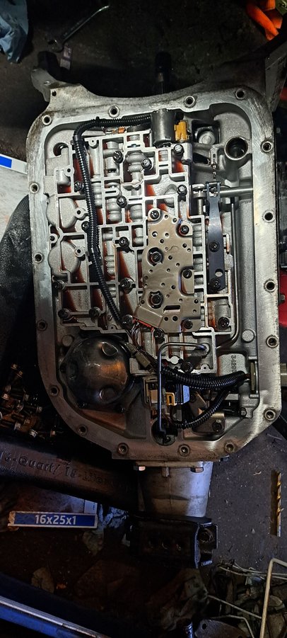

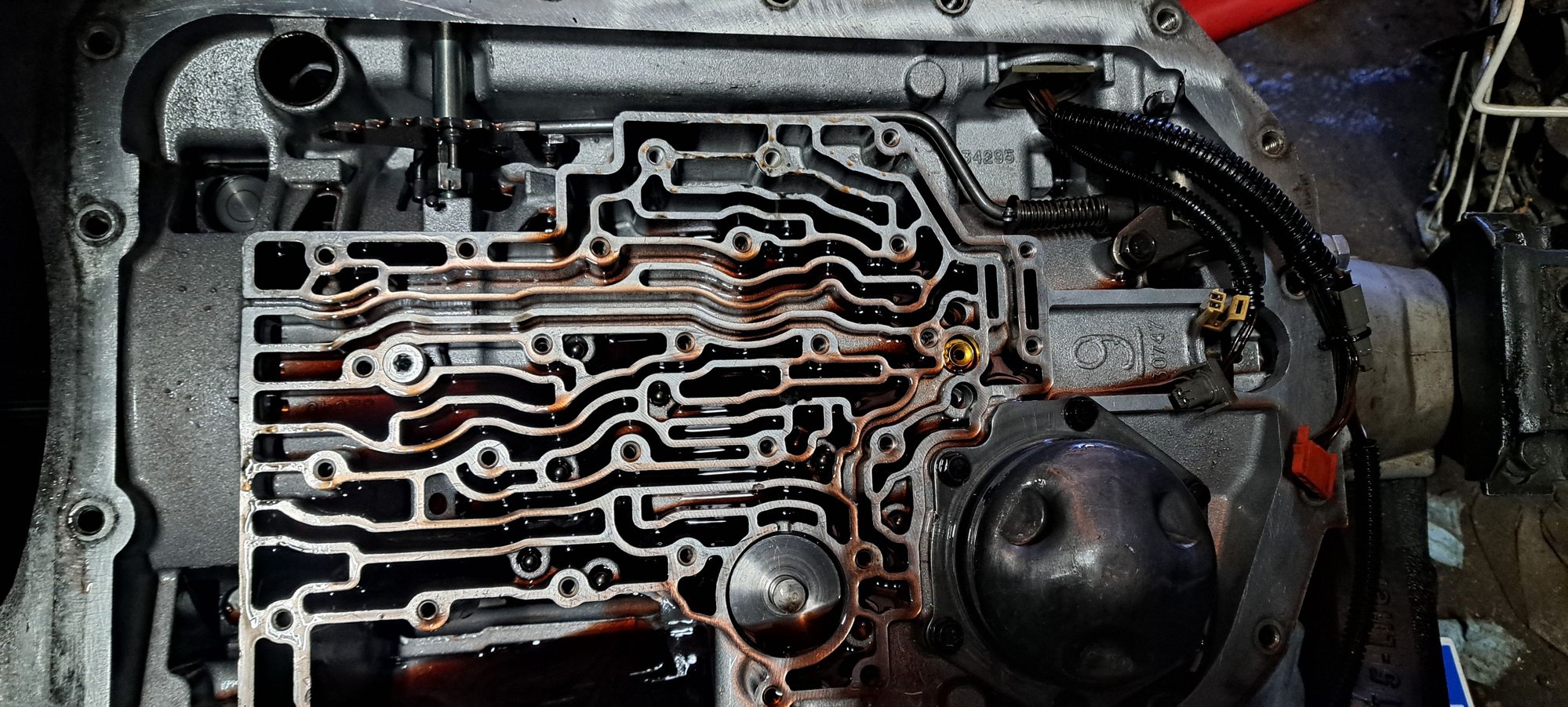

Ok, so I installed the the Transgo 4L80E Transgo HD2 shift kit. The good, it comes with a new seperator plate. You do have to drill two holes, pressure relief and you actually add a spring loaded pressure relief valve and plate to the actual valve body. New bigger boost valves, stiffer springs, not only for the line boost but for the accumulator overall and 1-2 and 2-3. The bad, it could have used a 1-2 accumulator O ring, since it needs removed to change the spring. Mine was stretched, freezing didn't help enough and actually caught and pinched itself. It seems to do the job sealing, still but may pick up a sealing kit. There was a small bit of dirt or clutch material in the pan and the valve body. I used a shop vacuum then carb cleaner and rag to remove the drill shavings and dirt. See if it is any different. Was barely noticeable part throttle and firm at WOT. I set it at the base level, tweaked with accumulator springs, two vs either one large or small for firmer and very firm.
I test fit the replacement flexplate Mark sent me, fit as it should, torqued to 60 ft-lbs. I was going to pull the adapter and remove dowel pins to install longer ones. First bolt came out, second would not come, broke the bit. So to extend the dowels, I put hose over the dowels and used JB Quik Weld. I will make sure the flexplate bolts to the torque converter before snugging down the bell housing bolts. Will get the trans reinstalled and hopefully ran through gears this weekend.
