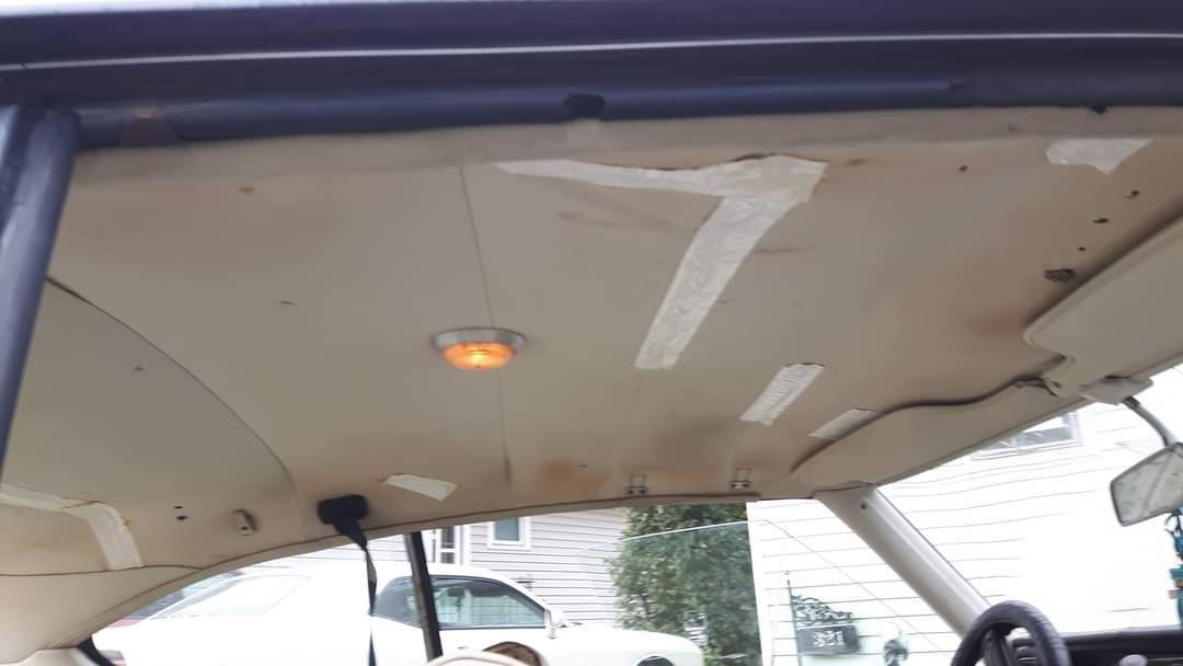

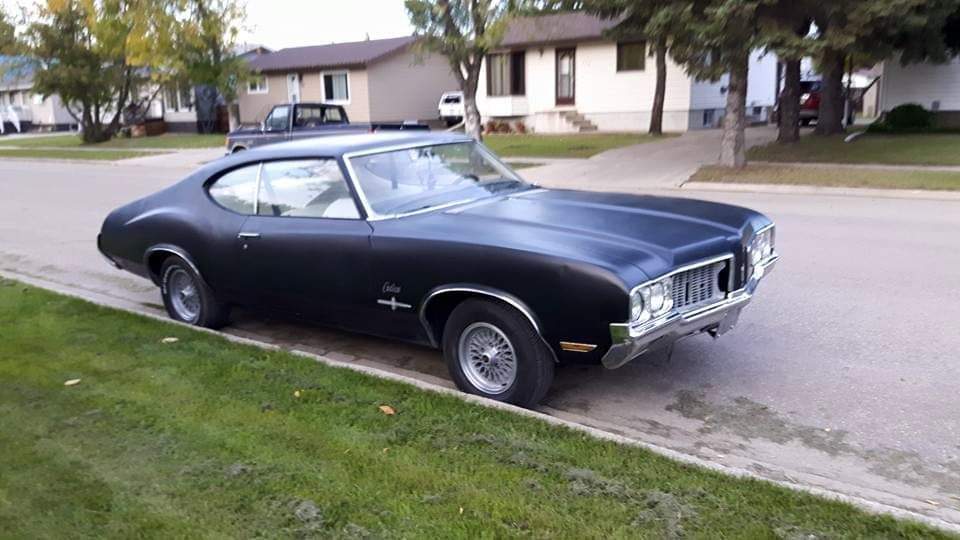

Okay, time to actually put up a build thread. I have had this car 5 years and I have done and will be doing major work over the next two years. One of my 350 blocks is waiting in line at the machine shop. Cutlassefi is picking compression and cam to run on 91. With the 3.5" stroke 330 crank, Scat rods, custom 1mm ring pack Mahle pistons, 450 hp/tq should be attainable. I am custom tuning the 83 Qjet for it. I have probably rebuilt at least 5 of these 80's Canadian odd ball carbs, sbc, Olds and Pontiac models. I doubt anyone on this site can say the same. This is the first major idle circuit mods I have done, following Cliff's book and using his high performance kit. I am also rebuilding and majorly upgrading one of the 3 TH2004R trans I have. This is 87 core, it functioned fine except delayed engagement in forward when cold and pump buzzing. Here is how it looked when I picked it up, very rough but paid $1500 for it.
I threw some bondo in all the rust holed and semi gloss black on it.
The interior was a mouse filled mess. I had to rebuilt the passenger seat cushion and remove all the mice skeletons. They got into the headliner. Putting up the bow style headliner was different than the later style of stick on headliner. PUI's online catalog was pathetic and very difficult to decipher. That is how I ended up with the right colour cover but was not the head rest model but it worked.
Took these two today at work, since this is my daily driver.
Current tired 73 350 with 70 heads and a serpentine belt set up.
All 4 quarters and door skins along with a 3.90 posi to replace the 2.78 open in the type "O" bolt in axle rear. Both planned for next year. I am adding on cruise control, hopefully an aftermarket A/C unit and paint as well. Stay tuned!

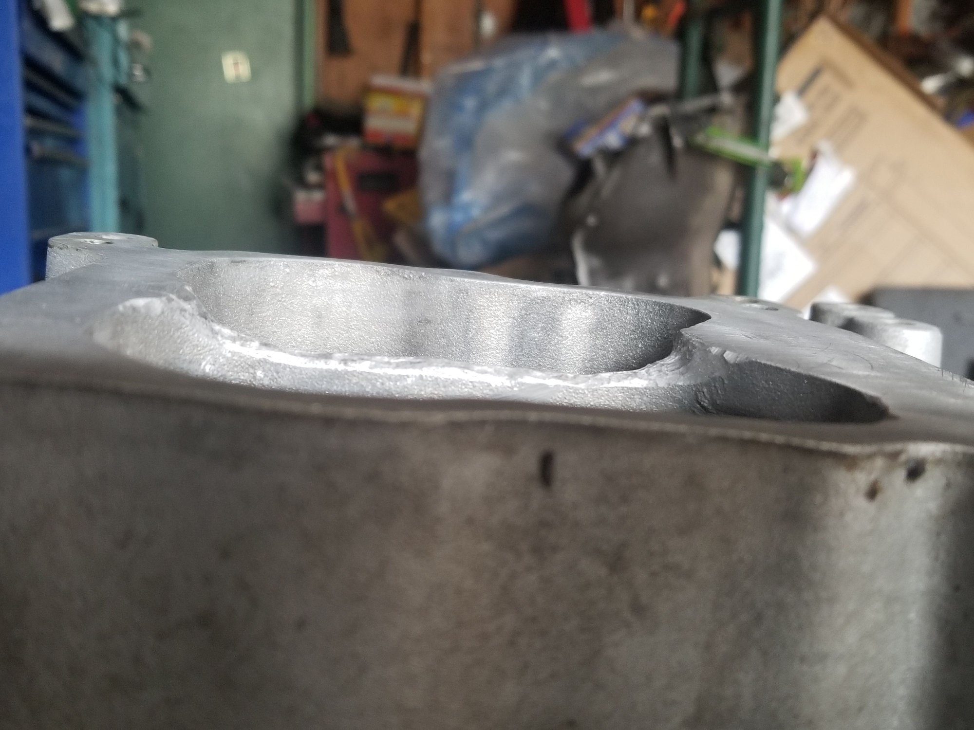

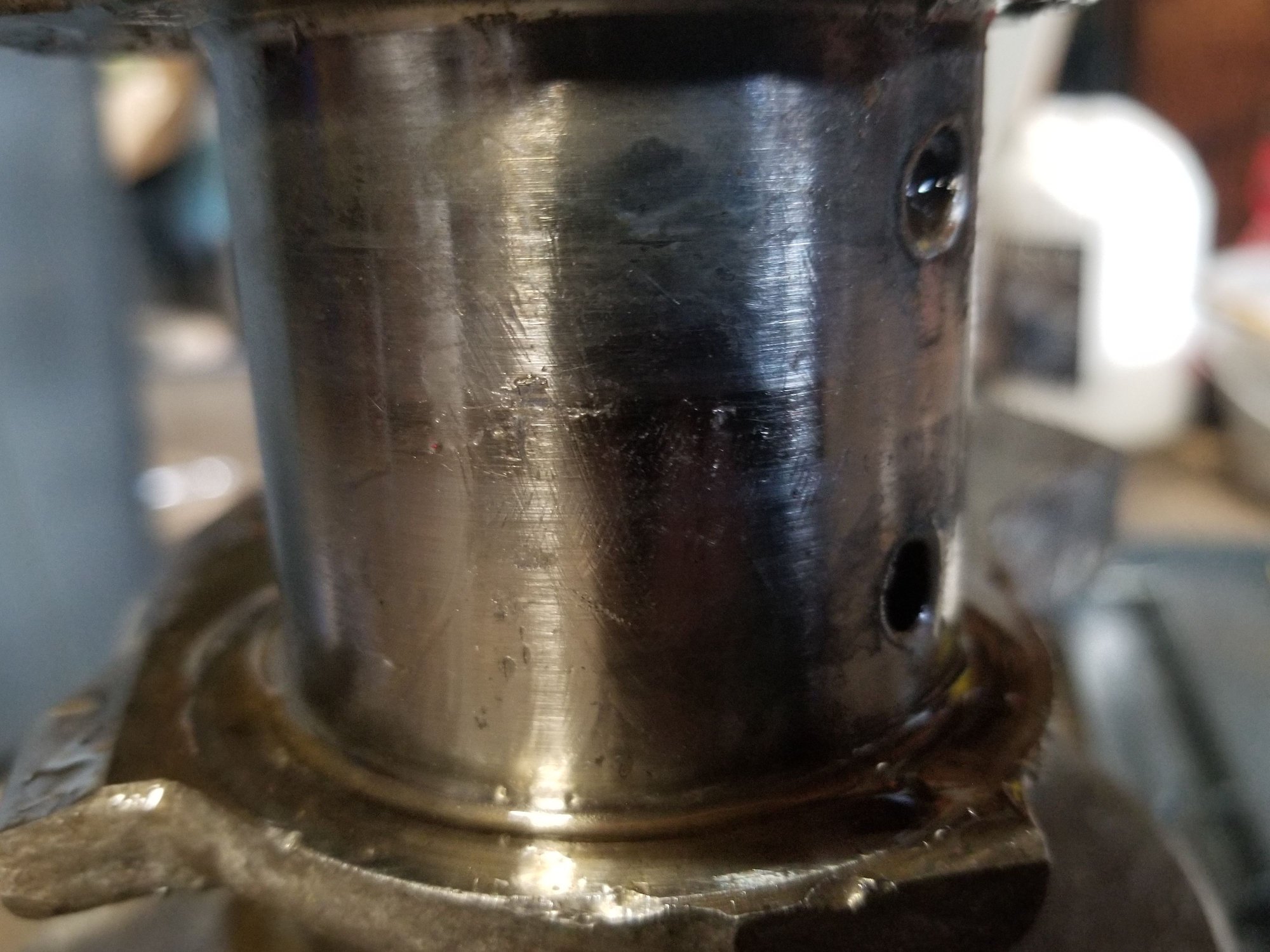

I did a couple of measurements with my digital caliper on the standard stroke 330 crank. The numbers may not be super accurate, which is why I ordered a 2" to 3" micrometer to measure the final product when it comes back. Same goes for the dial bore gauge to measure the machined cylinders. I got 2.100" on a couple of rod journals, it looks like the rods are .020", was told they were .010". The mains were 2.4975" to 2.480" which would actually be a standard journal with .0030" to .0035" clearance. Mark suggests .0022" to .0025" rods and .0025" to .0028" mains for clearances. My other stroker crank is SUPPOSED to have .0025" rods and mains clearance with the mains .010" and standard 2" sbc rod journals, it will get measured as well. Especially since it was from Smitty who went off the deep end pretty much right after.
Old May 1, 2021 | 06:09 PM
olds 307 and 403's Avatar
Out of Line, Everytime😉
Posts: 10,145
From: Melville, Saskatchewan
Here is better picks of the nicks on the stock stroke 330 crank.

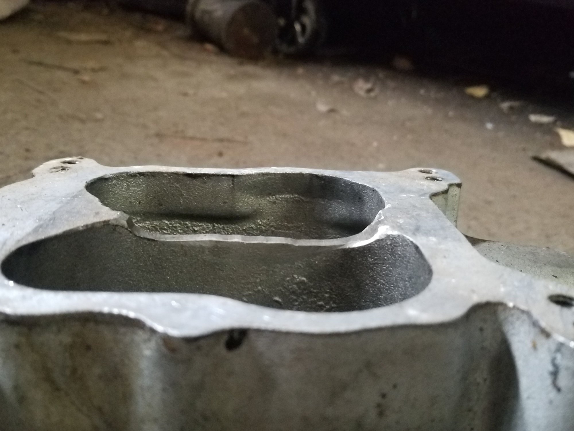

I cleaned up these, I have the 3/8" to 5/16" studs but they won't cut it for roller cam springs. If I don't mill the #6 head rocker pads for new Edelbrock head Harland Sharp roller rockers, I will put these on.

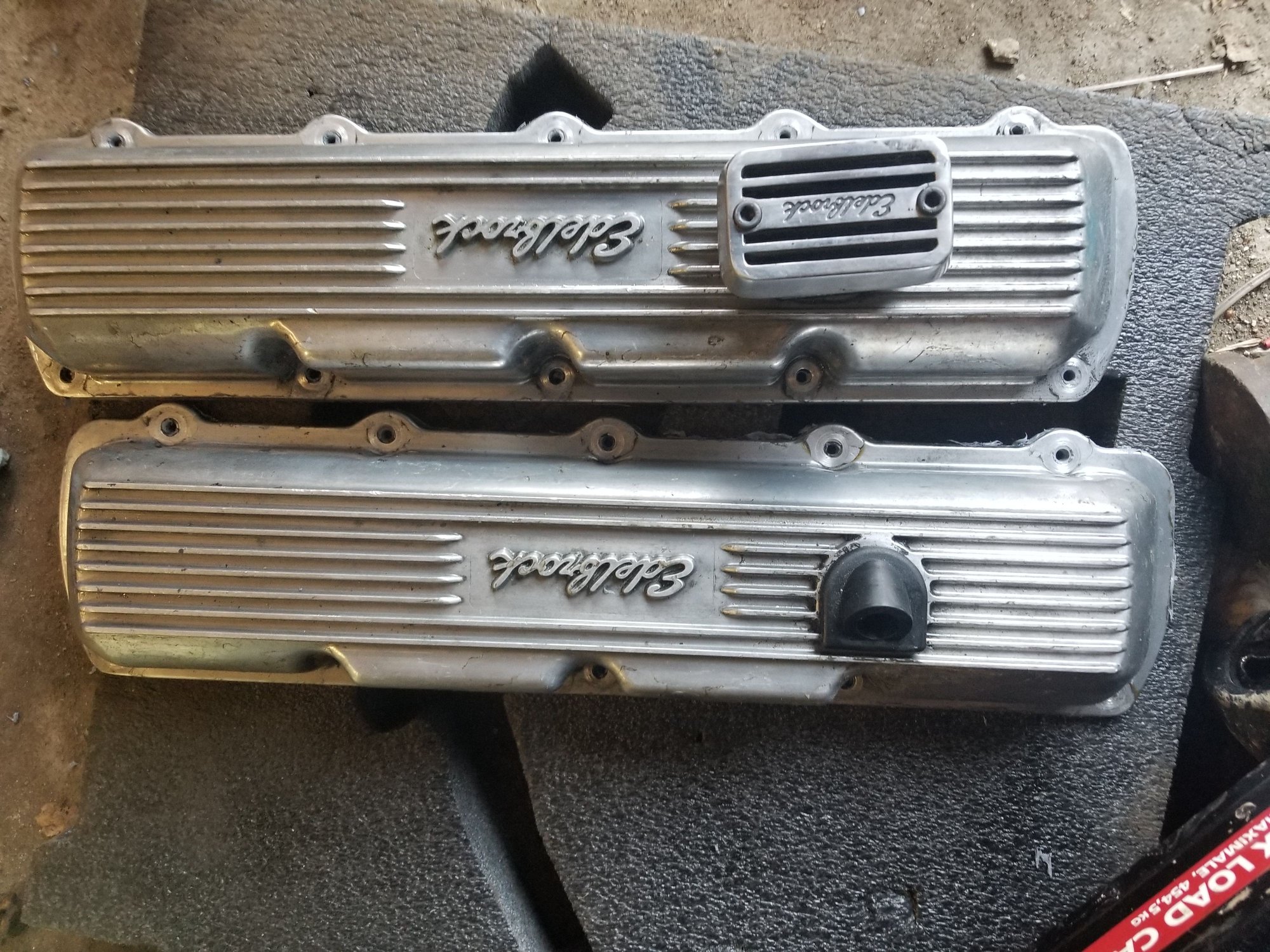

The 73 covers off the motor.
Temporary replacements.
A couple of coats of stripper brushed in and off.

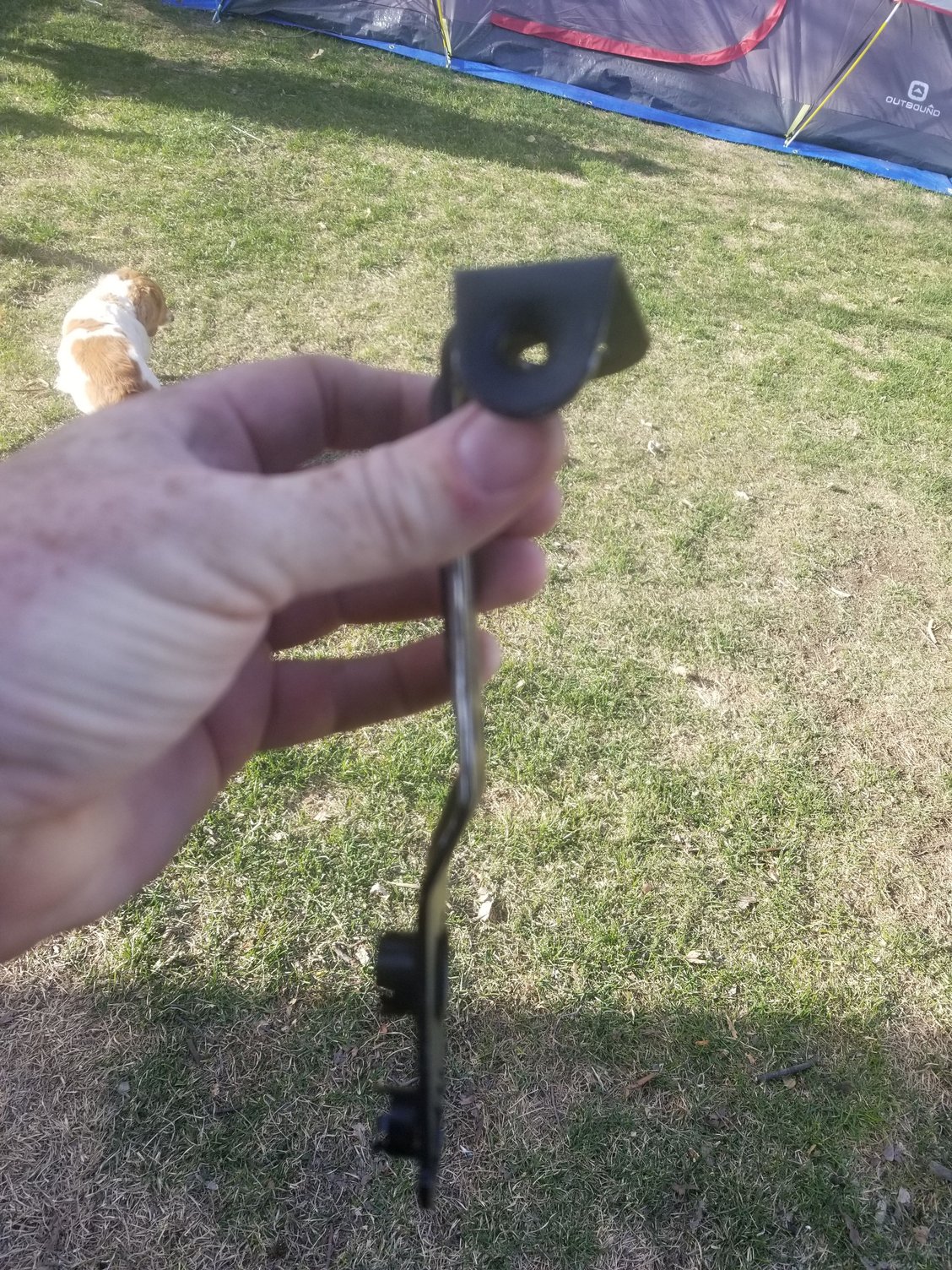

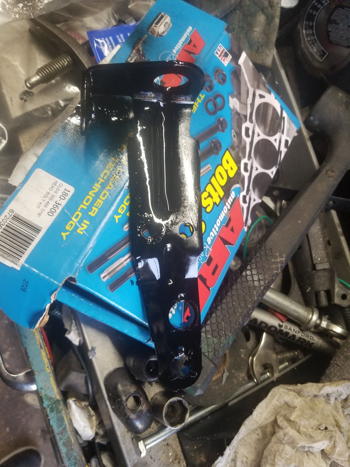

Thornton doesn't ship paint across the border, VHT Gold Flake engine enamel is going on. So I am converting this car to cruise control. I bought a 1978 cruise control system with the dash button. I used it for years on the 88. I stole the bracket of it for the dual vacuum and brake light switch. The bracket is big and cumbersome. The factory bracket is small and has a bend at a right angle. I modified this 88 bracket, this one does as well but needed the big sides cut off. I ordered the nearly unobtainable vacuum dump switch and the readily available 4 prong cruise brake switch.

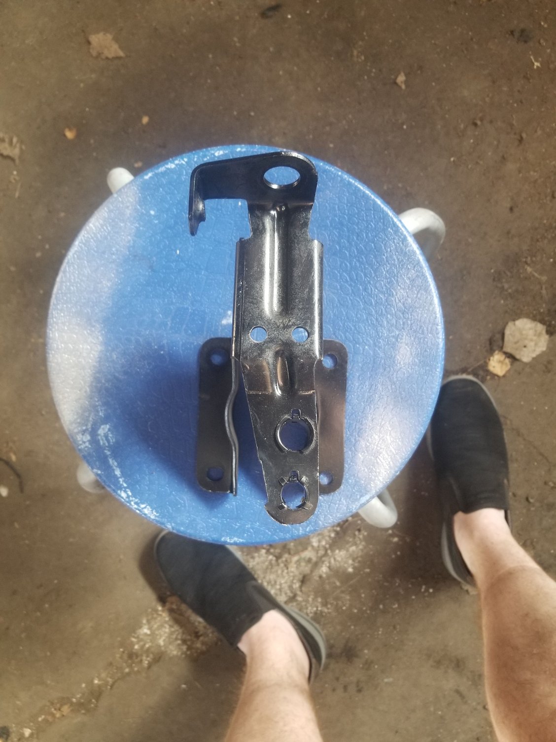

A pic of the factory cruise bracket.
Unmodified 88 bracket
Sides cut off
With some flat black paint

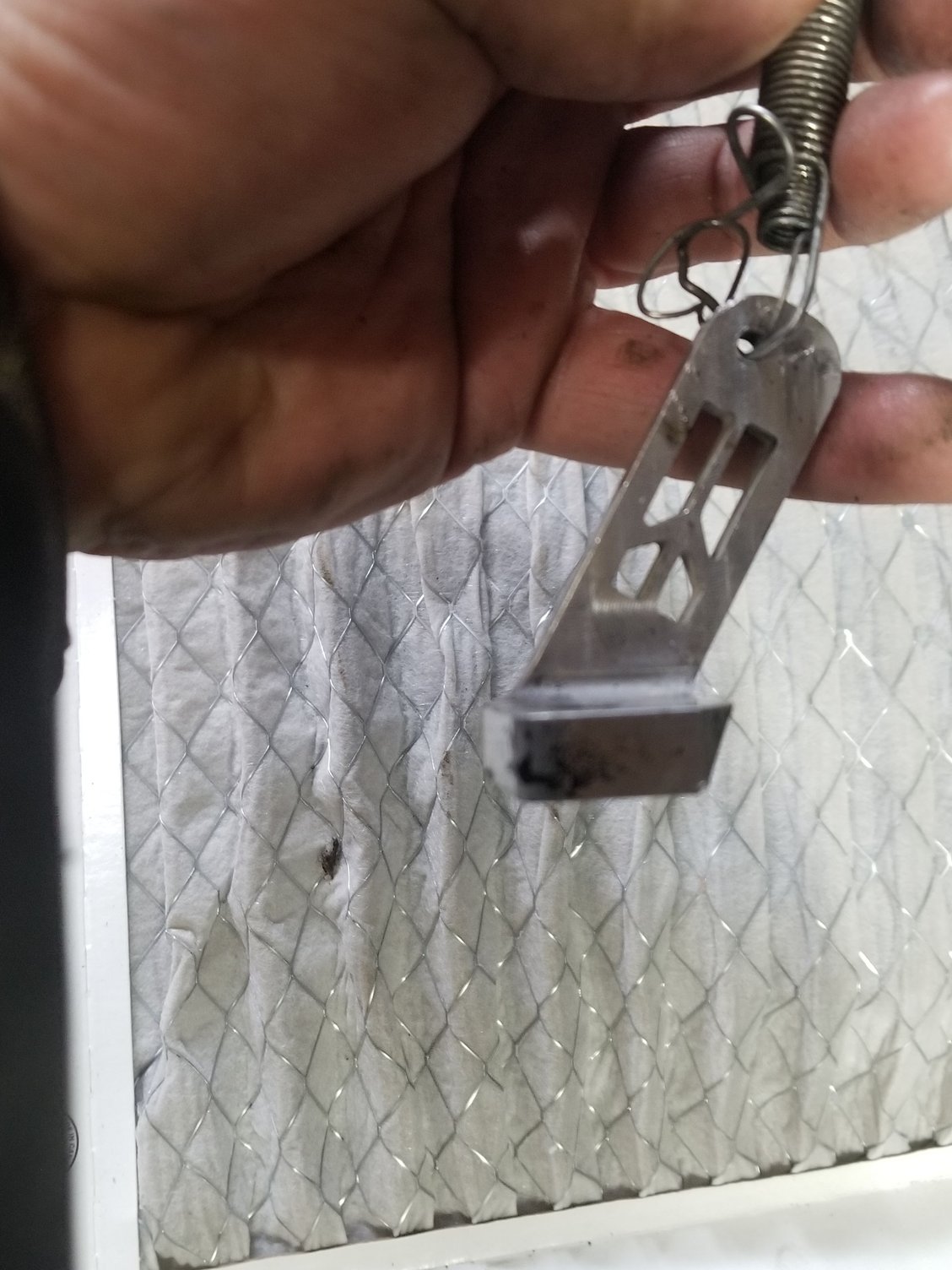

Of course some how I lost the green solid tin core, 40 ohm wire for the Cruise Control. I see one on EBay for 79 Buick with the hard to find vacuum switch. I may have to go this route, very frustrating, more money out the door.

New Standard and Dorman Grommets. I also got a new one to replace the Grommet in the air cleaner where the breather tube goes in, it is cracked.
