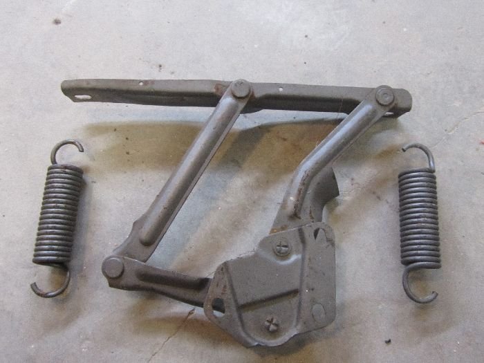

Trying to get the fit right on my new Fiber Concepts hood and don't have hardly any adjustment on my hinges. That got me wondering if my hinges were wrong or a cheap reproduction. If someone could post a pic of 1972 factory hinges that are used with OAI hood it would help me determine what I really have. Thanks in advance for your help.

OE GM 69-72 hinge

Thanks RetroRanger, I see the holes are slotted on your hinges allowing for some adjustment. Going to check but I think that's what I'm missing. Yes I am using the spacers on rear of hinge. I was worried about pulling the threaded insert out of the hood if the gap was left.
