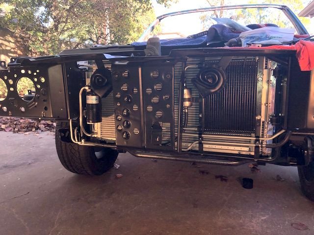

Wheels:
I selected Bandit 18” rims for better tire selection and so I could run 13” front brake rotors, but I never liked the center caps that came with the rims. So, I modified some stock retainers to install SSI center caps. They look a little small on the 18" rims, but overall I’m very happy with the outcome.
18" Bandit rim w/SSI center cap.
Stainless steel studs and nuts for the wheel retainers.

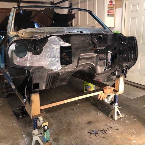

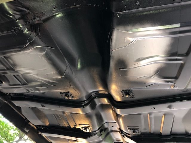

Body work and rust removal:
Using a wire wheel, I ground out all the seam sealer from the cowl & firewall. There was a surprising amount of rust hiding in these seams. I used Ospho to treat the rust at the seams and in the side cowl panels. I stripped the trunk floor, plug welded a few pin holes (where it had rusted through) and undercoated the bottom. I also restored the emissions stand pipe (mounted behind the back seat) as well as tank vent hardware and installed new vent lines to the gas tank.
The silver stuff is the heat shielding behind the AC suitcase.
Outer wheelhouses installed.

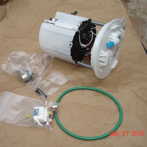

5th Gen Camaro Fuel Module
dc2x4drvr:
Thanks for the thumbs up! I purchased a stamped restomod tank from Ricks Tanks which looks like a stock tank but has cutouts for a 5th gen Camaro fuel pump module and level sensor. By replacing the internal poppet valve in the 5th gen fuel module with a 4th gen poppet valve the fuel module will regulate the fuel pressure at 58pis and internally bypass any excess fuel. This allows me to run a dead-headed fuel system without a return line. The 5th gen Camaro module can support up to 450HP which is perfect for my needs. I'll be running a FiTech EFI throttle body system with a PWM fuel pump feed which slows down the fuel pump at idle (when the fuel demand is low) and increase the pump speed to meet the engine demand. Here's some pics:
LS3 Camaro fuel pump module. I bought the poppet valve and adapter from carl@vaporworx.com.
Ricks Restomod tank.

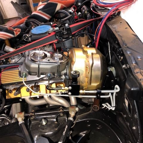

'70 disc-drum combination valve
I'm running a 1970 combination valve for front-rear brake distribution. Inline Tube helped me out with this one; because I have a disc-disc system, I needed a distribution block only w/o the residual valving for drum brakes. The '70 model A-body cars had a separate residual valve for the rear drum brakes mounted in the rear and the combination valve mounted on the LH, front frame rail was only used to split the front & rear systems w/o the residual valving. The Inline Tube part number for the'70s combo valve is PR107.
My brake force calculations show that a dual 9" vacuum booster with a 1" disc-disc master cylinder should provide an additional 17% braking force with the C5 front disc set-up. That assumes 17in vacuum and using the stock power brake pedal ratio; if I want more whoa for my giddy-up, I can increase the pedal ratio at the expense of some additional pedal travel. Using the manual brake pedal ratio nets a brake force increase of 42%, so there is a lot of room in between to dial it in!

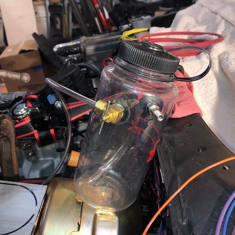

I sent the reworked Hooker header to PolyDyn here in Houston to have it thermal coated to match the RH side. I picked it up on Friday and got ready to install but couldn't get it fit! Sure enough, it was hitting the frame in 3 (yes THREE!) places. How could this be? I had spent hours a few days ago reworking the 2 primary tubes that were hitting the LCA. I took the header back out and removed the copper gasket so I wouldn't damage it while F-ing around with this this @*$&% header!! I didn't see any obvious issues so I reinstalled the header...without the copper gasket...and it fit perfectly!! I should have allowed for the gasket thickness when I reworked the header - DUH! SO, I got out my BFH and beat the living s*$# on three of the primary tubes to clear the frame. The only saving grace in this whole header debacle is the BFH beating can't be seen because the dents are right up agains the frame and crossmember.
After fighting with the header, I moved on to other assembly items: torqued the trans cross-member bolts, connected the back-drive linkage to the shift selector, and then moved on to a valve cover project. The M/T valve covers did not come with baffles installed, the mounting posts weren't even tapped. So I tapped them for a 8-32 screw and cut some 16 gauge sheetmetal into 1"x3" baffles. Once I finished the baffles I spent the next 2 hours polishing and buffing the aluminum covers with some polishing compound I bought and the a car show a few years ago (the sales girl was super cute). The polishing job probably could be better but it is definitely an improvement. Here's some pics:
Tap for 8-32 screws to hold baffle plates.
I hope the baffle is big enough limit oil flow into the PCV.

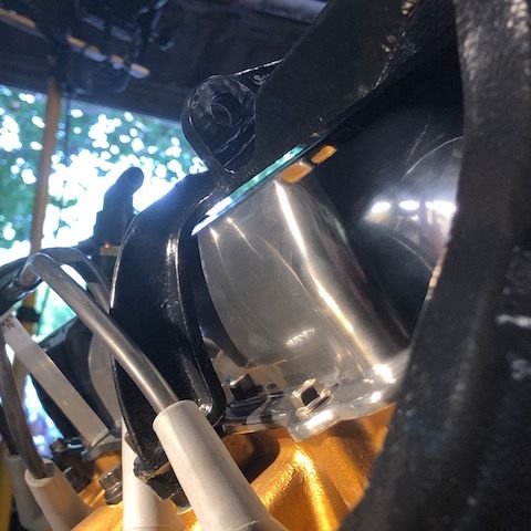

I do have AC but not running stock heads or intake. I have aluminum heads and an Edelbrock 7111 intake; I had to grind a little bit to get the AC brackets to fit properly but no fitment problems with the valve covers. It is pretty close though. Here's some pics:
RH valve cover.
There's about 1/4" clearance between the AC bracket and the valve cover.

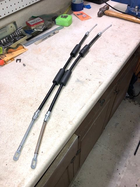

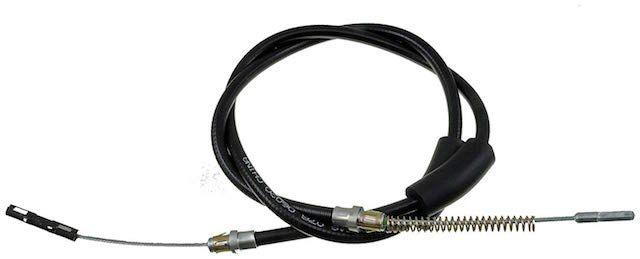

Disc Brake Parking Brake Cables
We have annual vehicle inspections here in Texas, and one of the requirements to pass the state inspection is a functioning parking brake. So when I was researching my options for a rear disc brake swap, a dependable parking brake was high on my priority list. The rear disc set-up on my car is from a 2001 Blazer 2WD, which has a drum-in-hat style parking brake. This is essentially an miniature drum brake used to lock up the rear wheels and it's found on 4th gen Camaros and C5 Vettes as well as the Blazer. The parking brake is independent of the caliper and is actuated by a small lever on the backing plate, but the Blazer cables are much longer the stock drum cables. So, I purchased the shortest Blazer cables I could find (66" long) and set out to shorten them. It wasn't all that difficult:
I started with the 66" long Blazer cable. This is a Dorman part#C95546.
First, I cut off the stop at the front end of the cable.
To remove the mounting ferule, I heated the ferule (just a little) and gave it a good tug using the vise to pull the ferule off. Don't heat it too much or you permanently melt the vinyl sheathing on the cable.
I cut the cable housing to the correct length. I did a practice cut with the grinder but it put too much heat into the housing and melted the vinyl covering. I used a sawzall instead and cleaned up the cut with a flap-disc.
The steel cable inside the housing is 1/8" diameter. I sized up the length comparing to the stock drum cable and crimped on a new cable stop.
Here are the finished products; one for each side!

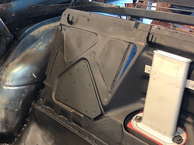

Sub-woofer Enclosure
I also enclosed part of the rear seat brace to create a built-in sub-woofer box. The rear seat brace in a convertible creates a triangular space behind the seat and the top well. I fit some triangle shaped plywood dividers inside the space to close off the ends and cut pieces to fit tightly inside the irregular cutouts on the seat side. I then screwed a 1/2" thick piece of plywood to seal off the trunk side and mount the 8" sub. I'm using a JL Audio 8" sub that works best in a sealed box with an internal volume of .35 cu.ft. The space behind the seat works out to be just under .37 cu.ft. Here's some pics:
Sealed off the holes on the seat side of the divider.
Added 3 plywood dividers to seal the end of the sub enclosure and make the sheet metal more rigid.
Added 1/2" plywood baffle to the trunk side to mount the 8" sub-woofer.

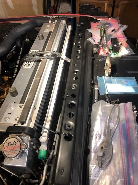

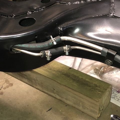

Trans cooler lines
I finally finished hardlines for the transmission cooler and a power steering cooler. I bought bulk steel tubing from Jegs and bent my own lines...which was much harder than I expected, but I'm very satisfied with the end results. The power steering cooler it just a loop of steel tubing and may be completely unnecessary but the temps in Houston can be unbearable in the summer time and I had the perfect spot for it. Here's some pics:

Looking good Rod. What did you use to punch out the holes in your core support? I like the look.
Dwight
Old Jan 9, 2020 | 10:23 AM
  #152
cdrod's Avatar
Rodney
Posts: 2,589
From: Houston, TX
Flare puches
Dwight
Dwight:
I have a punch die for the 1" holes that cuts and flares the hole in a single step using a socket wrench to tighten the punch. For the smaller holes I have a set of flaring dies but I have to drill the holes first, then use a large C-clamp or a a ball joint tool to compress the flaring die. The smaller holes were much more work because of the 2-step process and the C-clamp tends to wander as you tighten it, which screws up the flare. My goal was to lighten the front-end. I punched holes in the top & bottom rails of the core support, a few more in the headlight mounting areas and in the center support. These holes, in combination with aluminum heads, intake manifold & water pump, an aluminum AC compressor and an aluminum radiator took about 130 lbs of sprung weight off the front end of the car. The aluminum wheels, and Corvette brake calipers & rotors took another 23 lbs of un-sprung weight off the front suspension (11.5 lbs. at each wheel). That should improve suspension response and handling. I can't wait to get it on the road!! Here's a pic of the punch dies.
Rodney

Originally Posted by cdrod
...I punched holes in the top & bottom rails of the core support...
You punched holes in the top of the core support?!?!?! The built-in tool shelf on our cars is literally my favorite feature!
Old Jan 10, 2020 | 08:49 AM
  #154
cdrod's Avatar
Rodney
Posts: 2,589
From: Houston, TX
Tool shelf!
I only drilled holes in the cross beam (under the radiator top plate). As you can see from my pic, I make good use of the built-in tool shelf. I hate working on my late model cars as my tools always seem to end up on the ground at least 4-5 times during the course of a repair.

Master Cylinder & Proportioning Valve
I bench bled the master cylinder yesterday. I'm installing an aftermarket brake booster from Tuff Stuff and the brake pedal pushrod was shorter than the factory booster...so I had to fab up an extension using a 3/8-24 coupling nut and 1" bolt. Today, I finished plumbing the M/C and the proportioning valve for the rear discs and fabricated a simple bracket to mount the valve to the M/C. Now on to the arduous task of bleeding the entire brake system, which brings up a question. After bench bleeding the M/C, brake fluid would drip from the open ports. Is this normal? It seems like the M/C would drip out all the fluid if left un-capped for a long time. Anyway, here's a few pics:
Old Jan 18, 2020 | 05:13 PM
  #158
oddball's Avatar
Joined: Sep 2011
Posts: 2,148
From: Plano, TX
Yup, normal. Don't leave it open more than absolutely necessary.
Looking excellent as always!

Home Made Pressure Bleeder
Oddball:
Thanks for the compliment.
I fabricated up a pressure bleeder from an old water bottle, a scrap piece of 1/4" aluminum plate, a needle valve and some plastic tubing. Parts total was about $35. This sure beats the hell out of the 2-man, pumping the brake pedal method, but I have a questions about the proportioning valve. How do I make sure to get all the air out of the prop valve? Here's some pics:
