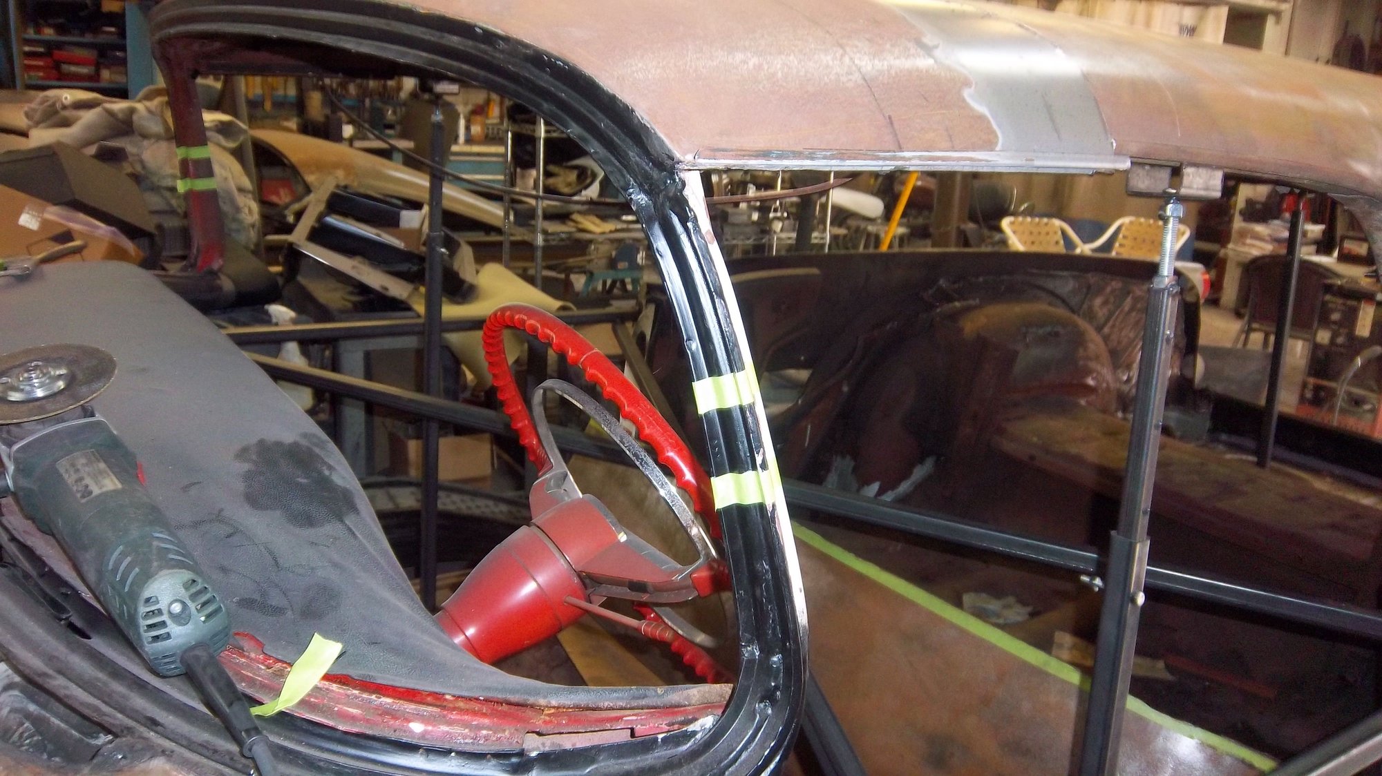

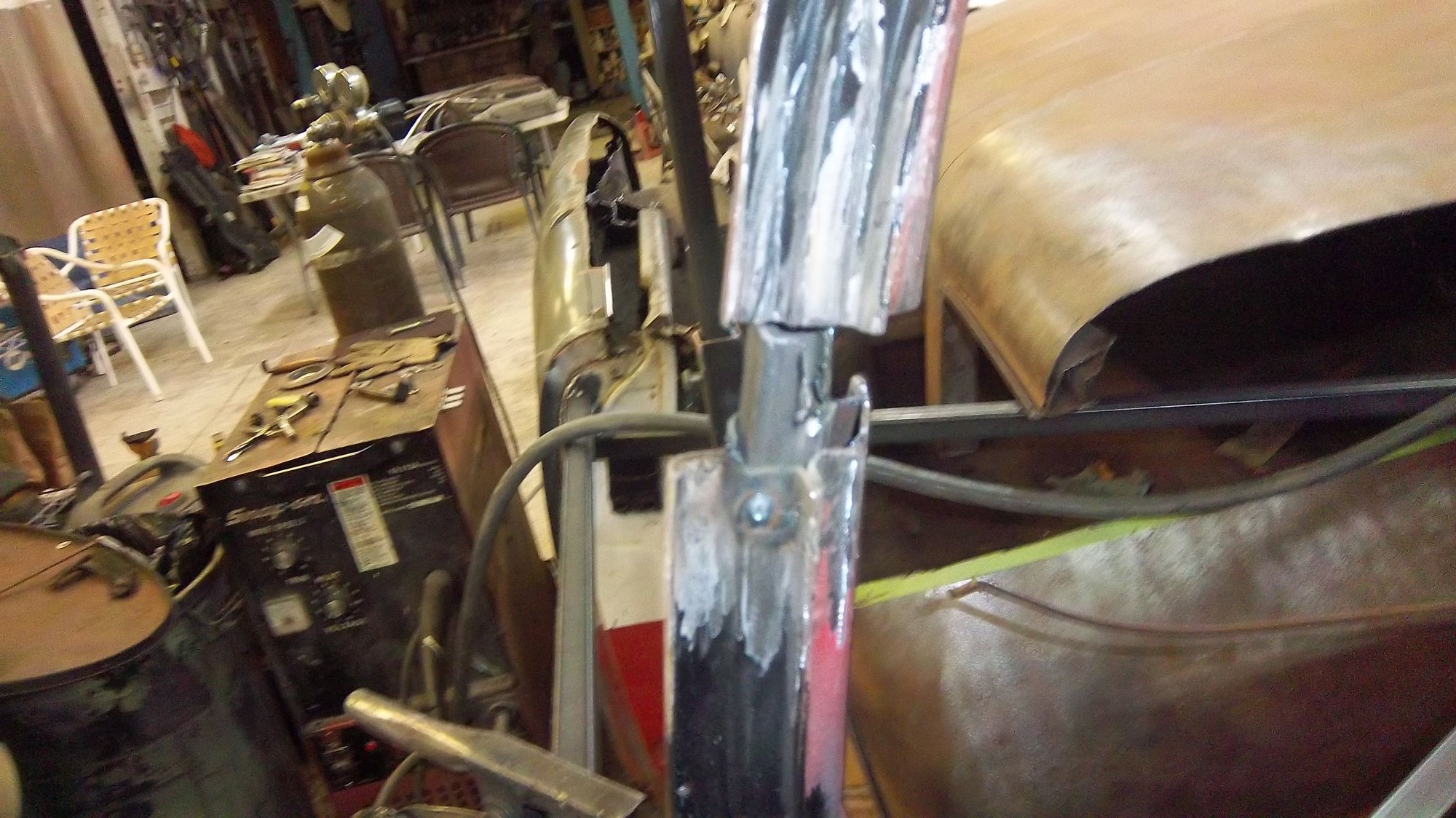

My serious "Kustom guy" attitude convinced me to chop the car. It's going to add some more serious work, planning and figuring, but what the hell!
Started at the "A" pillar. Marked off and cut 1 1/2 inches out of them. Used some 3/4" tubing to reinforce the cut line, rosette welded it above and below the cuts, which were welded solid. Then made 2 cuts, just above the curve on the roof sides, and spread the roof apart to meet the "A" pillar, and welded them up.
It's a start, and we can't go back now!

After the "A" pillars were welded up, as well as the support piece behind the top of the windshield, I decided to go straight to the "B" pillars, instead of dealing with all that 'almost flat' sheet metal welding. The big decision was whether to keep the Olds 'dip' or eliminate it, like Chevy did on the Nomad. I reinforced the inner structures, with 1/8" plates, make a template, and filled the gap between the bottom of the Nomad's B, and the top of the Olds quarter. I could always change it if I didn't like the dip being there.
Now I think it looks pretty good, probably keep the dip. Besides, I believe the Olds side trim needs it there! Gotta find some 56 "98" trim to go on the car, though.

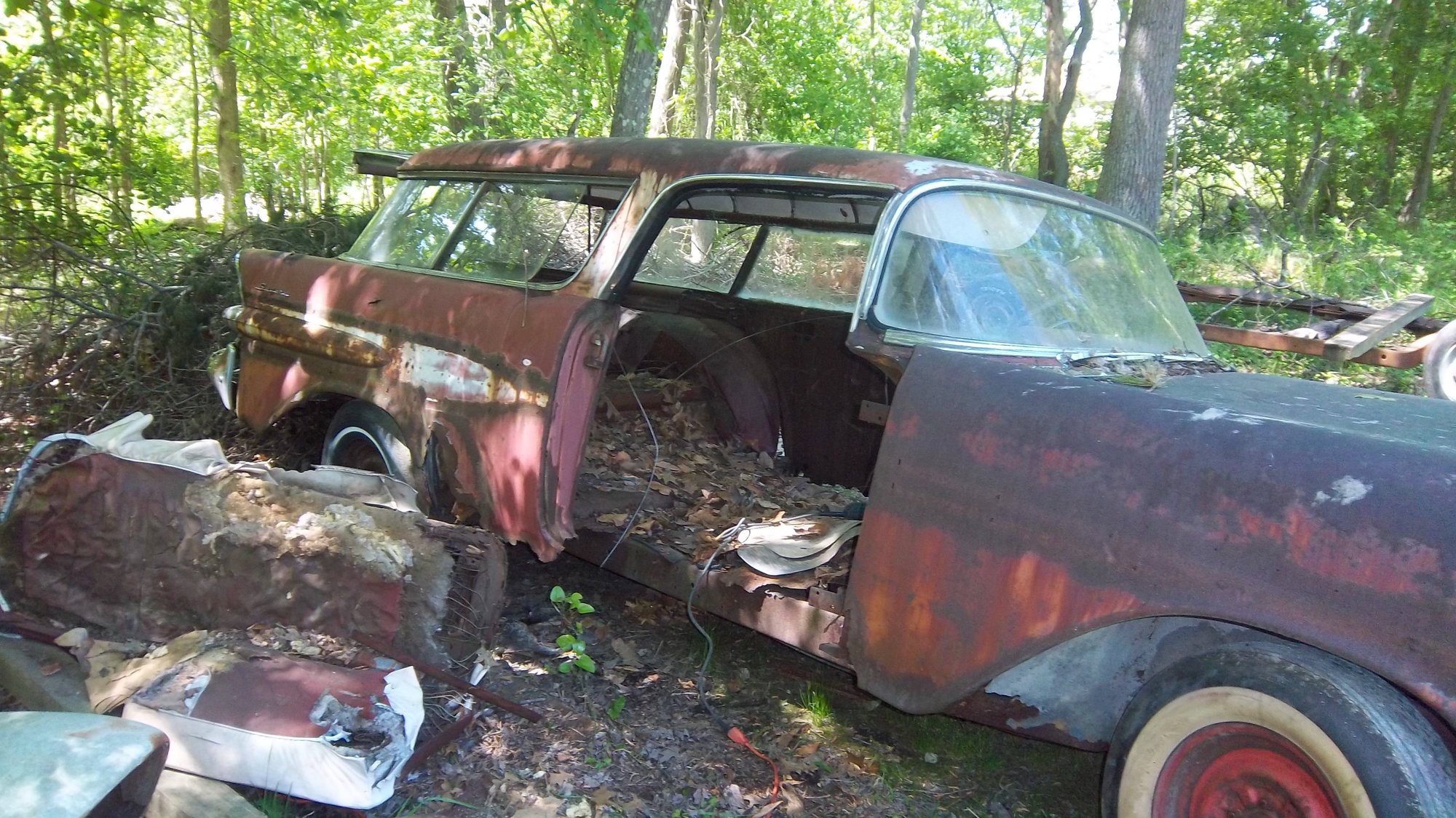

Got a call from a friend who found a parts car 57 Safari he thought I could use. I thought it was in better condition, but the car does have all the interior and exterior trim I need, plus glass, and the fold down back seat. I may be able to use the tailgate area, too, as it is much better than mine!
