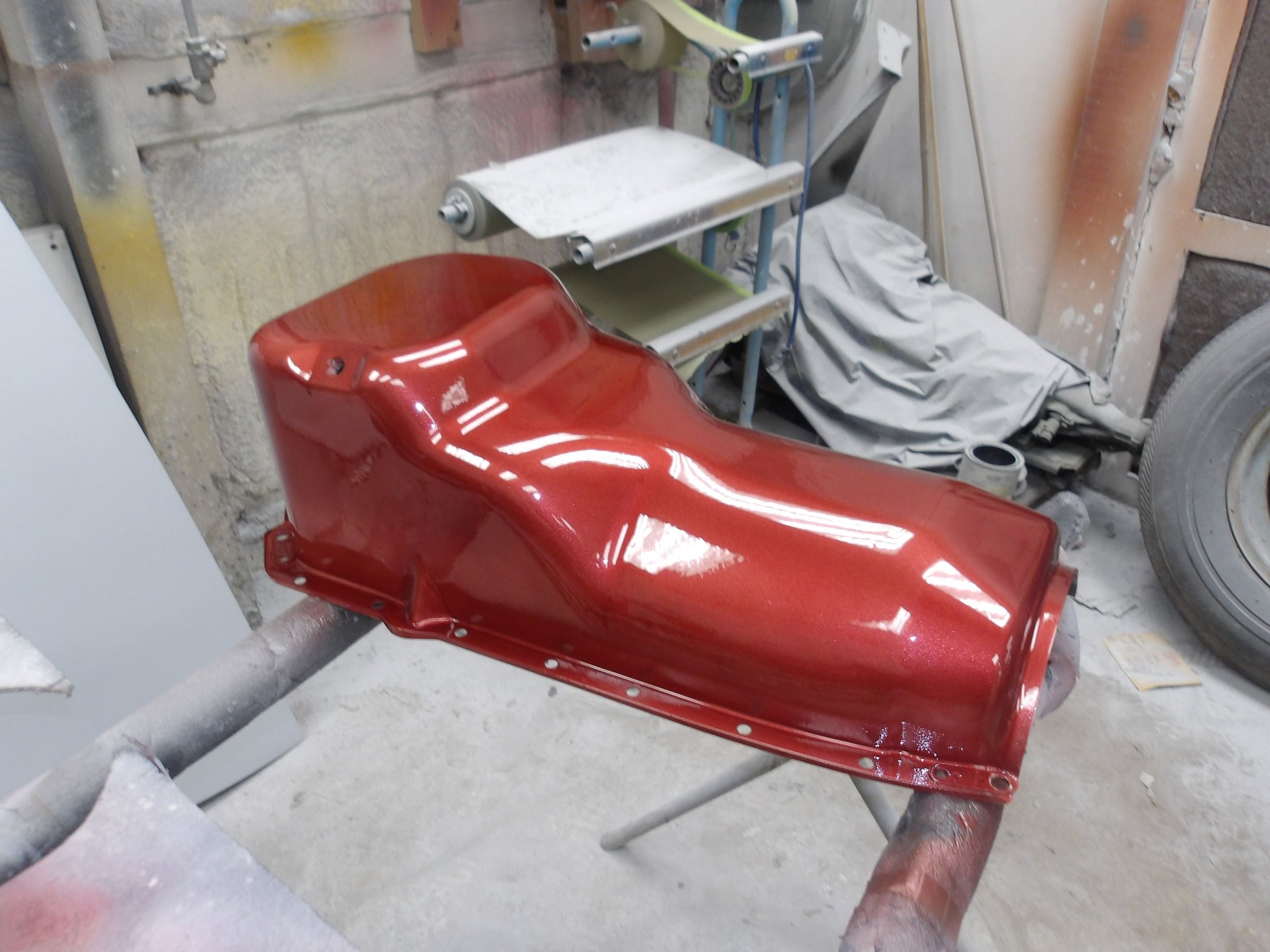

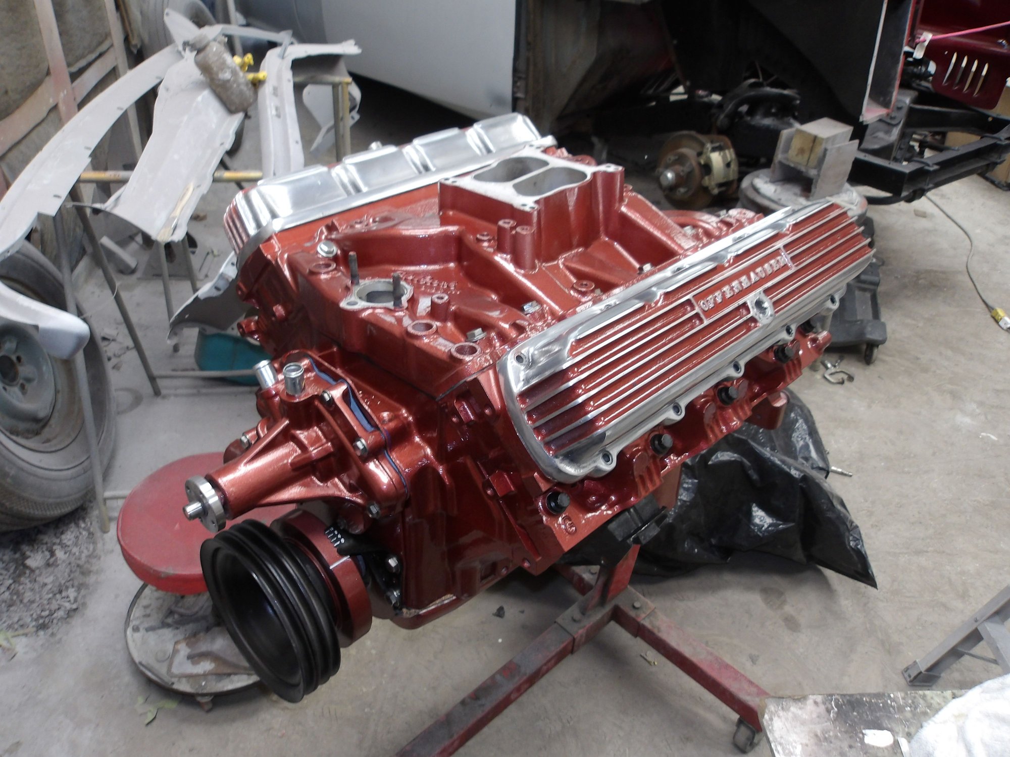

All parts for the engine are in. I let the epoxy primer set on the engine for a week, and scuffed it up for paint Had to deburr and smooth the heads a bit, as well (What a job!) I wanted a color to compliment the copper and beige pearl I plan on paining the body. A bit darker, to show off the aluminum and chrome. So, I mixed up some of the copper, with HOK Gamma Gold metallic, and some red and root beer candy. Finally got the bronze-y color I wanted. Getting ready to drop the engine in the chassis.

Wow, that looks sweet. Very nice work.

Very nice!!

Love that color!!

That is looking so nice: so looking forward to seeing the final results! Outstanding attention to detail!

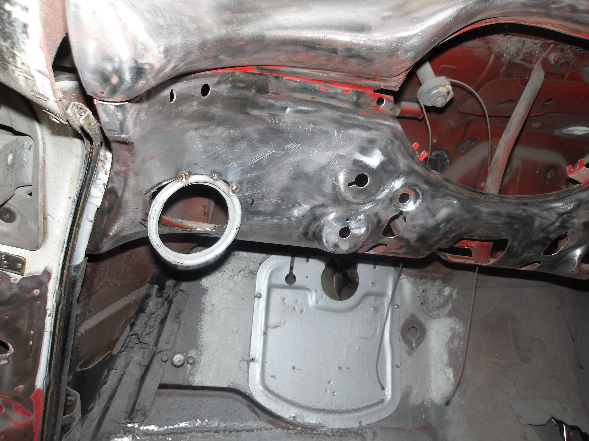

I finished modifying the wheel wells, as fixed some rot, and got them painted, and started undercoating them. But the product I used checked, and began peeling off. So, I'm switching to Upol Bedliner. I modified the radiator support, to fit the narrowed Impala front frame, and to fit a modern crossflow radiator, a 4 core aluminum one for a 455 Vista Cruiser. I also decided to Semi-French the headlight bezels. I cut away the outer ring, fabbed it out of sheet metal, and welded that to the fender, Now, just have to send the inner pot metal bezel to the platers.

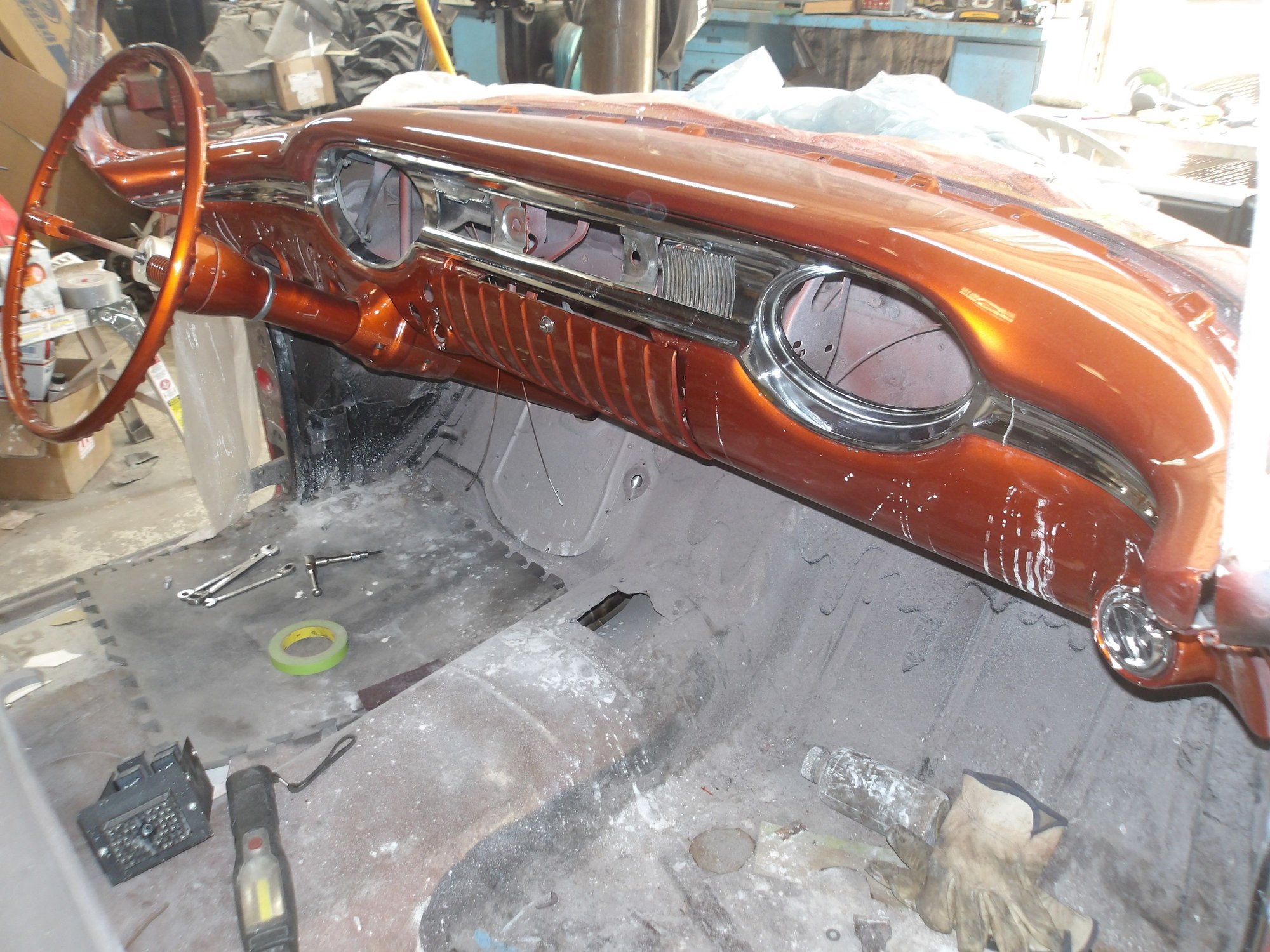

Long overdue update. Not tons of work getting done on the Olds-Mad, but it's getting closer to being fired up for the first time.
All engine stuff completed. The only thing left is to find a place to put the aftermarket fuse box. A friend found it for me, and it's a "Haywire" kit. Not easy to place, as it's pretty long. With the wiring connector, it's about 15 inches! I guess, since it has a bolt on connector, it was made to go on the firewall, with the connector in the engine compartment, and box, inside. But as we know, on Olds, that's not a viable option. And really not a lot of real estate under the dash for something that big.
Got the radiator mounted, and due to the subframe swap, it had to sit a bit high. So, I built a shroud for the fan, as the fan extended a couple inches below the radiator.
Picked up a new steering wheel from Fusick, got the dash straightened, minor dings and dents, painted and upper part buffed. Steering column got it's shifter removed, and then adapted for a bearing and steering joint.

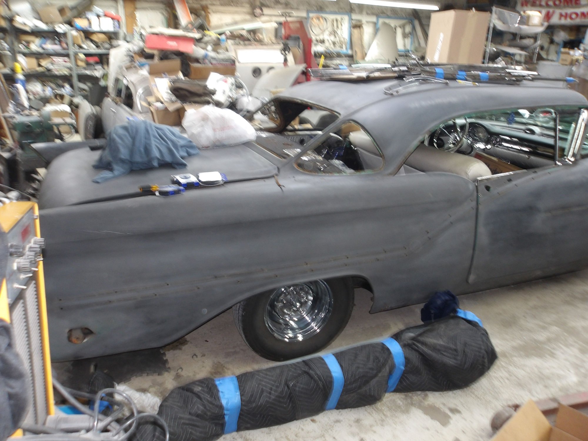

Oh, and another thing that slowed down the project was the windshield. The car came in boxes, and the front glass was broken in the garage I got the car from. I picked up a new windshield from Auto City, at Carlisle, last fall. Got it home safely, measured it up, and cut it. Broke in 2 places! I've only broken 2 curved windshields on my chops in the past 40 years or so!. Might be that this new glass is thinner than the original. Could be that I was trying too hard.. I had made sheet metal braces to glue below the cut lines, inside and out. I tried to do a 54 a few years back (again, new glass, thinner) and it broke when I picked it up, not during the cutting, or sanding of the edge. So I thought I would reinforce the glass the length of it, until it was installed. Now I believe it might have stressed the glass into cracking. The glued brace had broken loose and shifted during cutting. I won't do that again, but now need to find a good windshield to use!

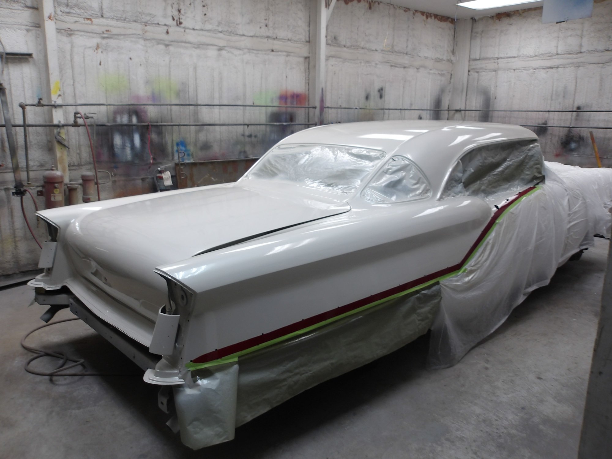

Been a long time, but here's a New Year's update. Got the engine ready to fire up, after sorting out all the bracket, pulley, fan/shroud issues. Still have NOT found a good used windshield, might have to drive to VA to get one, but it's around 390 miles, one way!. Still looking for a closer one.
Finished up the 51 Ford mild custom, and got the 57 Olds finished in bodywork, and painted the stripe and back half, before succumbing to a sinus infection. Which along with the Holidays, kept me out of the shop for a couple weeks. Olds is in Cadillac Diamond White Pearl, with extra gold pearl added. Real Candy Apple red stripe.
Hoping to get much more done in 2023. Even got the upholstery guy lined up, and bought the materials for the job.

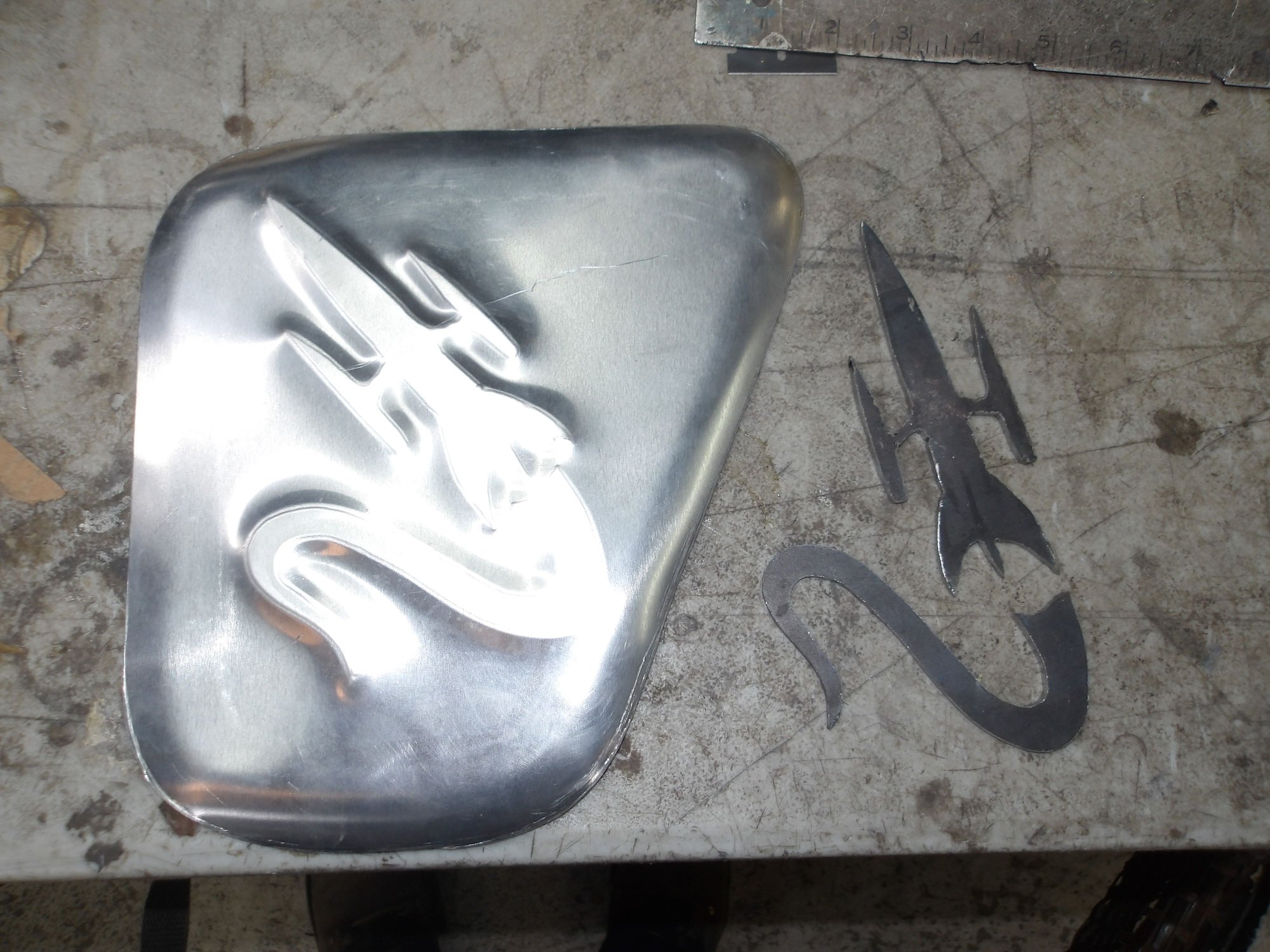

Been accomplishing little things on the wagon since last reporting. The biggest hurdle, was the windshield. The old one I got from Philly, I finally was able to cut. Had a hard time finding dry sand to blast it, finally had to go to Tractor SUpply and buy bags of Black Beauty. A bit expensive when you can't recycle it (blasting outside). But it's done, and only needs some fine tuning to fit the opening. Had a small project i completed, as well, a coolant overflow tank. I didn't want a modern billet looking one, and they usually don't have enough capacity. And the cheesy plastic ones from the auto store...NO!
So I fabbed one up out of aluminum. Even pressed in an "Olds Rocket". Painted it the second body color, to contrast with the body color in the engine compartment.

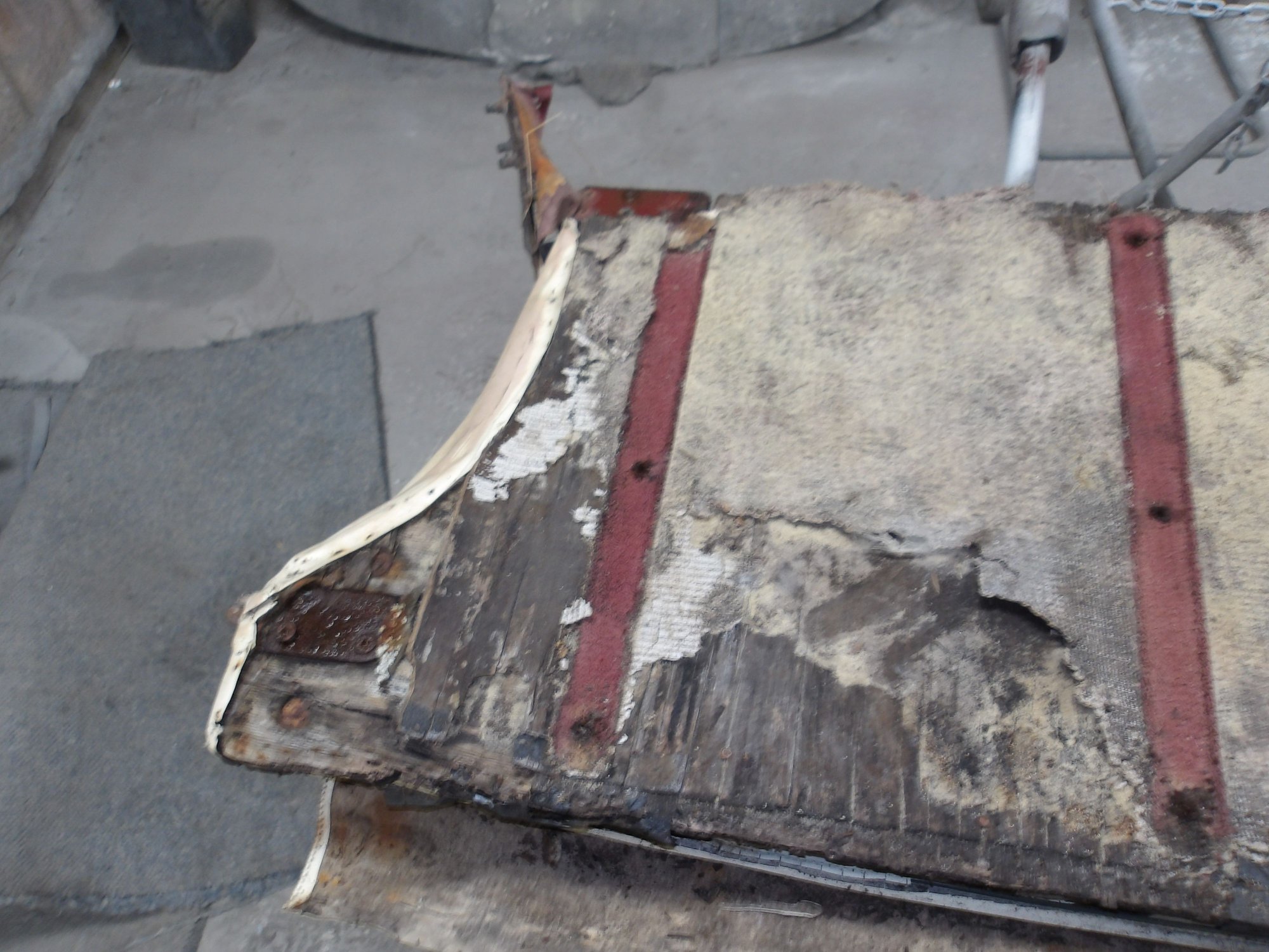

Next big hurdle, before it gets easier, is the back seat. The Nomad seat is a tricky bit of engineering. The lower part flips forward, and a bar flip around, to hold it up from the floor. The upper then hinges down to complete the cargo area floor. Now, since the Olds has a higher kick up over the rear end, the cargo floor has to be around 4 inches higher than on the Chevy/Pontiac. So I have to figure out how to get the hinges to raise the seat up 4 inches when they flip over to be the cargo floor. Other than that, I had to completely rebuild the seats with new plywood, and refurbish all the hardware.
