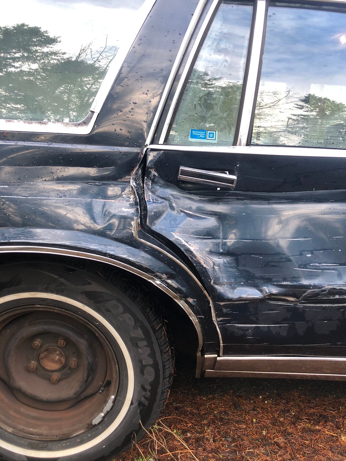

This is the car not to long after I started driving it.

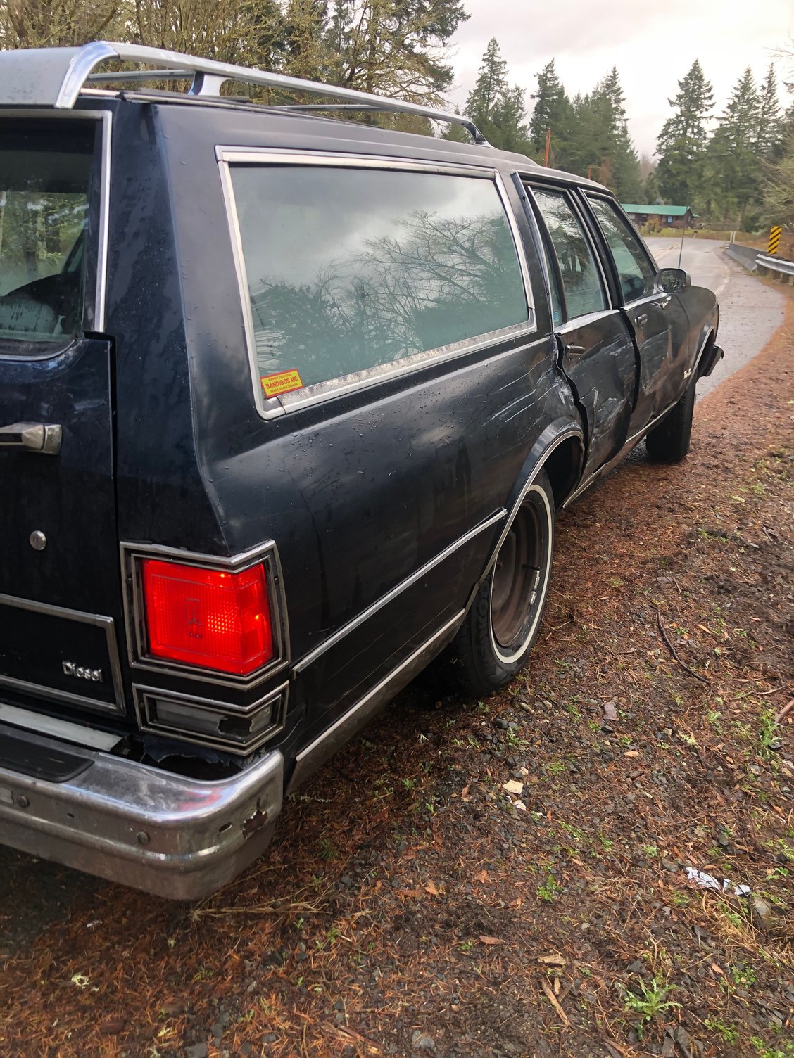

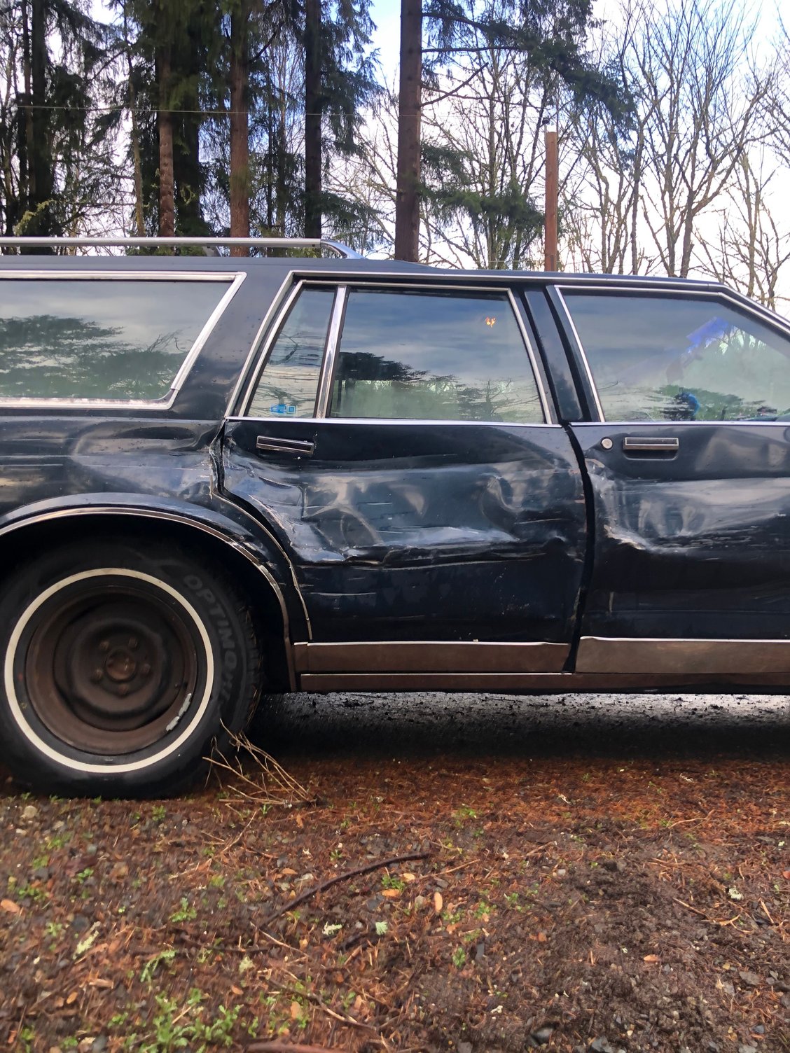

And here it is at the accident. Jan. 12th 2020

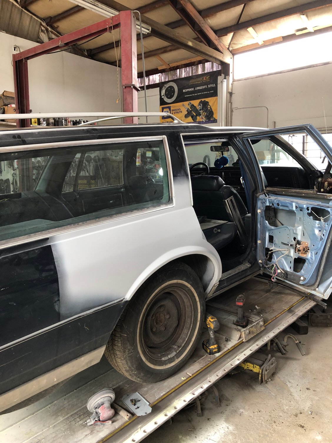

Old May 3, 2020 | 09:44 AM
young olds's Avatar
Posts: 2,036
From: Mt Vernon,WA
It’s at the shop now with a new front door, I dropped off a rear door and quarter panel on Friday. When I get it back I will update.

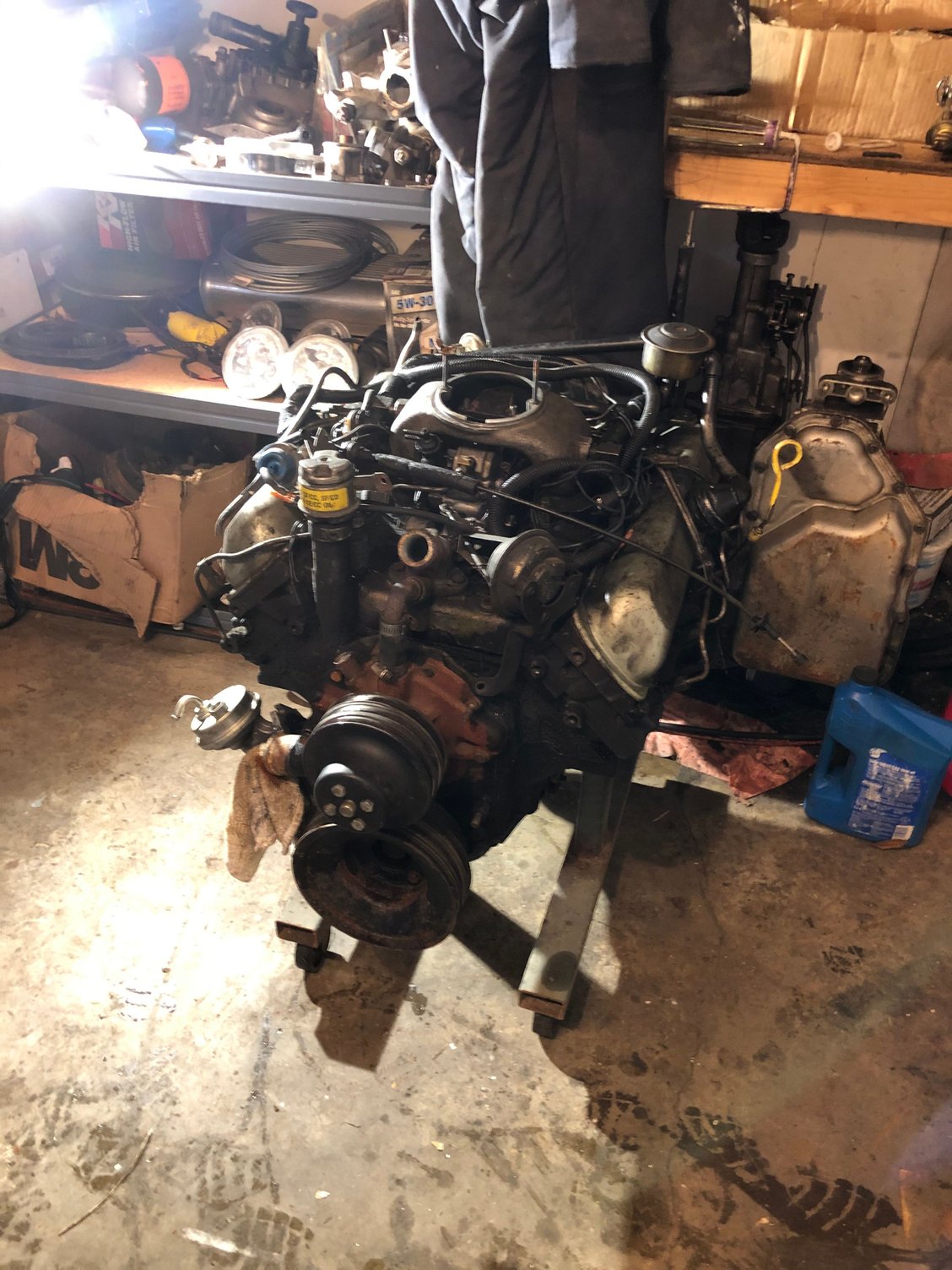

Still need a passengers side view mirror. I finally brought the diesel into my little work shop so I can revisit it. I am planing to pull the heads so I can inspect the gaskets. It’s possible this will turn into a full rebuild.

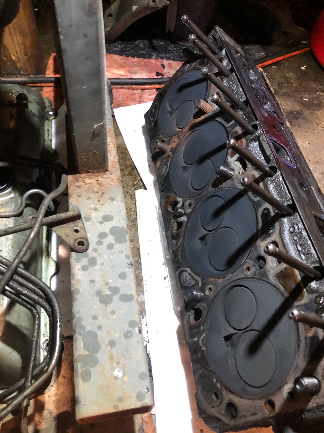

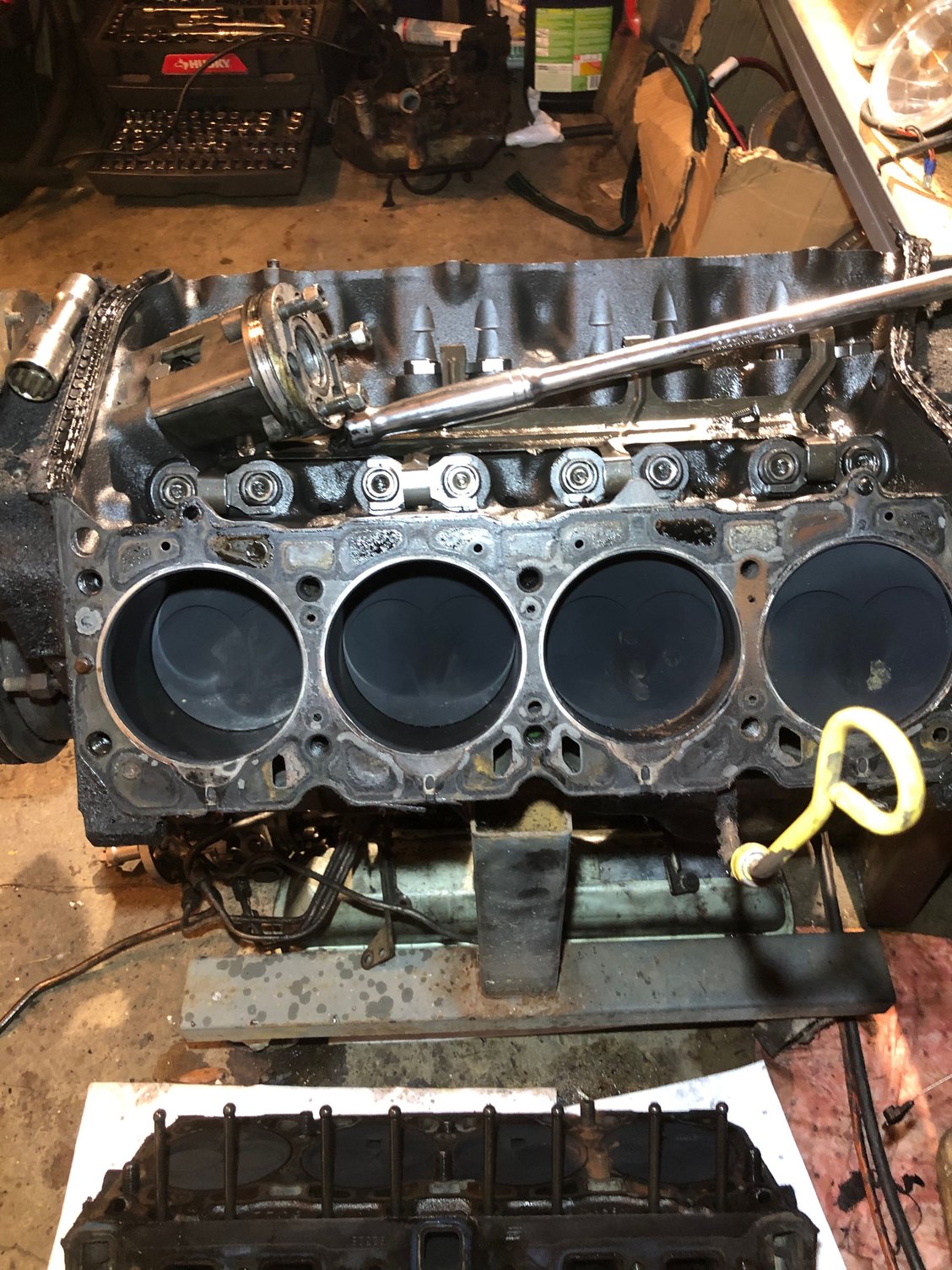

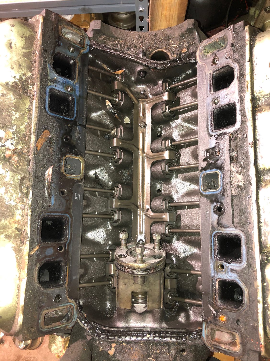

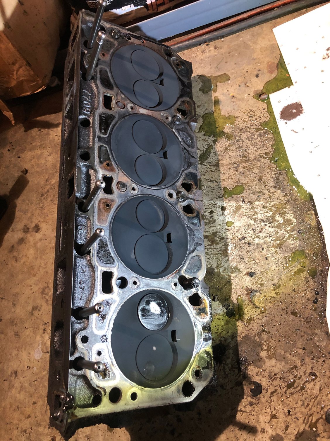

From: Mt Vernon,WA

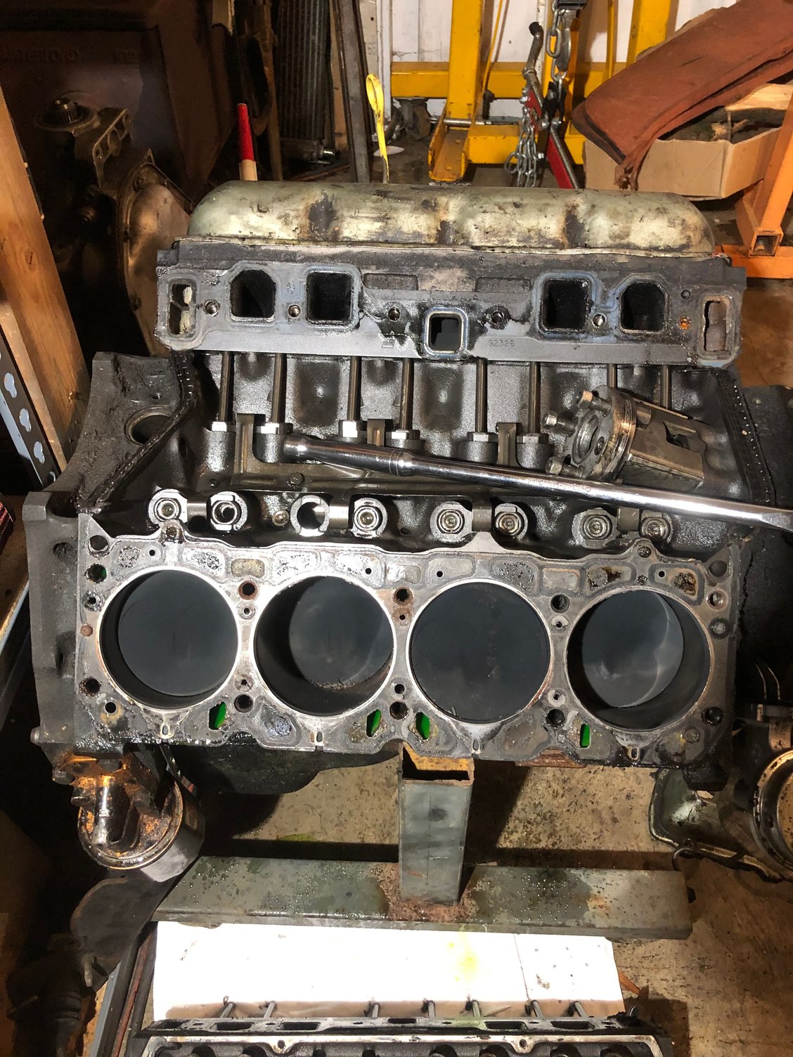

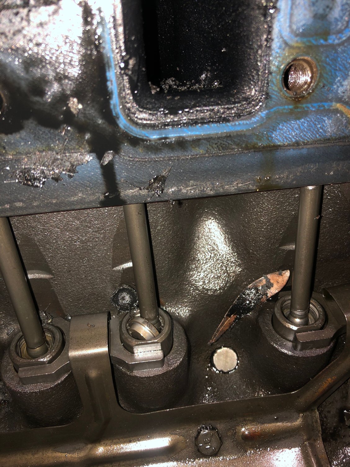

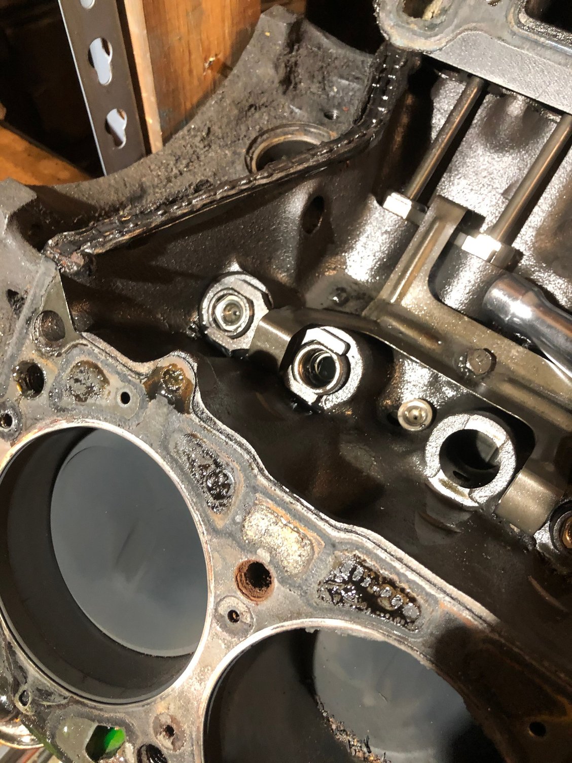

I pulled the heads and have not seen any obvious signs of a blown head gasket. I did find two failed lifters intake on cyl. 6 and exhaust on cyl. 8. The failed intake lifter on cyl. 6 could be the cause of excessive white smoke( Unburnt fuel caused by no incoming air intake?).
