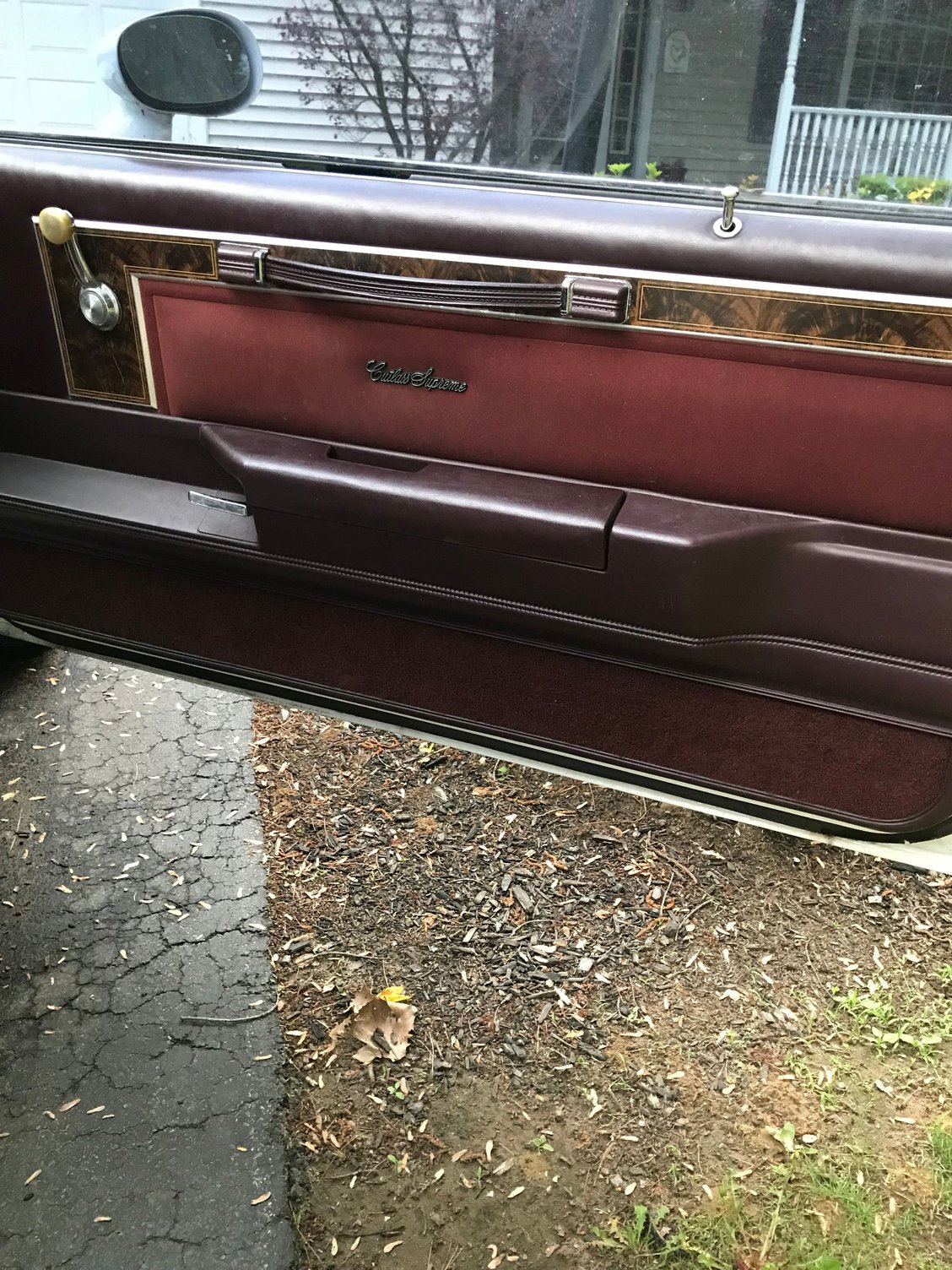

I've been working on this car pereparing it for the 455 transplant for a few days now so thought id start this thread if anyone was interested.we pulled the 307 and th200 over the weekend and ive been cleaning and painting in the engine bay .this cars body and frame are beautiful ! i just ordered a lares 972 quick ratio steering box that will work with my power steering pump with the flared hoses (1980 has the oring version )once that install is complete we will drop the 455 we built it in mated to a turbo 400 with 2500 stall converter.and in the coming months build a 3:08 posi for it .the interior wasn't so great from the florida sun ,but a friend over at the gbody forum hooked me up with all the panels i needed, which were very nice! ill try to post some pics as i progress.
