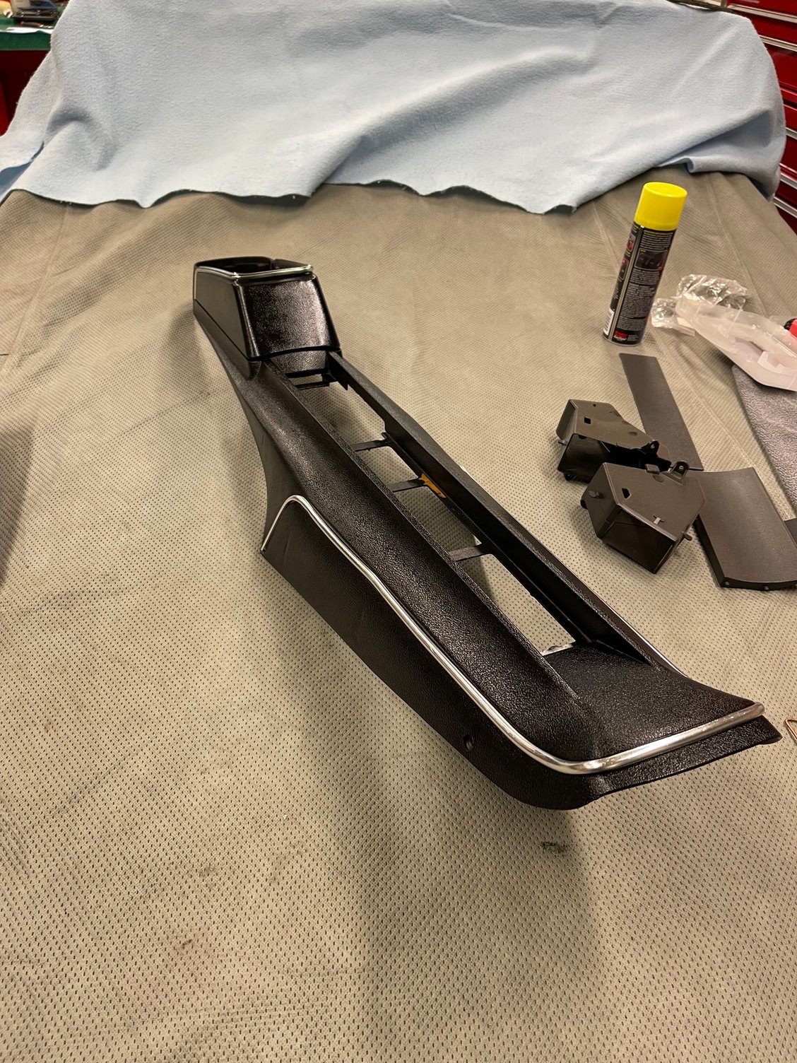

This weekends work. The drama between the machinist and my short block build of my SBO has concluded, thankfully. Bottom line he screwed up his quote and I had to pay. Not a choice I like but with the overage under $1K, an attorney is not motivated to help. Currently is sitting at a friends house and expect it in my shop next weekend. Been working on my Dual Gate console, it was in worse shape than I remembered but probably better than many. The bottom section had a broken rib near the rear light. I made up a couple of repair ribs and used Epoxy to set them. I will use some heated wire to embed into the plastic to strengthen those ribs. I have to do a repair on the bottom supports, I'll get into that shortly. I need to reflock the armrest interior, Inline Tube has a kit, I'll pick that up this week. Ordered a new Dual Gate top and the trim piece that sits inside the console as all the chrome was gone. This piece will look really sharp when done!

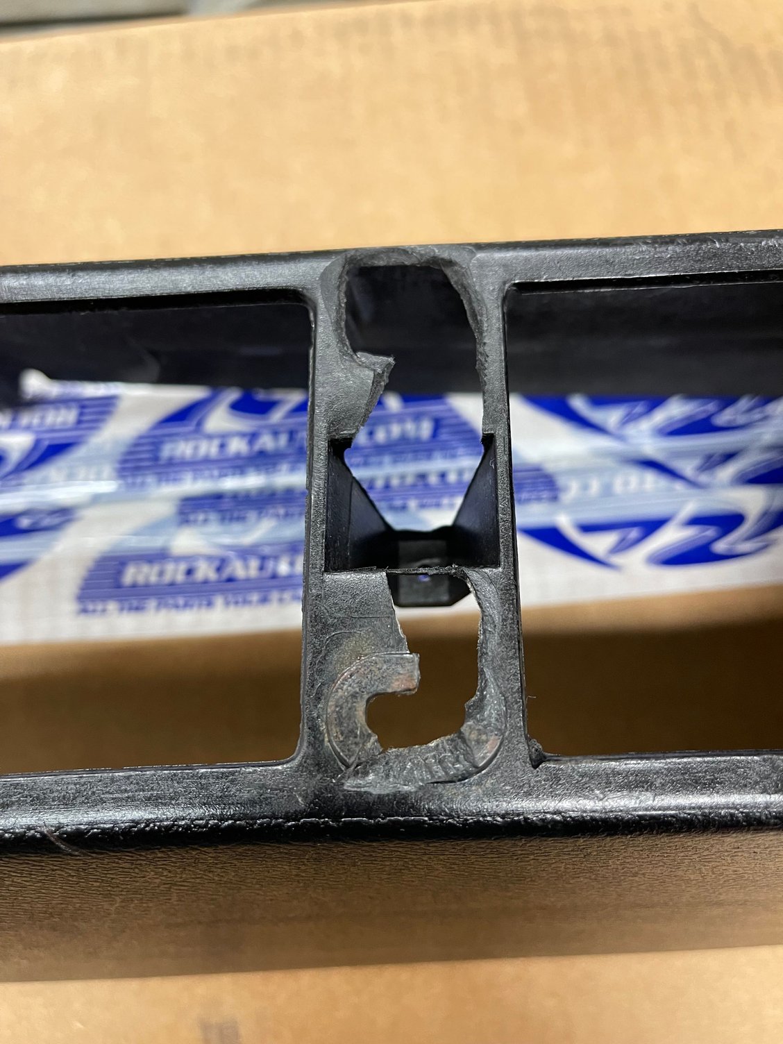

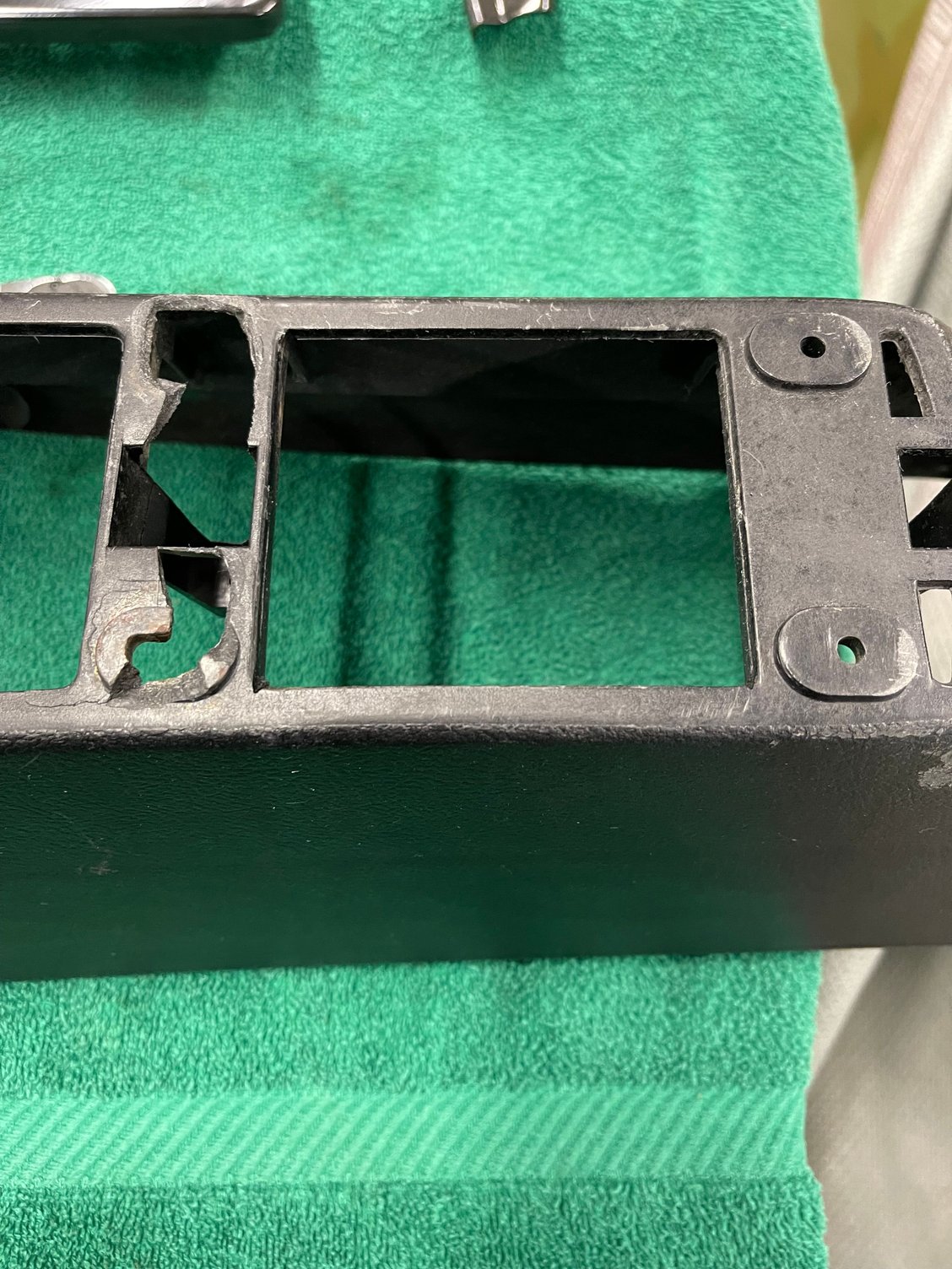

Broken Rib
Partial Rib repair will include new rib section and is currently epoxy'd in. Someone used too long of a fastener as you can see a witness mark of where the screw started to go into another screw pocket. The lamp lens require a short version of the 1/4" hex head fastener.
Top Rib broke due to warpage pushing the lens to the left most likely over time. Can see the lens is net to the fastener at the bottom and has roughly one extra thickness off at the top.
Broken support on the LH side that needs repair.

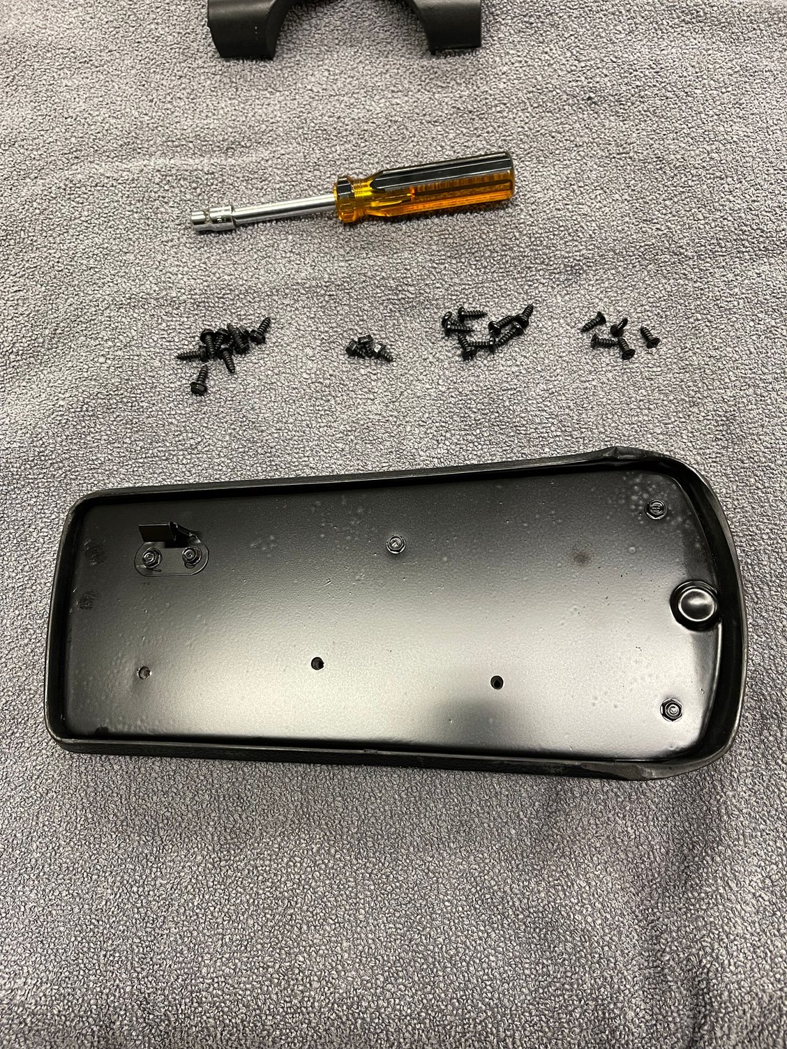

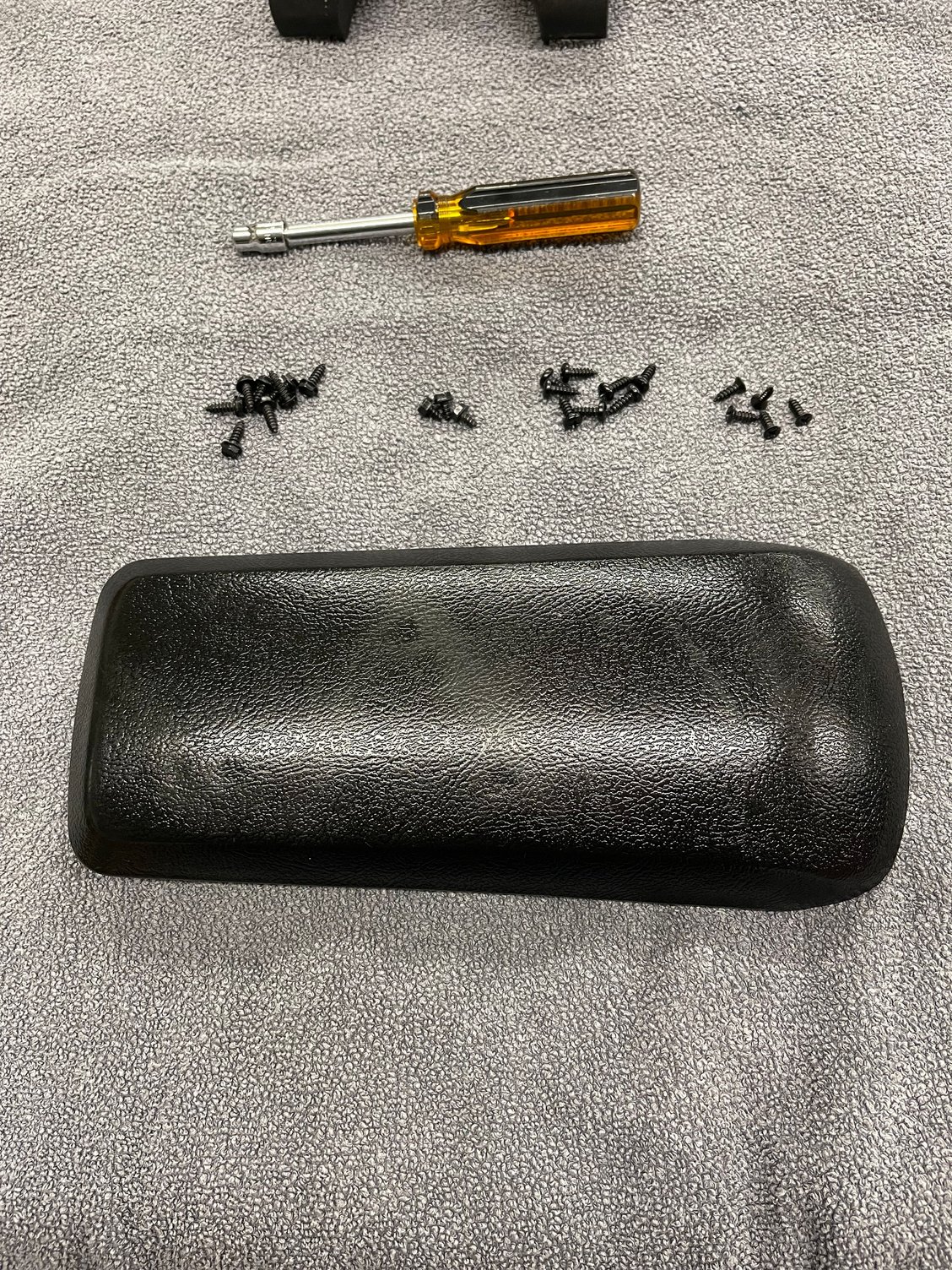

Armrest pad top cleaned with all the fasteners bead blasted, primed and painted in Black semi-gloss. Top given a coat of Trim Shine.
Armrest pad bottom with all the fasteners bead blasted, primed and painted in Black semi-gloss.
Console top cleaned and given a coat of Trim Shine.

Very nice work my friend these consoles get so brittle

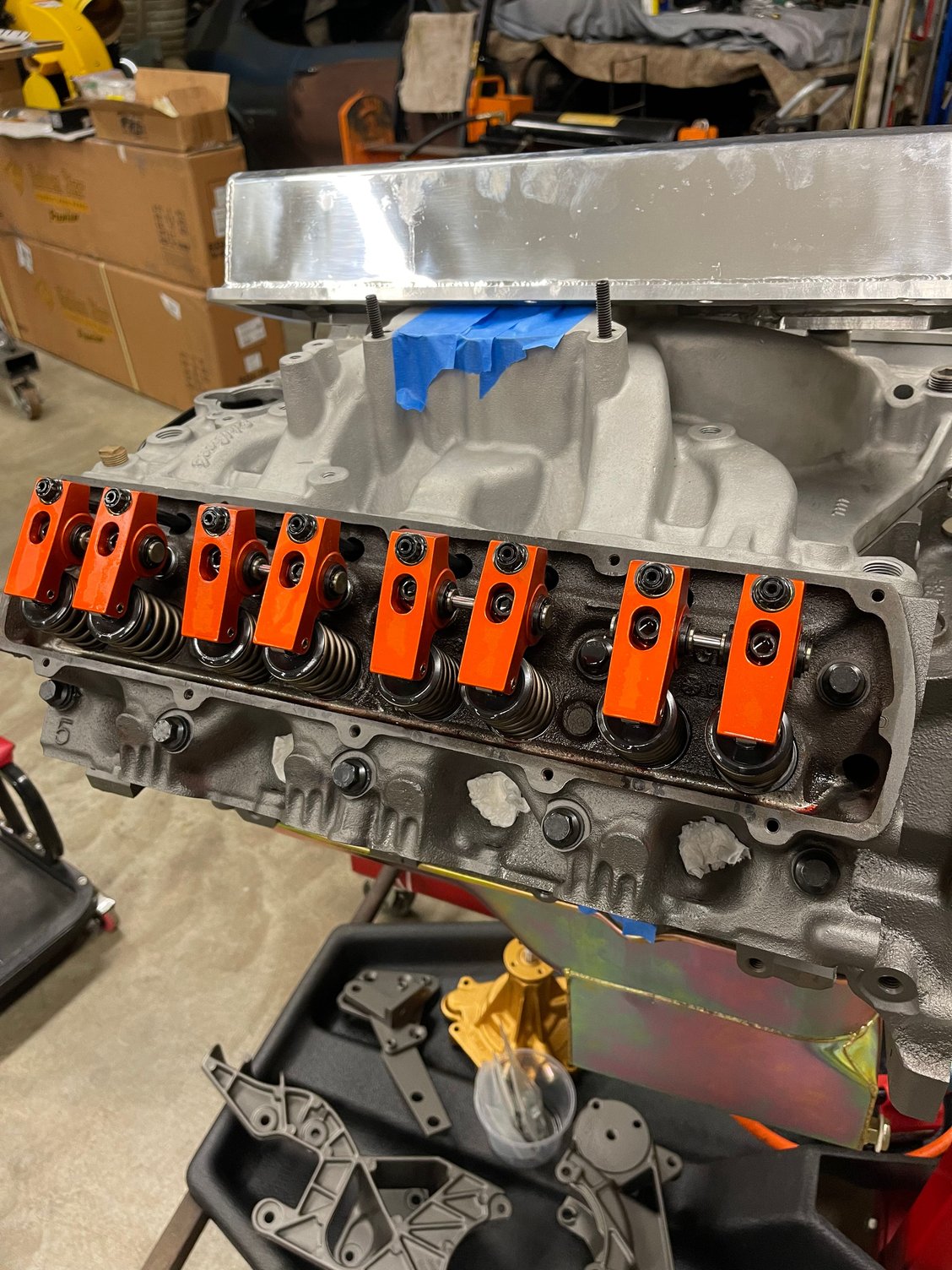

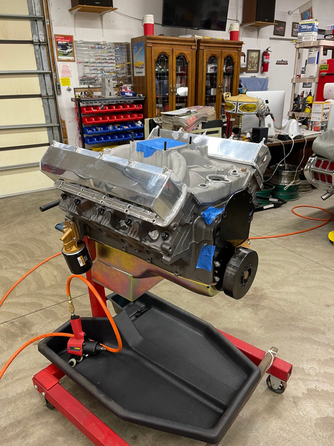

We have an engine in the shop! Finally!!! Got plenty of work to do on it including some proper paint.
355 cid SBO.
The basic rundown on Specs:355 cid Oldsmobile, 1972 Block.
Ported #5 iron heads (1968/69 vintage), heat riser blocked (used melted down low compression Olds cast pistons).
Harland Sharp Roller Rockers, 1.6 ratio
Edelbrock Performer RPM intake, gasket matched to heads.
Nodular Crank with Halo girdle and oil scraper.
TRW Flat Top Forged pistons 10.3 CR with a 64 cc head
Hydraulic Roller Cam/Hydraulic Roller Lifters
Balanced reciprocating assembly.
Fluidamper Harmonic Dampener
New ARP fasteners everywhere.
Will be using a Holley Sniper fuel injection set up.
American Racing Headers (1 ¾” tubes), Jet Hot ceramic coated.
Old Apr 1, 2022 | 02:00 PM

Looks great ! Looks like you have a deep oil pan as well? Did I miss that in the write up?

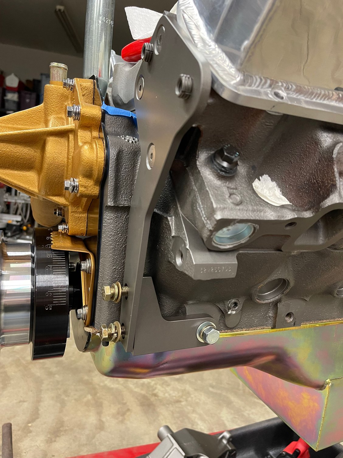

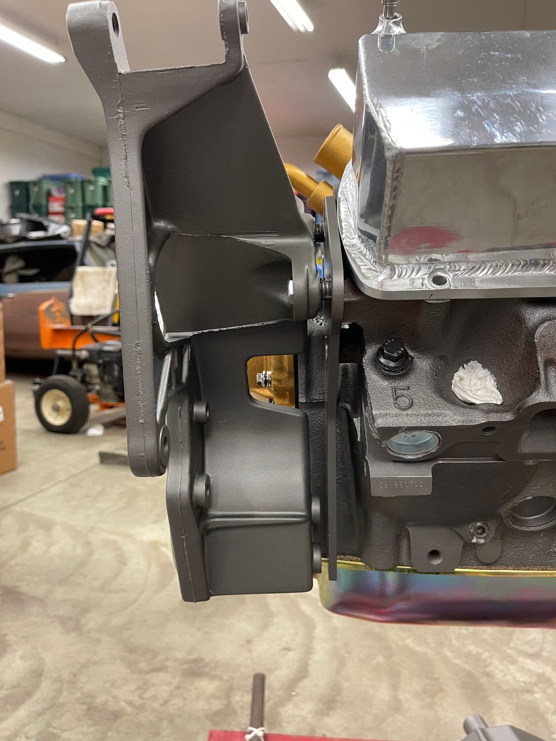

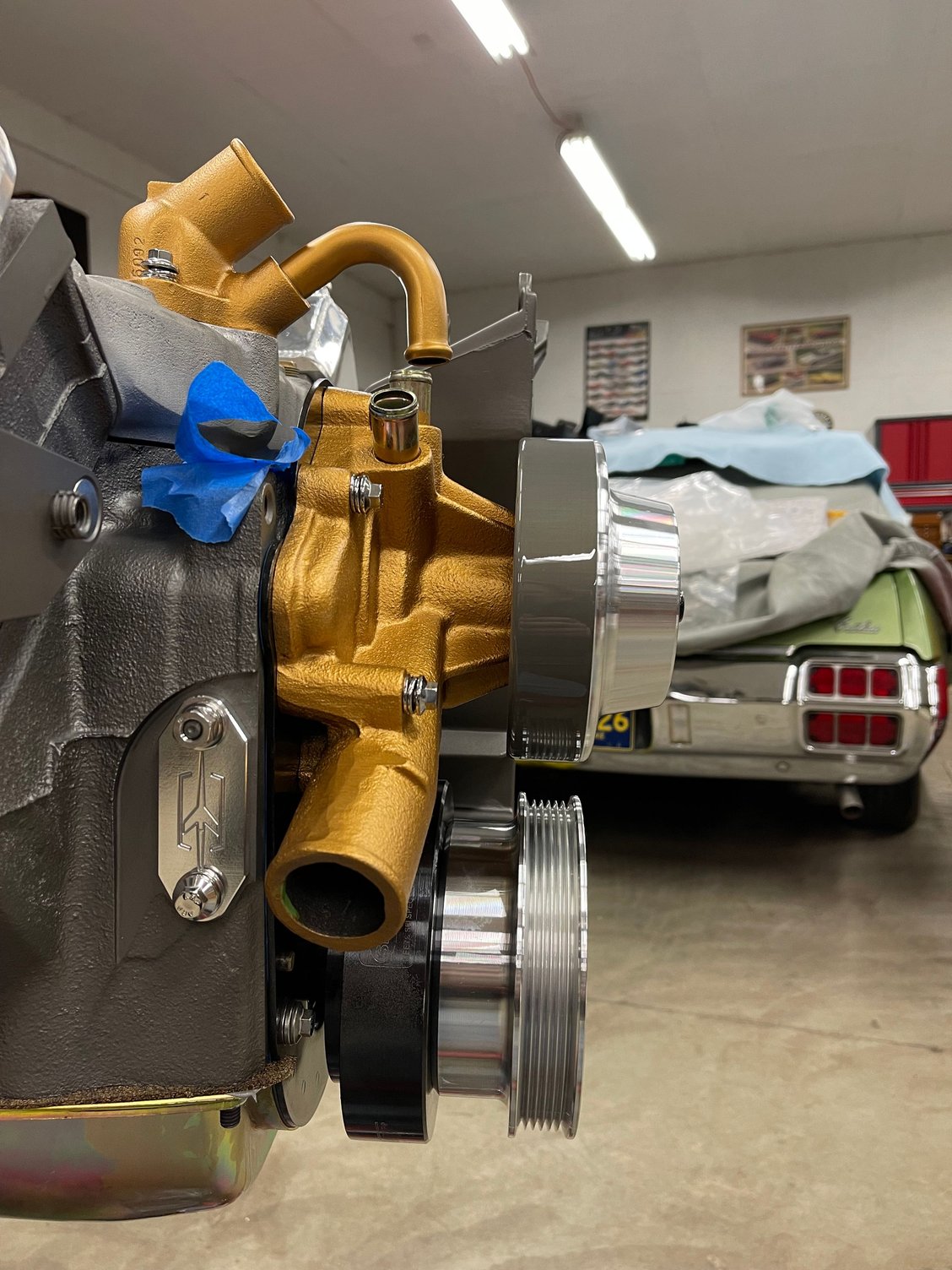

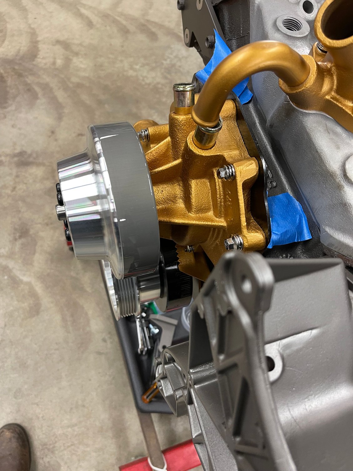

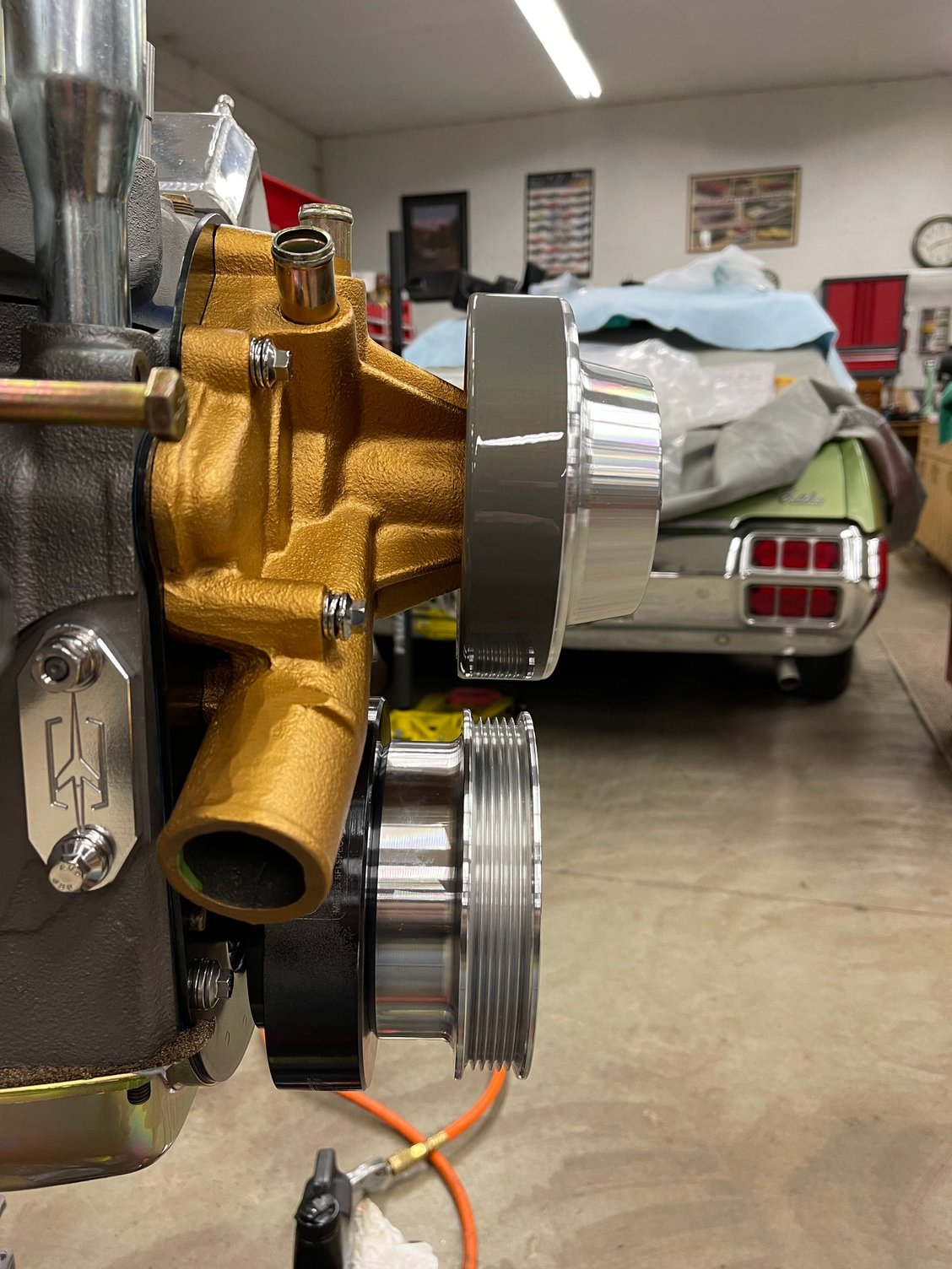

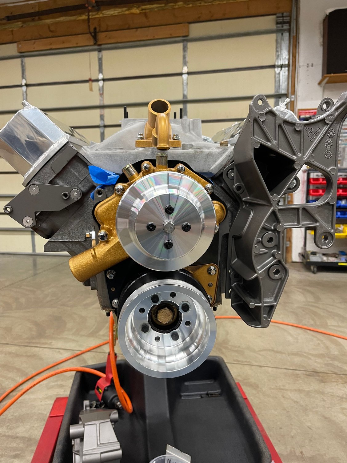

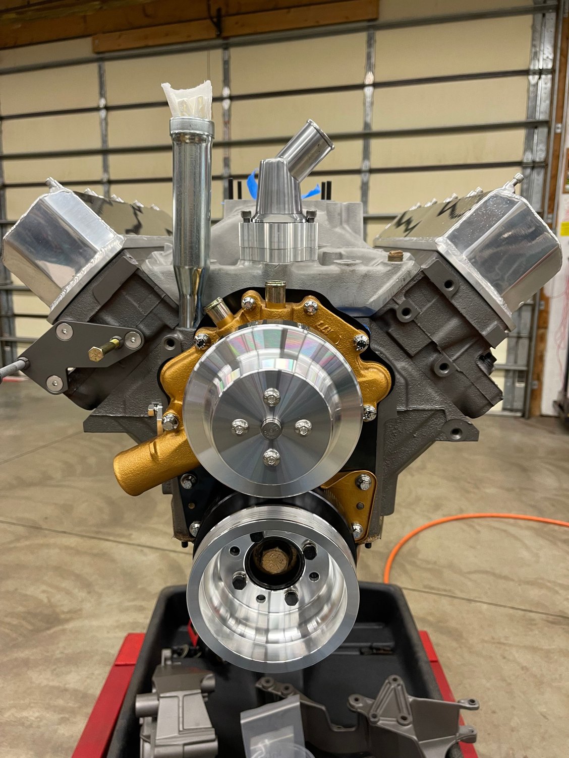

Doing my mock up for the serpentine system and general fitting of many parts.
Pulled the covers to show the Harland Sharpe Roller Rockers.
Got a few parts on during the mock-up.
Temp cover not lining up, I have the other style that uses the curved hose. Have to try it... I have another used tube style, will need to measure it if it would fit better.
Water Pump pulley is sitting a little bit rearward, I think I'll use some shims so it lines up with the crank pulley.
The bracket is netting against the insert. I think I will either enlarge the hole to 9/16's or do a counter bore. I think the counter bore is a little more difficult but will be a better solution.
It isn't going to be fun timing the engine, not a lot of room to read it! I want to highlight the numbers and lines on the pointer to make it easier to see when timing.

I used a couple of flat washers behind the water pump pulley. The water pump gasket will pull it forward a little more. One washer will be enough for proper centering. Used another style of temp cover in the pic below, not really liking that design for what I'm doing with the car. I'm thinking the non tube version with the pre bent hose will work best here. The one the I have on the shelf has seen a few too many miles and has a bit more corrosion and pits in the aluminum than I care for. Used a button head fastener on the water pump pulley, gives a nice clean look. I'm using electric fans so it will not be having a clutch fan on the end of it. I can either anodize the snout sticking through black, give it a little bit of color with some Olds Gold or just give it a little wipe of oil every once in a while. I think the wipe of oil is best for now, I have to wipe the Fluidamper down with some oil anyway to keep flash rust away

Wondered where this small L bracket went, it was a brace for the driver side bracket.

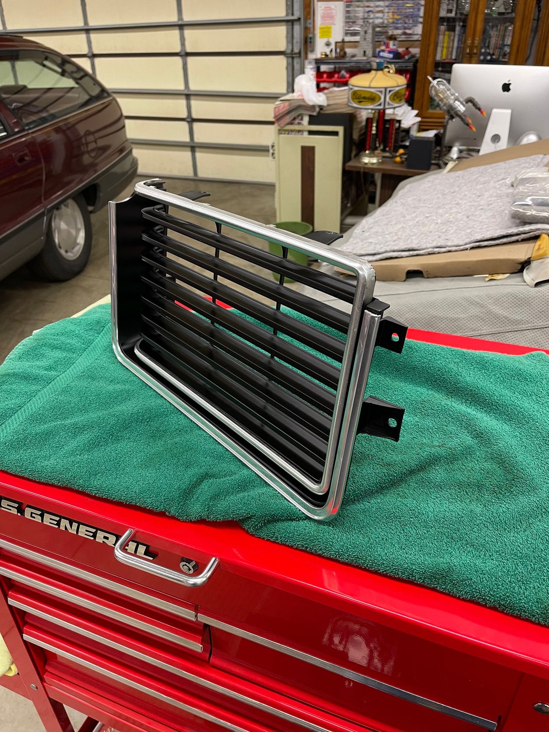

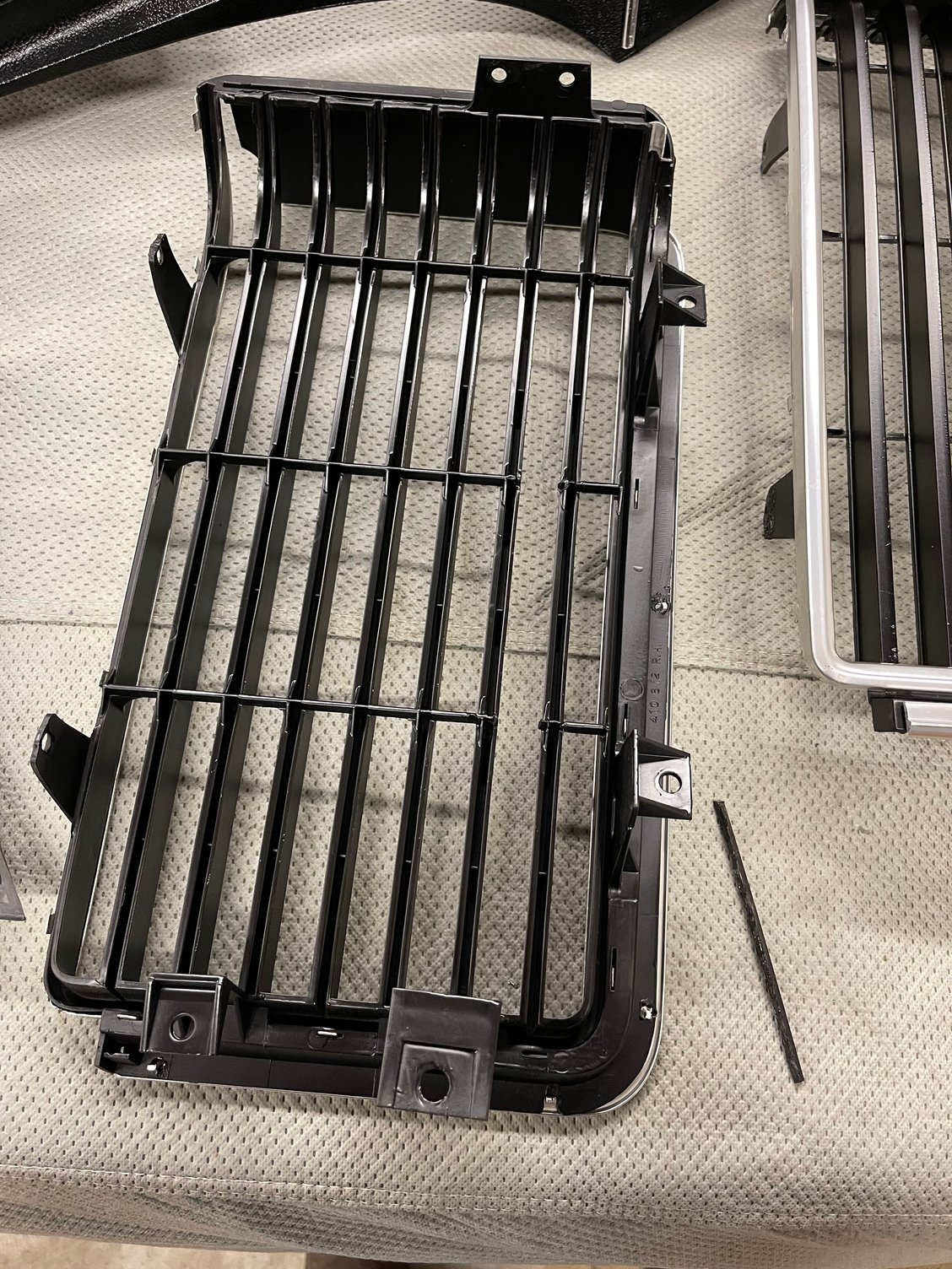

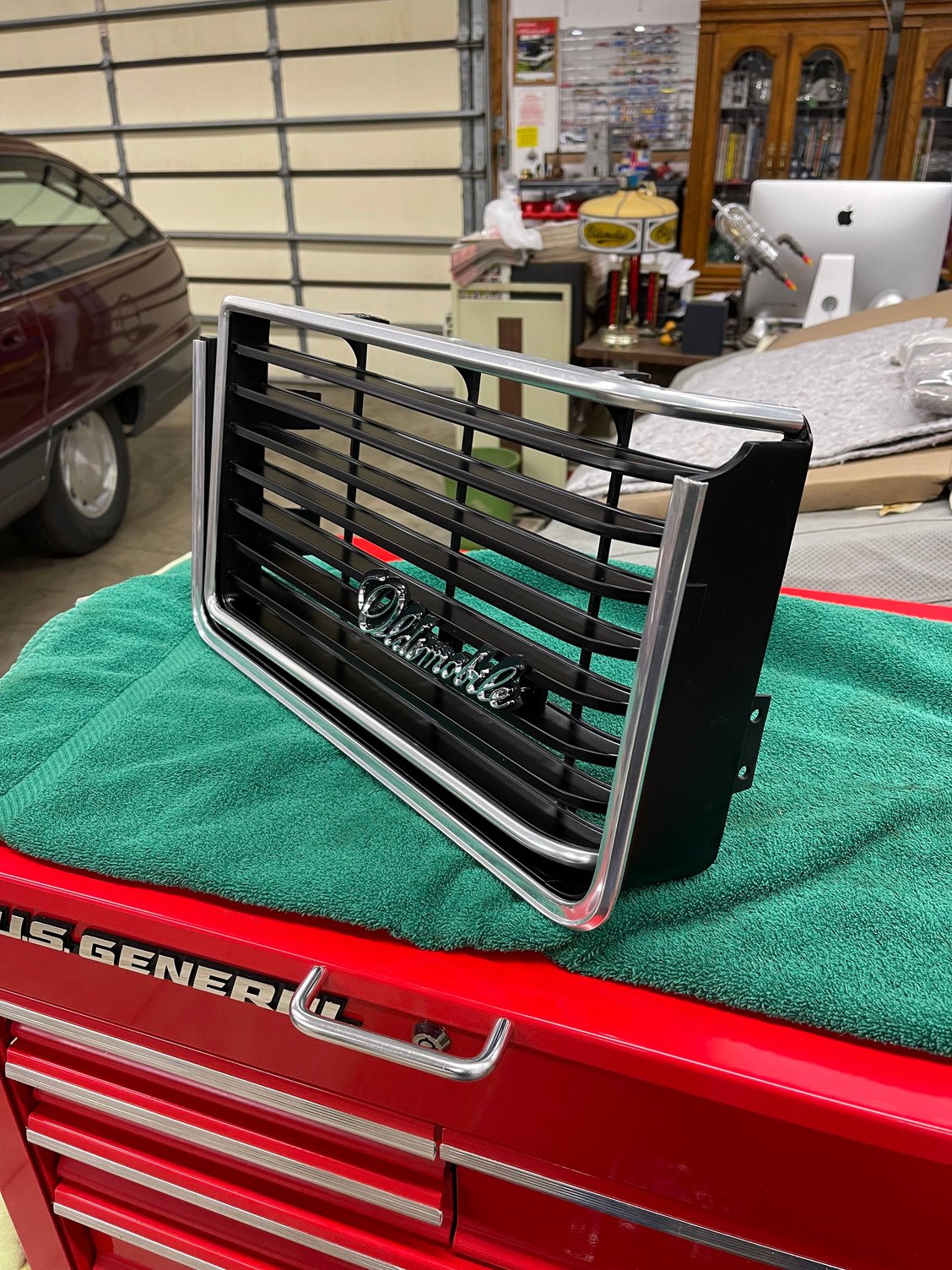

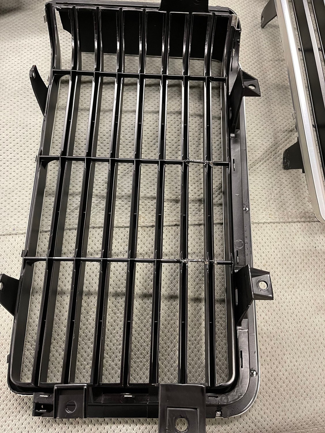

Did some work on my grilles. Had some ribs broken on the passenger side grille.
I repaired the ribs. Got the drivers side pretty much done.
Driver Side, still waiting for the emblem to come in.
Pass side without ribs.
Pass side with repaired ribs.

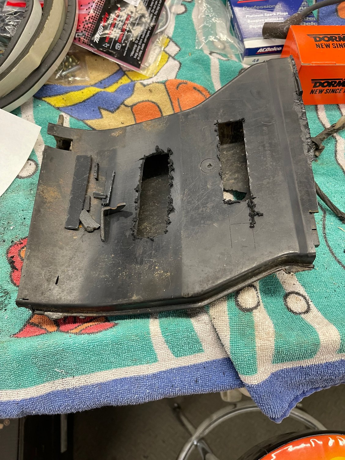

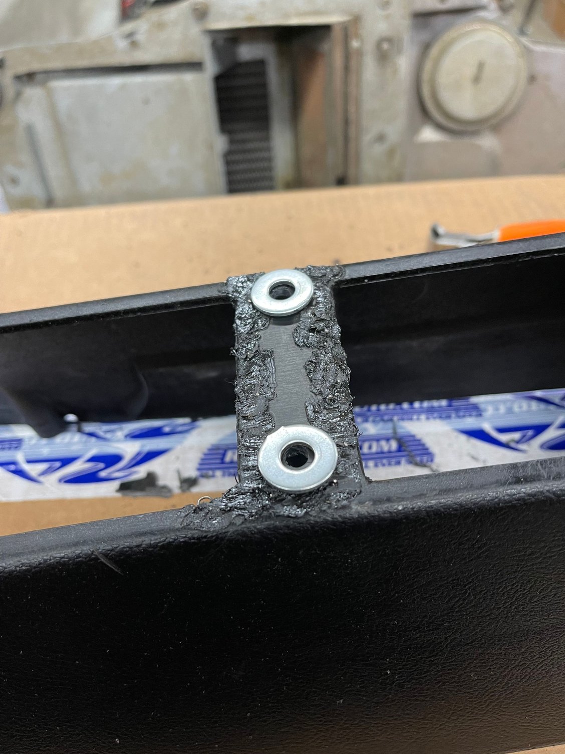

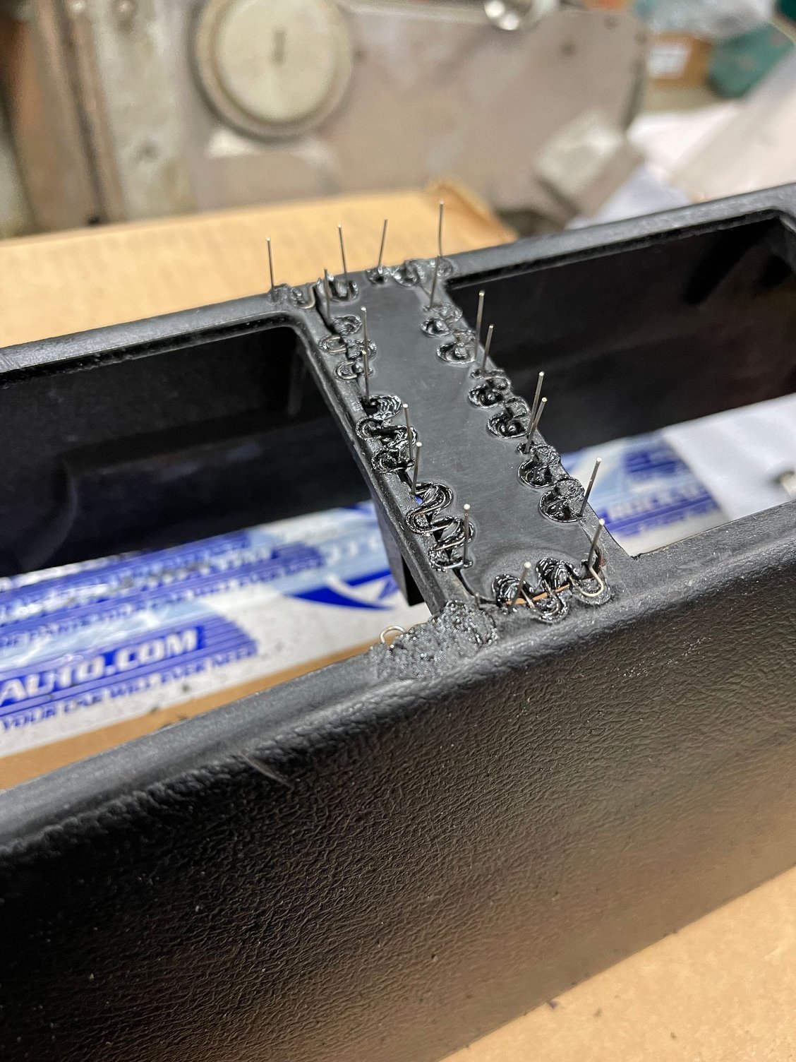

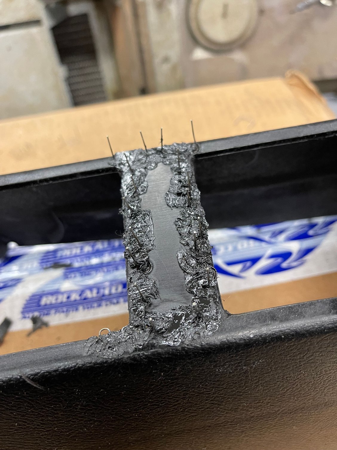

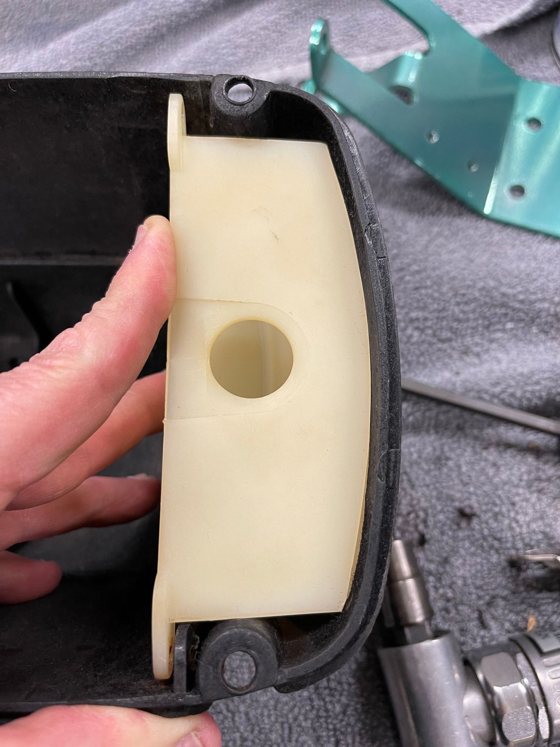

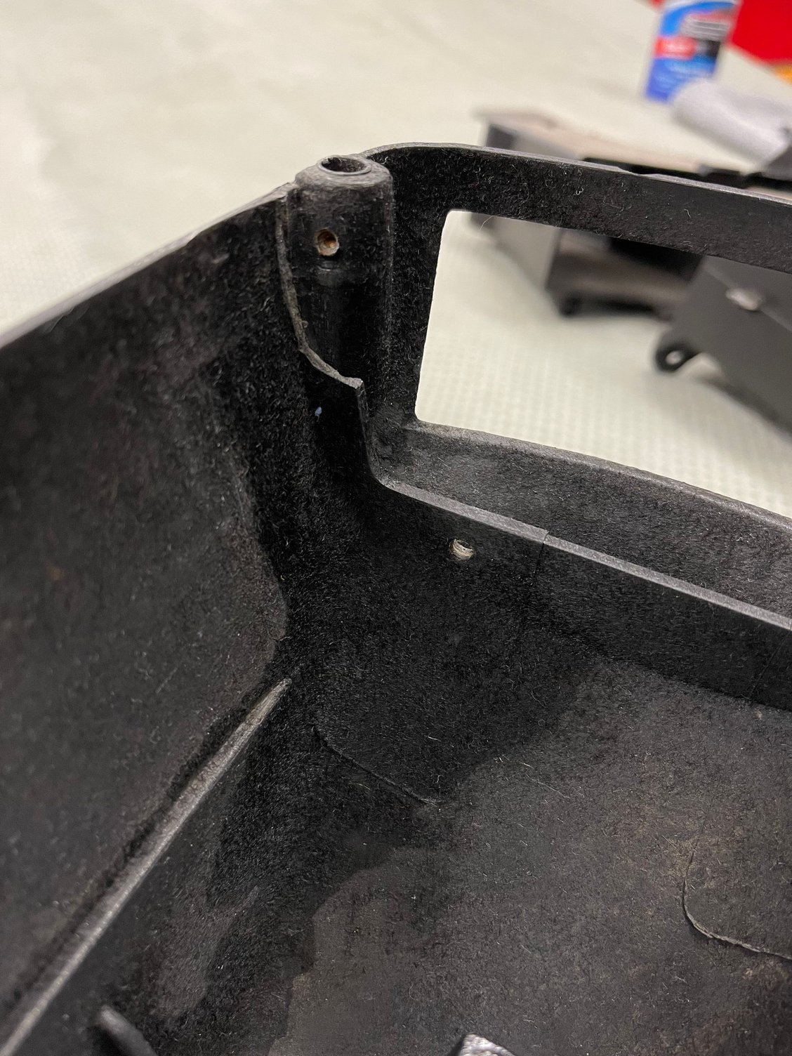

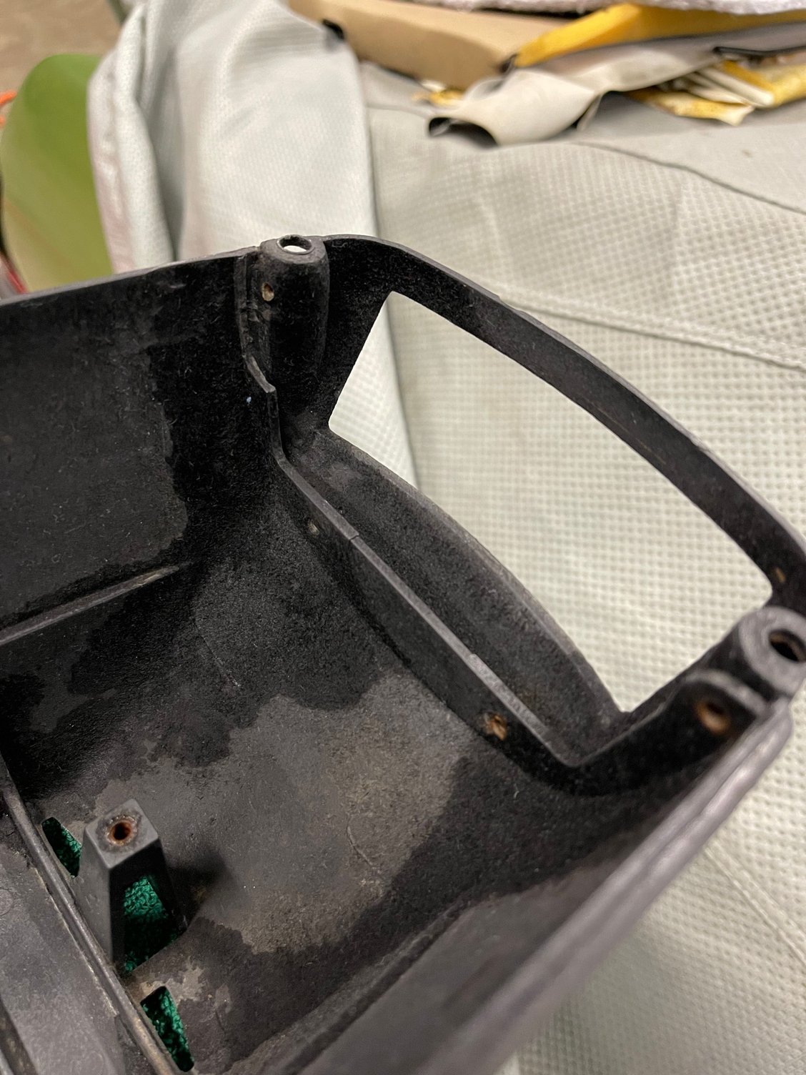

Got into the console to repair the resting pad. Not pretty but solid.
What I started with:
I then trimmed out the broken area. One wall was broken in the bottom LH corner. Added one reinforcement there:
Trimmed up a piece and fit it to the hole and melted in several reinforcement wires:
I took some material, made some "sticks with them. I melted them into the base material, inside and out:
Lastly, trimmed off the ends of the wires. I figured I can use washers to the 0.100" of thickness that was there. I have metal washers shown but I have some thicker plastic ones I think would be better.
When it comes time to install, I'll use my dremel to slot the drilled holes I created. I'll drill a clearance hole in the center for screwdriver access later, the flocked bottom the glove box ties into a dog house feature there.
Glad I tore it down as there will several areas that required repair. Still waiting for parts to show up, hopefully coming soon.

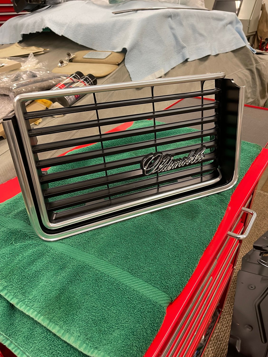

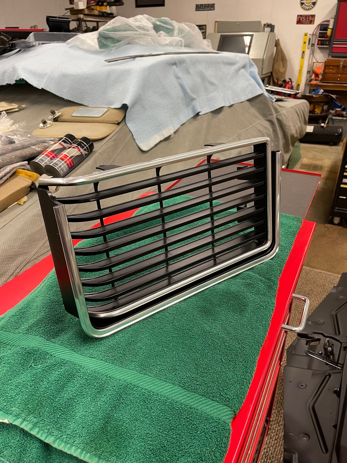

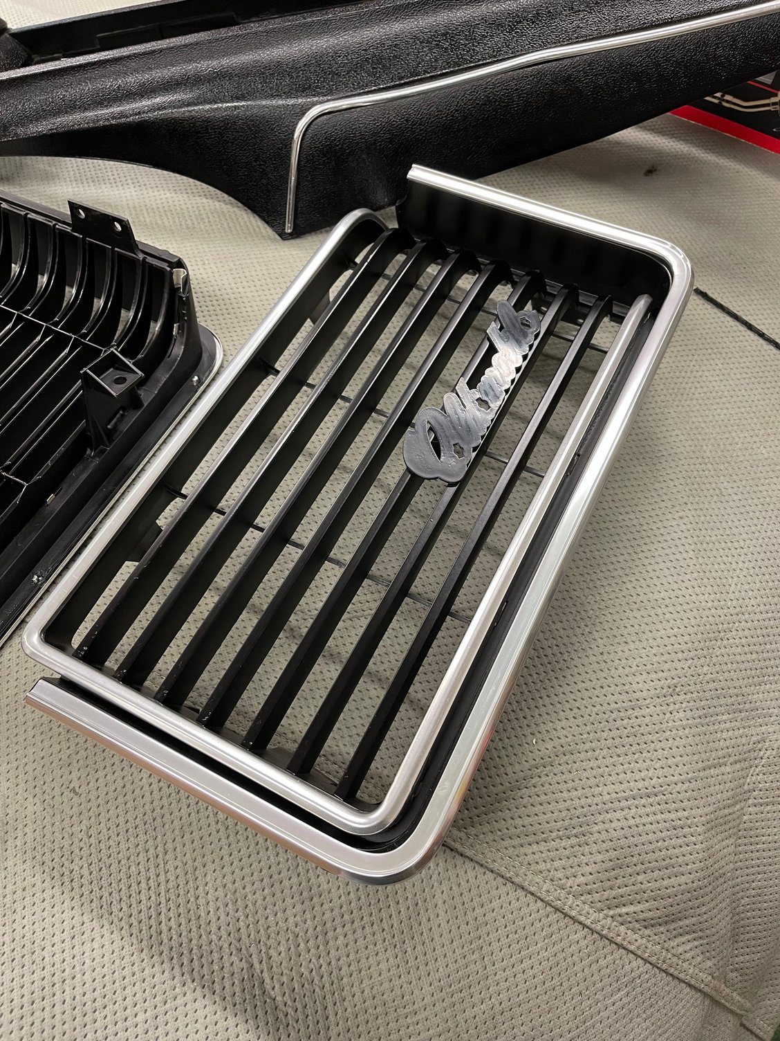

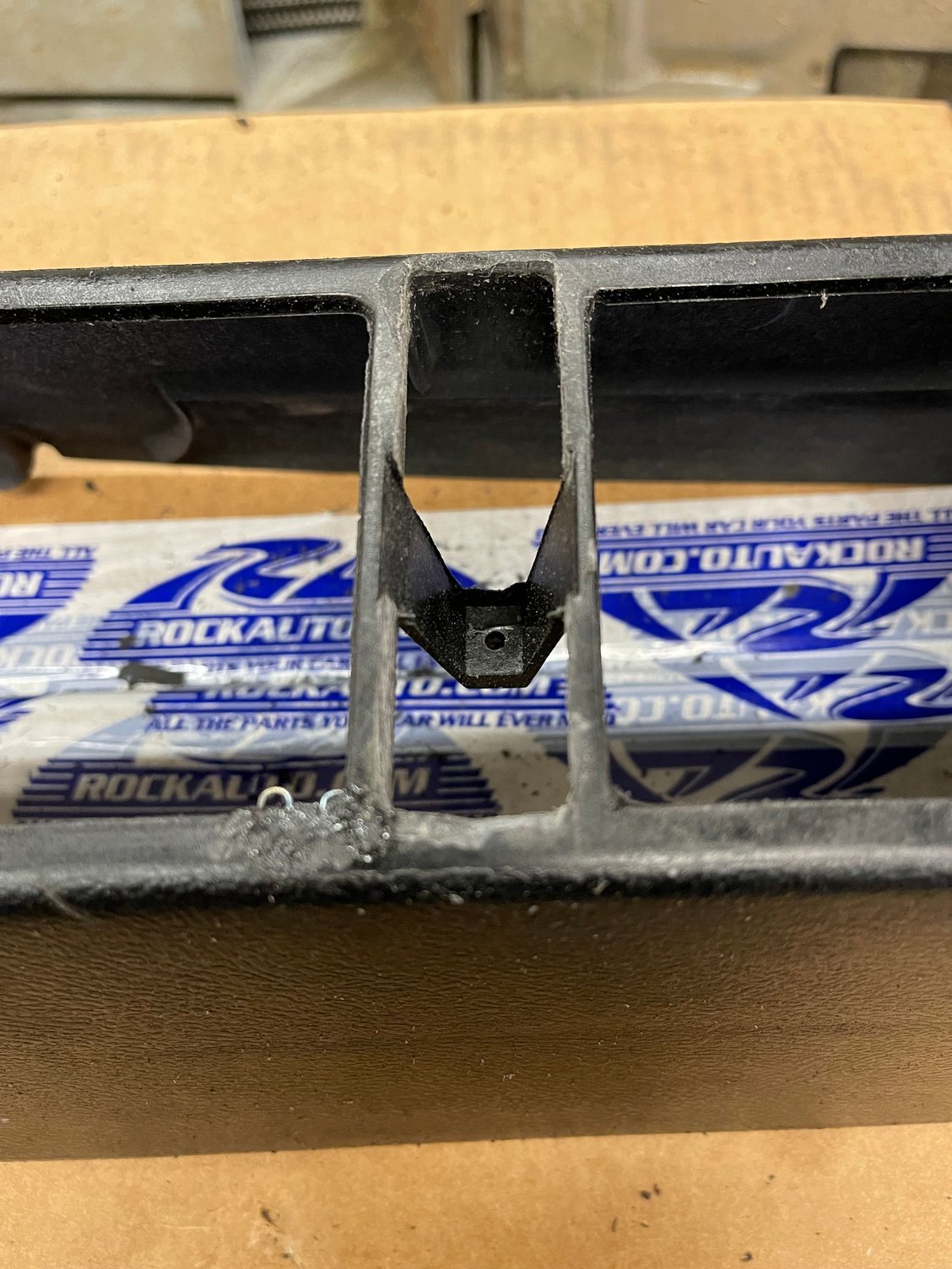

Grilles are ready. After breaking the first Oldsmobile emblem, the second one was delivered yesterday. Kudo's to OPGI for replacing free of charge!!!
The root cause to the breakage was that the studs are not the same size.
Two of the studs are smaller diameter and the PAL nuts fit those well.
The one stud is larger but the PAL nut is sized for the smaller stud. I used one size larger PAL nut for that stud and it fit perfectly.
The smaller PAL nut caused too much torque to the stud causing it to rotate and breaking the casting.
These grilles are going to look great once the front end is put together!
LH
LH
RH
RH

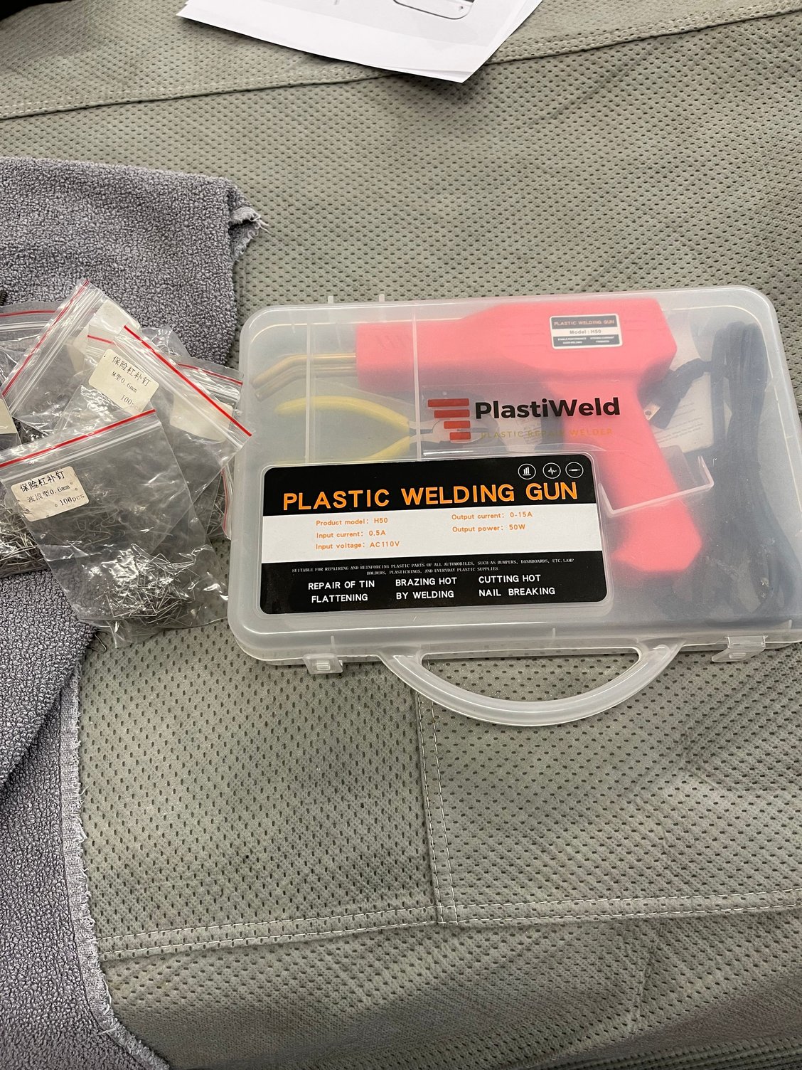

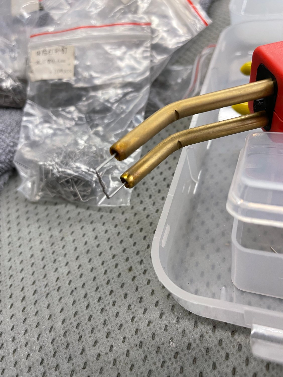

I have some broken AC duct work which is made of ABS plastic.
I used a sharp razor and heated it with a small torch. It goes through plastic like butter.
I cut some long sticks of the material and used a soldering iron and filled similar to TIG welding.
The console is made of the same plastic material.
The plastic welder I got off Amazon, it is a basic unit.
Eastwood sells one too, I hear it has more adjustability.
The wire forms fit inside the gun and the wire heats up like the filament in an incandescent bulb.
You then sink the heated wire into the plastic, let off the trigger and hold it several seconds while it cools.

Thanks for sharing! I've got to get me one of those plastic welder guns; so cool.

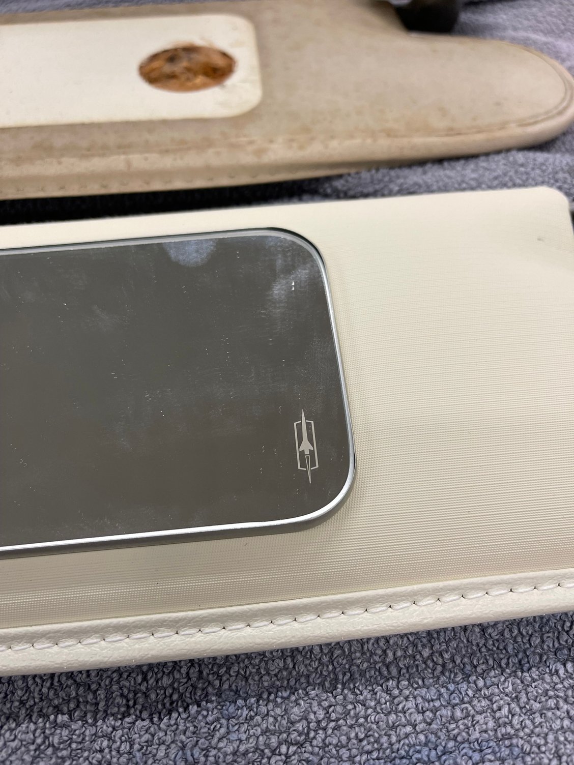

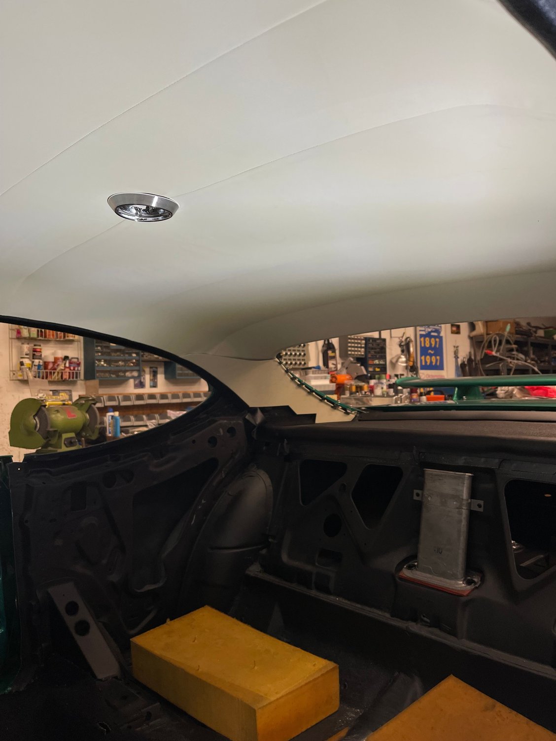

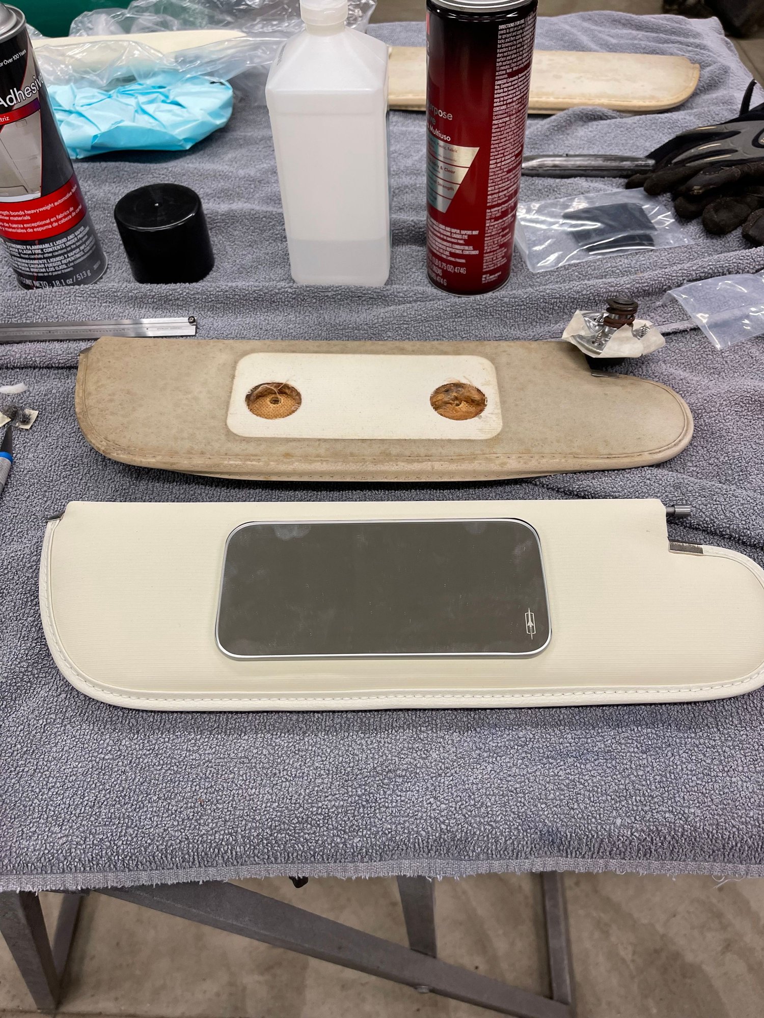

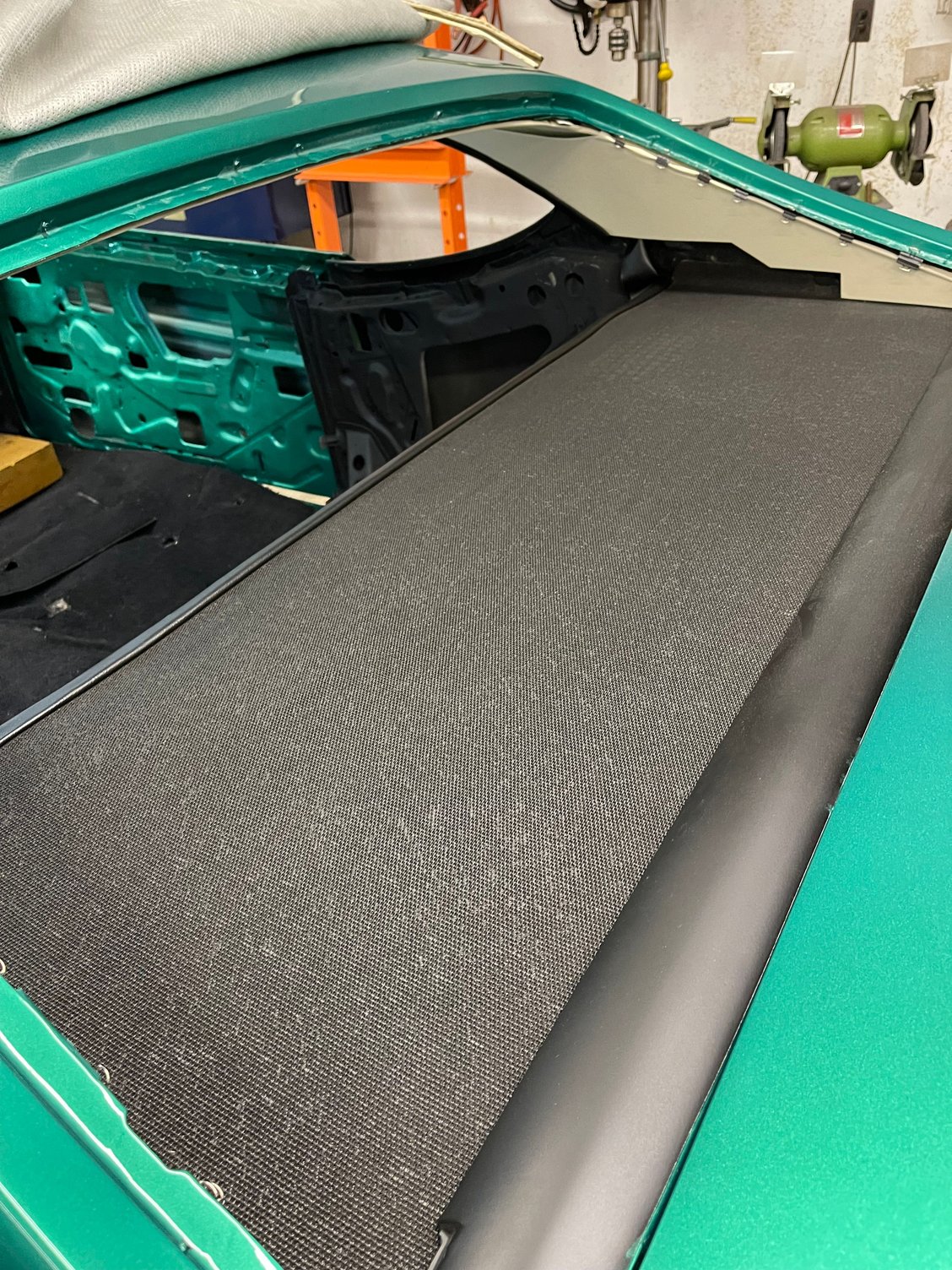

Headliner, Sail Panels and Package Tray are all in. Did a mod to the Pass Visor to add the custom mirror. A little something for my girl...
