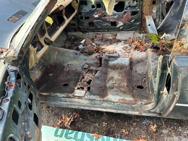

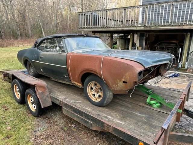

I just picked up this 69 Convertible that I will be repairing. I think most people would have used this car for parts and scraped the rest but I guess I have hit my head one too many times along the way. I called it repairing because I do not plan to "restore" it to factory new but make it a nice driver.
The frame is broken so that will need to be replaced, the floors and trunk are also shot. Strangely enough the rockers, most of the rear quarters and the front fenders besides a few inches at the bottom is good, the drivers door is trashed and the passengers might be salvageable. It's green with a gold interior or at least it was. I am not sure why someone would pick that color combination, but to each their own. It was originally a bucket/console car which are now long gone along with most of the interior. It does have power windows but no idea if they work or not. The engine is a 350 2-bbl with an auto. It looks to be the original engine but I have not run the numbers yet. Lastly, the nose is just sitting on the car as the previous owner had started to sand them down and the hood hinges are in the trunk or box of parts I got with it.
This is the 5th cutlass I have owned throughout the years and 4 of those was A-bodies and the last was an 86 442. I have had a 69 convertible, 72 supreme and a 71 hardtop.
If anyone has a repairable frame that is somewhat close by let me know.
It will be a while before I can start this project as I need to sell another project car first. I'll update as things progress

Good luck! That's a hell of a project.
FWIW the rockers are galvanized steel and that's why that aren't rusted

Thank you, that makes sense to me. I haven't decided if I will go with full floors with the inner rocker piece or not. I'll probably also look for a 1-piece trunk.
Like anything, one step at a time.

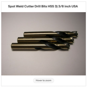

I had great luck with these cutter bits from Blair

Do you think this kit would last the 300-400 spot welds that need to be removed for the floors? I'll also need to remove more for the trunk and rear quarters.
I am still using the first cutter bit in that kit after several hundred spot welds, the trick was to use as slow a drill speed as possible with a well-lubricated bit.
I just kept the tube nearby and would coat the cutter tip for each weld.
